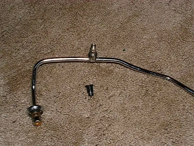

here is a pic of what you are looking for. if you still can't find the schrader valve, the only way to check pressure would be to buy a regulator that has a 1/8 port built onto the side of it. I know the accufab, BBK, and maybe the mallory one do have this port.

swivelpants - it's there - look down under/behind the alternator.
