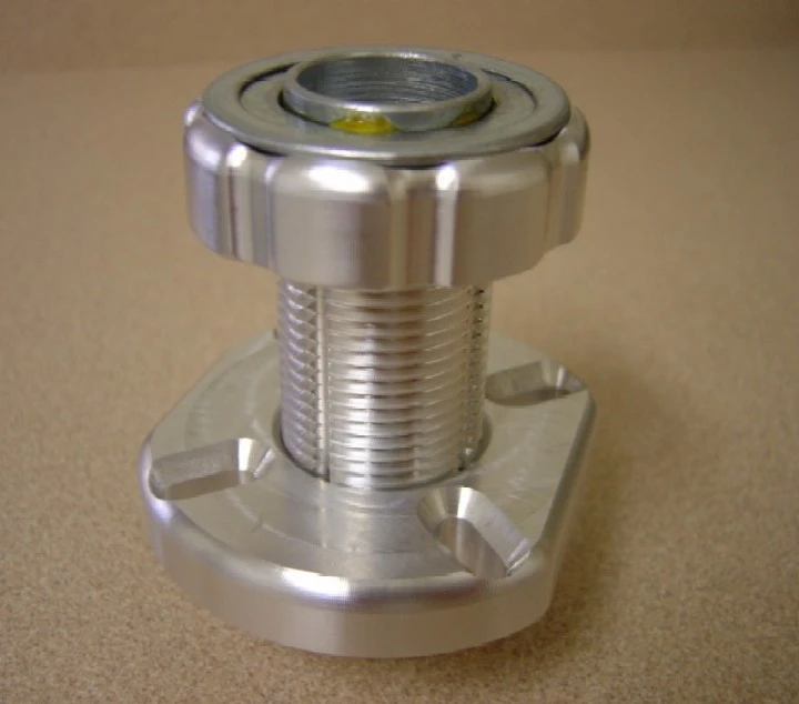

Did it look like the attached picture?
This is the Gen 2 design. It has a revised thumb-grip so it will fit newer Cobras with ease.
It also has 4 slotted mounting holes instead of the 3 screw holes found on the 1st Gen adjuster.
Sorry for all your problems but I'll do what I can to get you the proper set-up.
Joe
