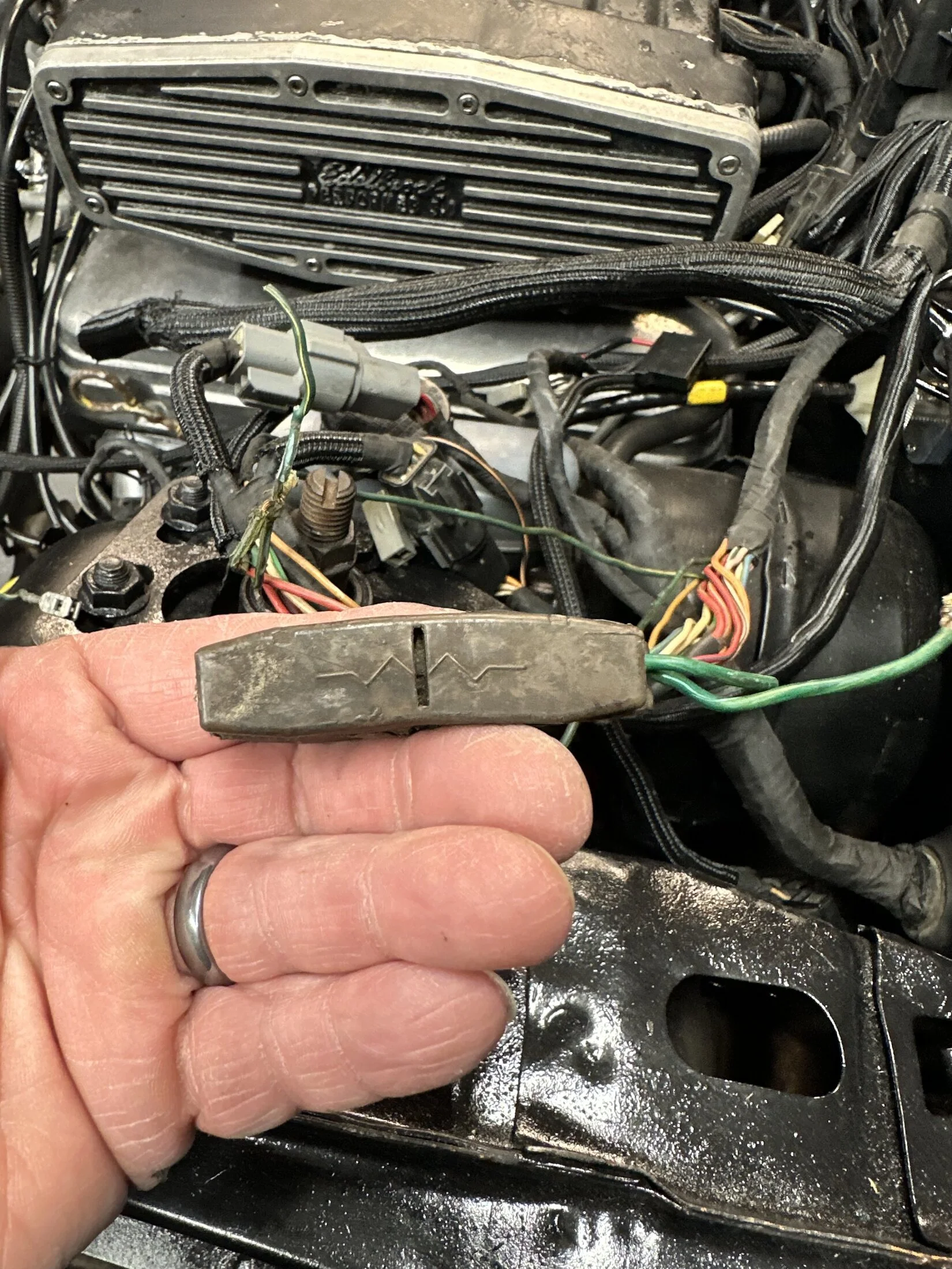

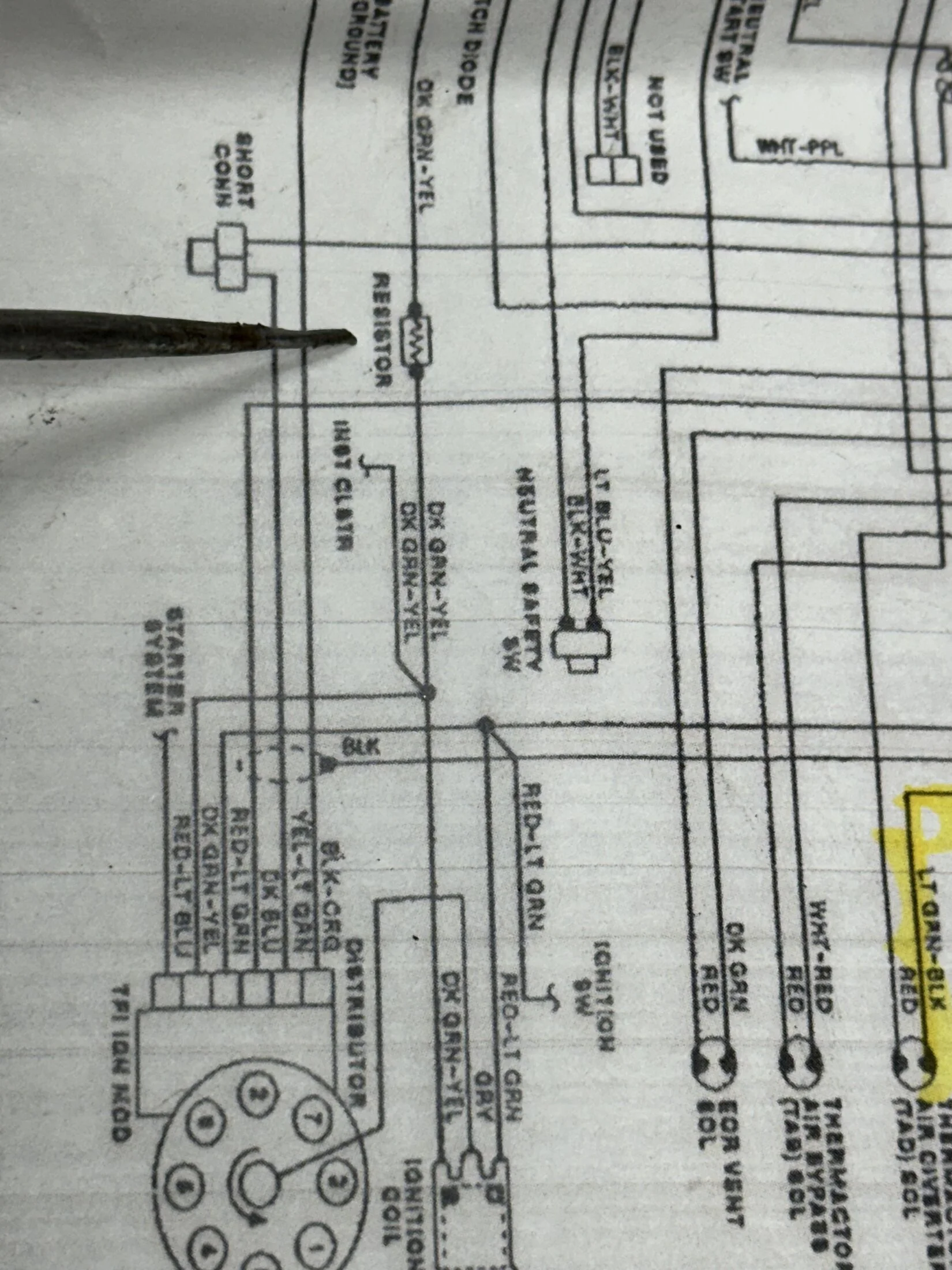

Pin #4 is dark green/ yellow wire that shows a 22 Kohm resistor on it (ignition coil ballast maybe?) after the resistor that wire splits and goes to ignition coil, tfi module, and back to the dash cluster.
I can't get any continuity through resistor. I think it maybe bad. If it was bad could that be the cause of my no spark?
On wiring schematic it shows its a 22 Kohm resistor. The aftermarket ignition coil ballast I see for sale at auto parts stores don't show that same 22 Kohm, so I'm not sure about how to go about replacing that.

Pictures below of resistor and schematic showing it.

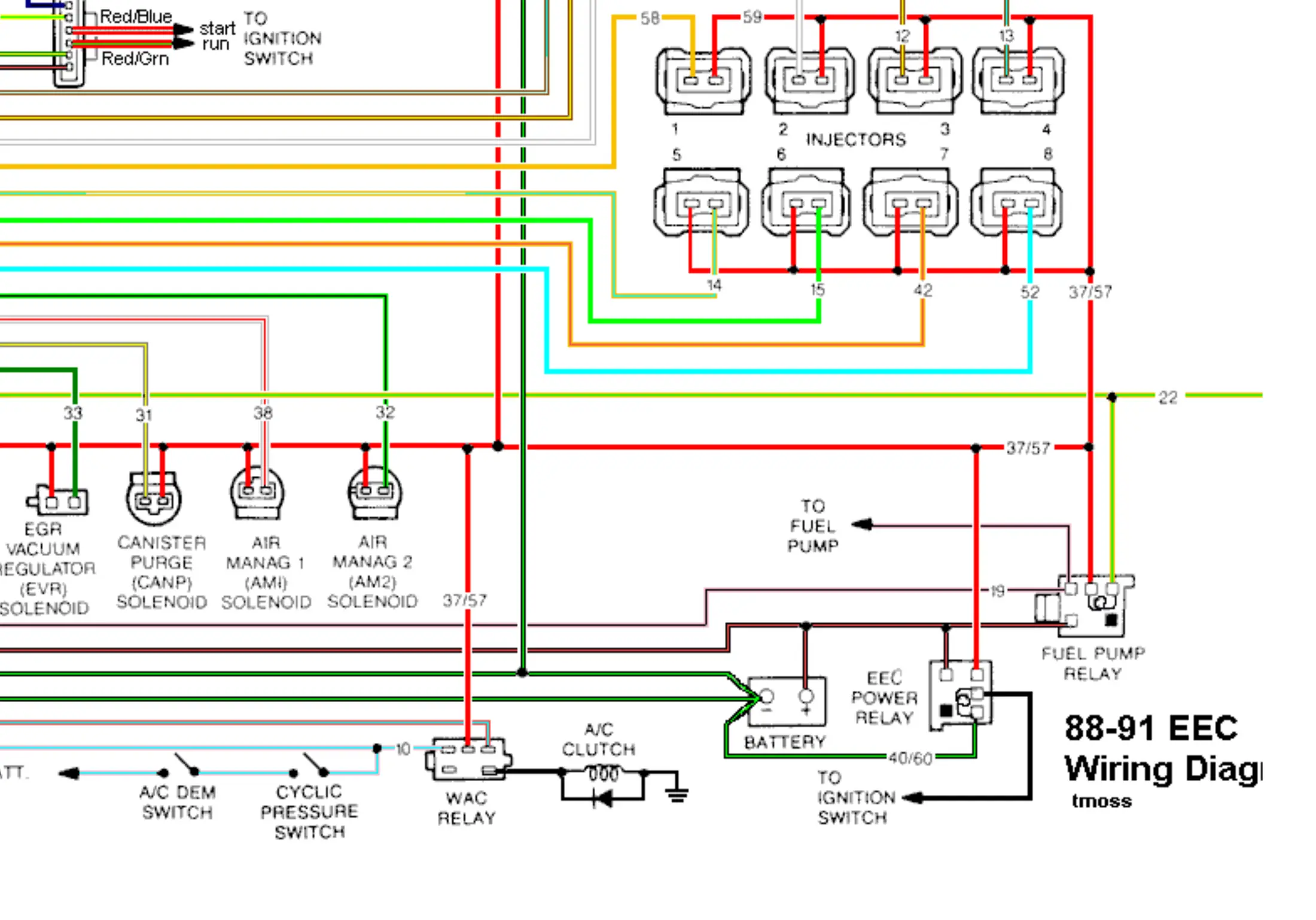

If you have voltage at the relay when the key is in the Run position, but the fuel pump doesn’t prime, that prime function is triggered by the ECU. If you can, check the voltage at the Red/Blk wire at the relay with the key in the Run position. You should get 12v. If you do, then the ECU is suppose to act as the ground, activating the relay. There could be several areas to check. But grounds are always culprits.

So, looking at this schematic, when you turn the key to Run, you should have 12v at the red wire at both sides of the inertia switch, and at the FPR. I say 12v, as measured with your VOM grounded to a know good ground. If not, check that same red wire at the EEC power relay to see if you have 12v there. Let us know what you find.
The EEC relay and fuel pump relay both get power on the contact side from the battery via a fusible link. When you turn the key to run 12V+ should go to the coil side of the EEC power relay which then provides power to the coil side of the fuel pump relay. The EEC then provides a ground to the coil side of the fuel pump relay which then closes the coil and provides 12V+ to the inertia switch. If the inertia switch is closed the 12V+ then goes to the fuel pump.

BIG BREAK!!! Me and a buddy went wild with testers and probes. we realized #1 pin on ECC was getting no power. chased the black wire with orange strip down through the harness. Somehow I had grouped that wire in with the black and green grounds. My computer hot wire was attached as a ground. Once I straightened that out the fuel pump started working, and I started getting spark. The car actually coughed a couple times. Tonight me and my boys are gonna go through checking timing. I'm so excited I don't wanna go to work today. LOL just wanna stay home and hear this thing run.
