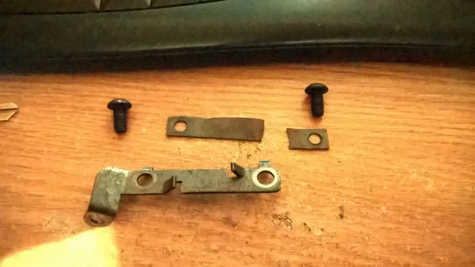

Thanks for the information... But the car starts but only sometimes... have you watched the included video? I Just changed the ignition switch and it didnt do anything at all it still doesn't receive power somehow...
could this be a problem causing the ignition switch not to function? It seems to be a paper gasket... Is it needed?
