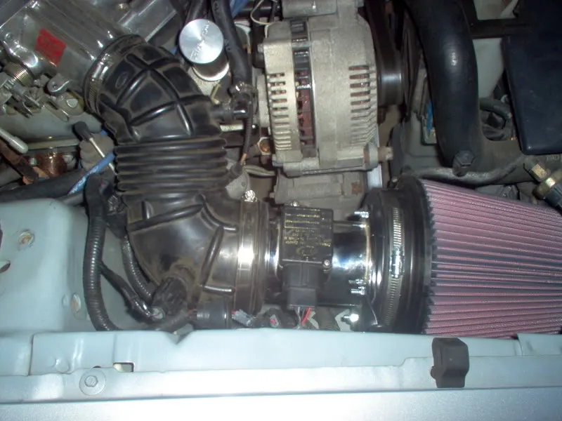

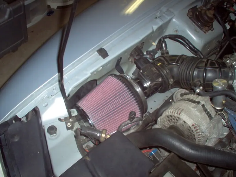

I hope this helps.....I have went back to a straight Ebay tube....I had problems with the fitment with the bullet style MAF....
