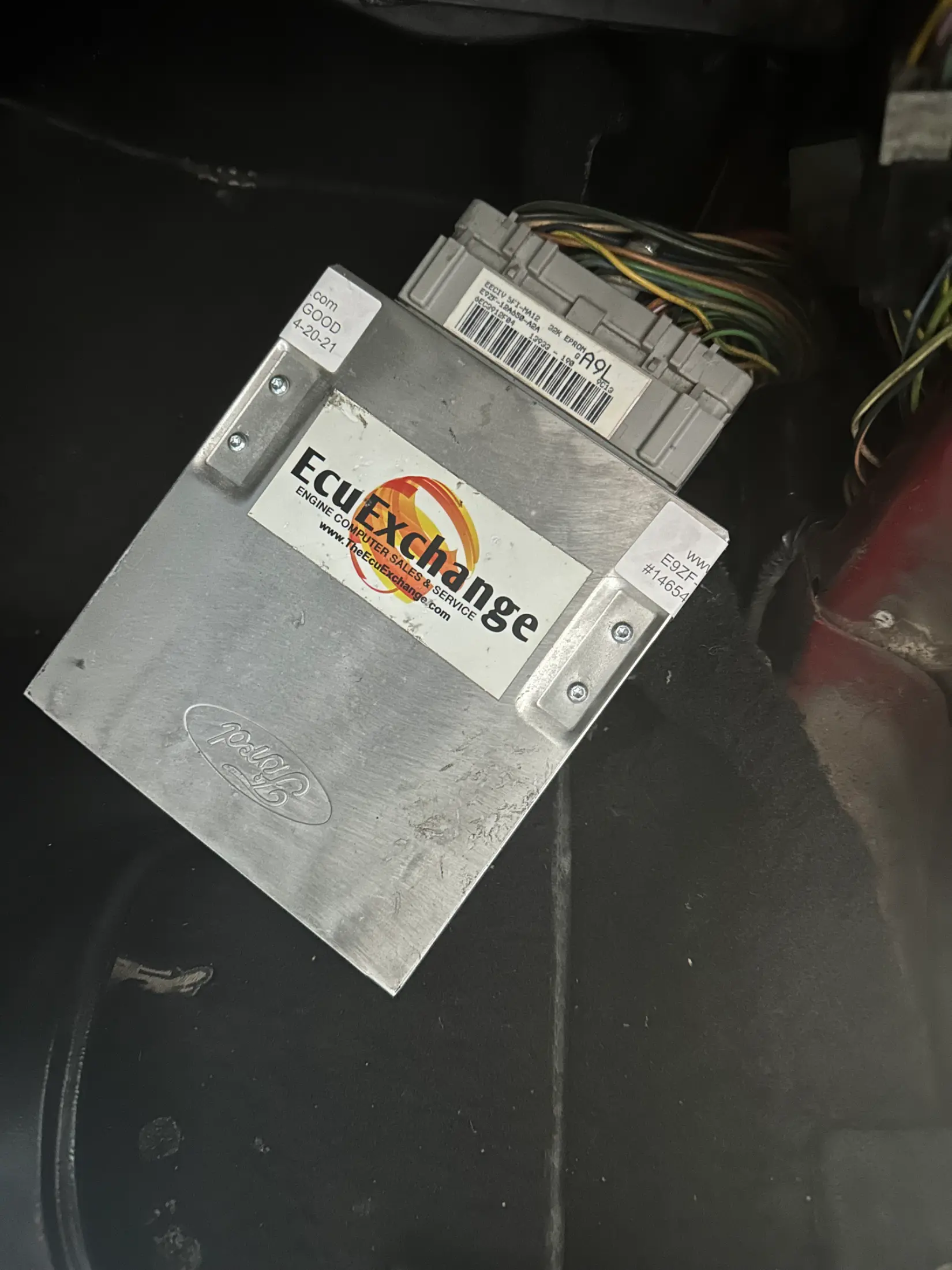

I doubt ECU Exchange will answer the phone but I’ve never tried. Did you send it off to them and have questions or just want to ask them questions to see if you can determine if it needs to be gone through? Of it’s the latter I can tell you it won’t hurt to just send it as pretty much everyone that sends their to them get the power supply and other end of life parts replaced as they are noisy or not up to spec.
If it’s your primary mode of transport then I would highly suggest you just buy a spare. I had three at one point but sold one with a harness as it didn’t make any sense to have three.

No I sent it to them and they said it passed. I thought maybe it was something else on the car but I’ve replaced pretty much everything with exception on spark plugs now I have no idea what to do cuz I don’t have a clue what it could be I already went over everything more then once I did have a da1 but I sold it if I remember correctly it did run with it I think I just disconnected the maf and ran a vacc hose to the map to make it a bap

what I’m saying is maybe a transistor or something in the ecu might have a problem/burned trace & the injectors I’m running are 30s,same as the 30s that lmr sells. I know that the original red 30s are the only injectors my car likes. I have zero clue of the maf match’s because it’s an original one I can tell. So I have no idea if they match I’m assuming that they do match be five had my car running for years that way but when I rebuilt the engine 7 years back I went all out & bought everything new I tried to buy new injectors the 30s from lmr & I don’t remember what it was but my car didn’t like them.

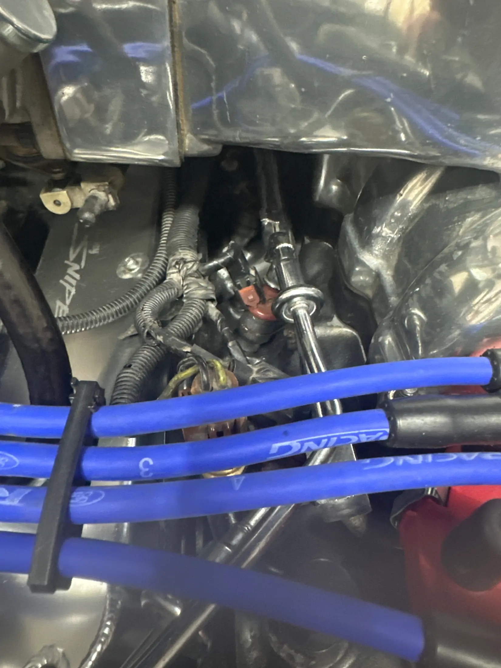

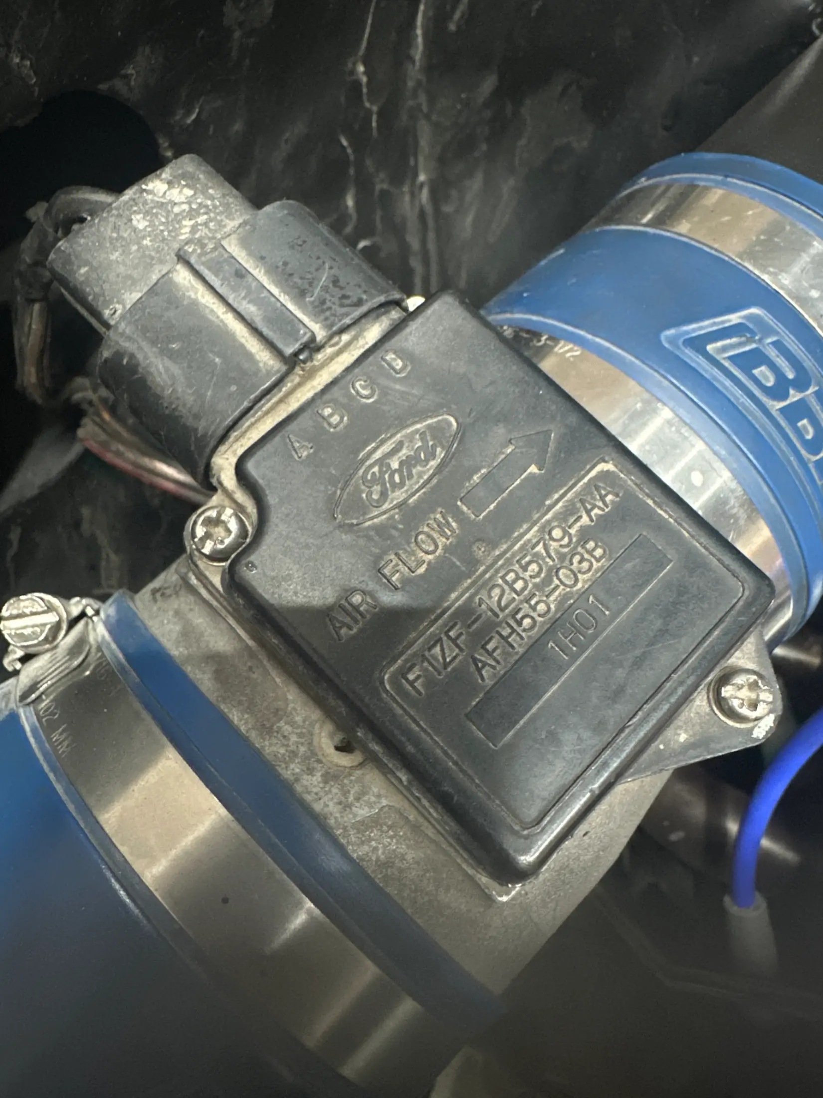

Toss up a pic of the ID plate and/or numbers on your MAF when you get the chance.

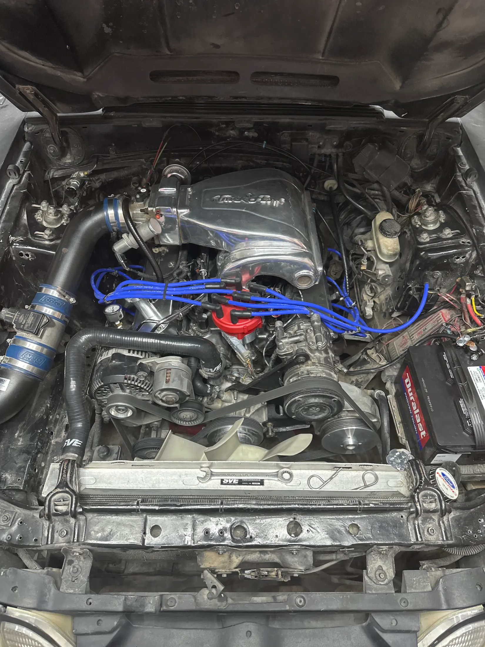

By the way the msd box is not connected I just have it in there it’s been there for years I disconnected it when I found out it was bad. I’ve been running the car for years . I can open the ecu in the morning there is no chip & in the ecu or in the kick panel of any kind

That looks like a C&L MAF housing. It likely has a sample tube in it.
The sample tube for 30lb injectors on the 73mm housing should be RED (#103).

I would bet money that is a C&L meter with a 30 lb sampling tube with the factory MAF sensor.
Yes it is a c& l housing . Where is the sample tube?

Noobz beat me to it. I was Making good and sure I remembered what a C&L looked like. I had a BBK cold air and if you clamp the blue boots down on a 55mm housing it’s ugly looking as the stock MAF housing is about 2-1/2” OD vs the boots being around 3” ID. Those boots are tight which leads you to a larger MAF.
