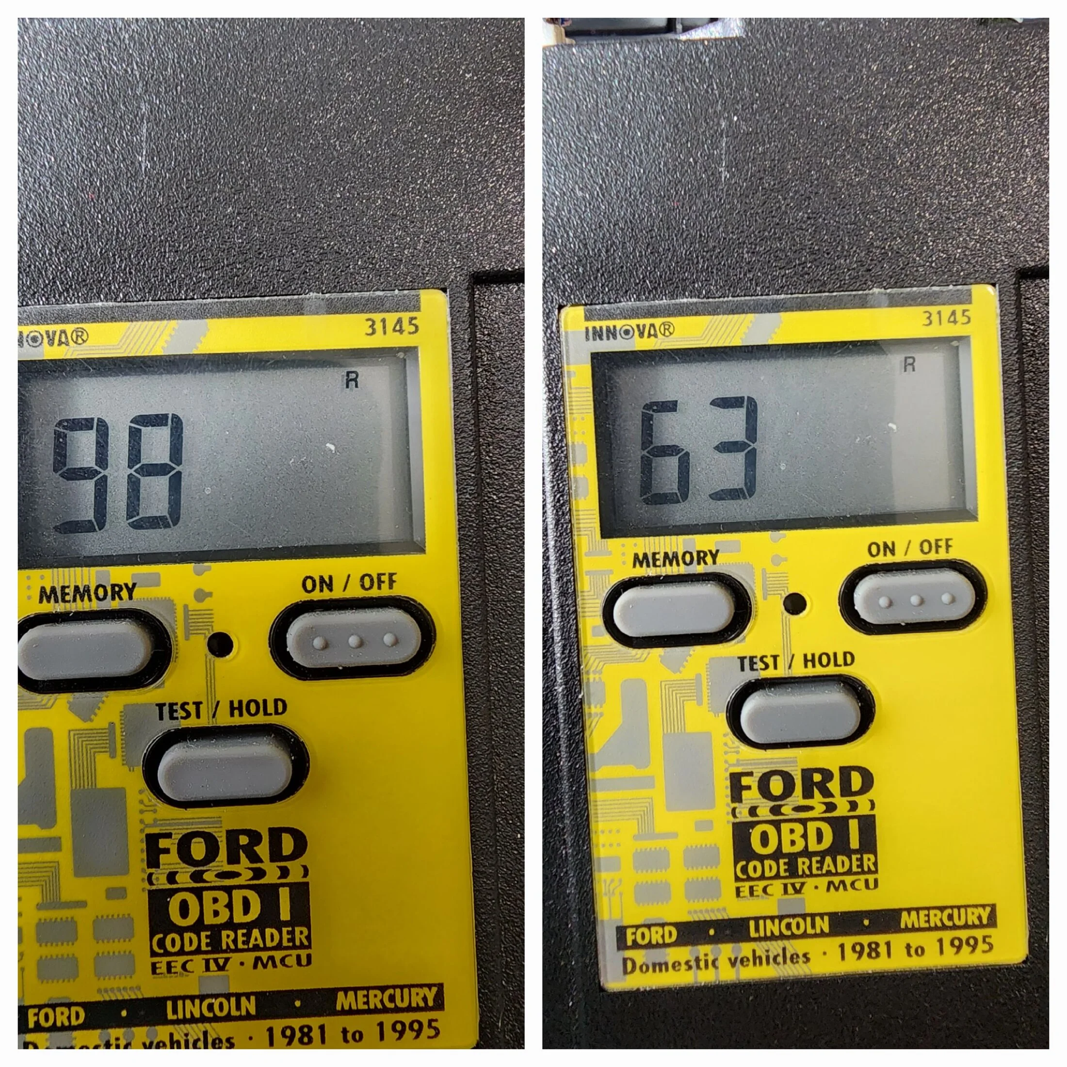

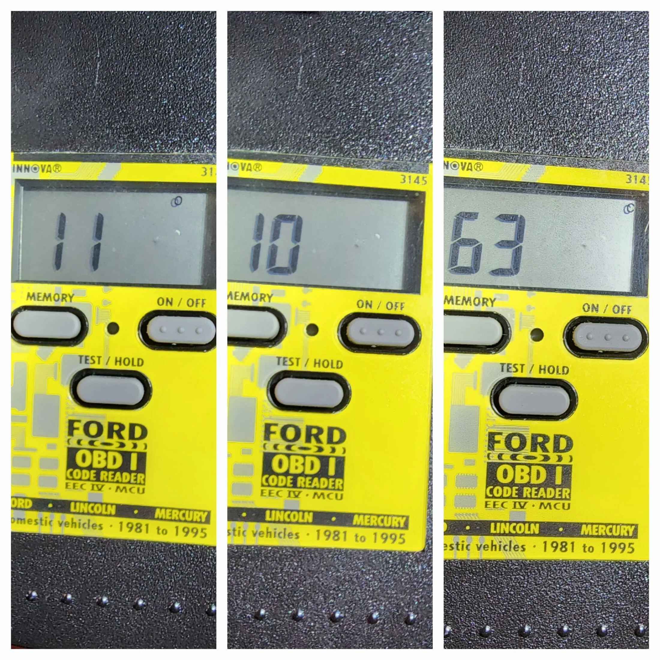

I'm probably doing something wrong but I can't get it to do a balance test. KOEO it's saying 11 for system ok then the 10 separation code and a 63 in the continuous memory for TP circuit fault, below minimum voltage. KOER test it will throw code 98 and 63.
Going to try and erase the 63 and try again.

I erased code 63 and redid the test now it's backwards. It's showing 63 O and now 11 is in the continuous memory. KOER still the same with 98 and 63.

Code 63 is your TPS voltage is too low. That means the ECU is reading less than 0.5 volts.
I think you measured 0.9-1V at the TPS sensor, but you shoyld see what you have down at the ECU. With the ECU plugged in and key ON, backprobe pin 47 and 46. Pin 47 is the signal return from the TPS. What do you have here? If oyu have 1V at the sensor, but 0.2v at the ECU, you have a connection problem somewhere.
98 (r): Hard fault present. The PCM is running in FMEM (Failure Effects Management Mode). Something is messed up. I would troubleshoot the code 63 first before proceeding. That may be causing a hard fault (especially if that wire is shorted)
