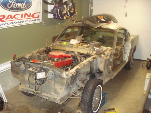

I am replacing the whole front end over to V8 gear. So far my parts include:
Pitman arm, drag link, idler arm, tie rods (Granada swap on front), 620 coils + new perches, new MOOG LCA's, MOOG rebuild kit for UCA, 1" sway bar. Will also be doing the shelby drop on the UCA's.
Here's a shot of how it looks at the moment. I6 and glass is coming out soon and then off to be media blasted.
