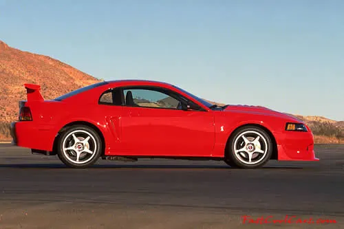

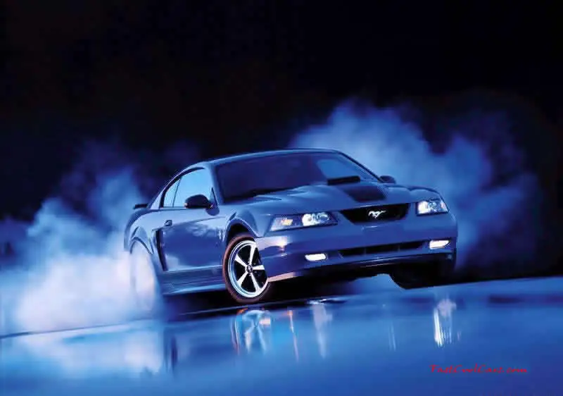

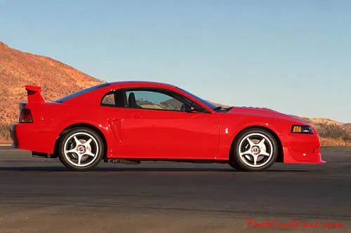

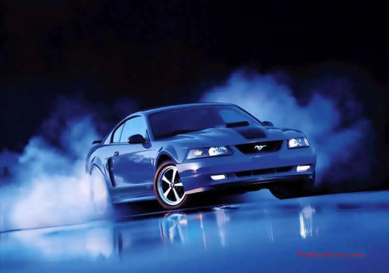

Alright you talked me into it, here is some pics...
Mach1:
Cobra R:
2003 Mystichrome Cobra:
