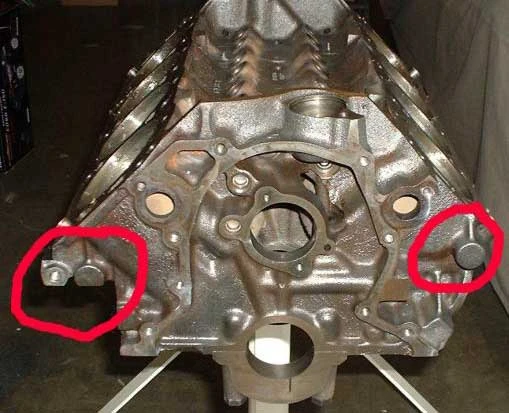

A Mexican 302 has these wierd bosses on the front as well as "hecho en mexico" in the valley.
