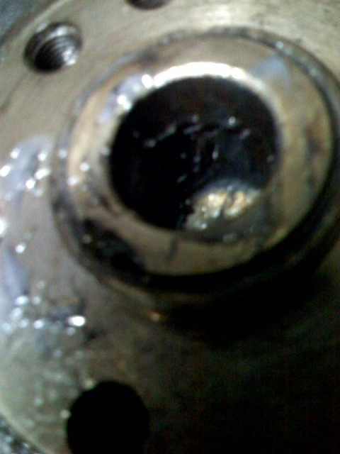

Ok, so I'm attaching a really poor pic, but you'll see that, so far, I've gotten the inner part of my old pilot bearing out and, for the outer part, I am left with nothing to hook the claw onto! I'm using a large slide hammer (the only one autozone had) with only 1 of the 3 hooks attached. I thought the outer part of the bearing would be the easy part to pull but as you'll see if you look really close, there is no "lip"behind the bearing to get the claw onto. It's like the outer part of the bearing is pushed tight up against a sleeve that has the same inner diameter - all you can see or feel is the break between the two pieces but it's paper tight... Any sugestions?

Oh right, I forgot to say that I tried the hydraulic method already. But the fact that there really isnt a cavity behind the race (I guess you call it) doesn't help. Either way, I've tried it and it failed. But thanks... any other thoughts?
I looked closer and there are two reliefs (one on each side) but they are MUCH too small for the claw of my slidehammer to fit into...

Ok, I'll try again. I think I need to get more air out. Had a lot of compression (bouncing) the first time. As for the reliefs, I noticed, but they are way to small to hook the claw of the slidehammer onto.
Well, the reason the claws don't grab is because they are to big. So big that I can barely even get ONE of the three claws into the bearing. And using just one claw also sets the whole thing off for a pull.
