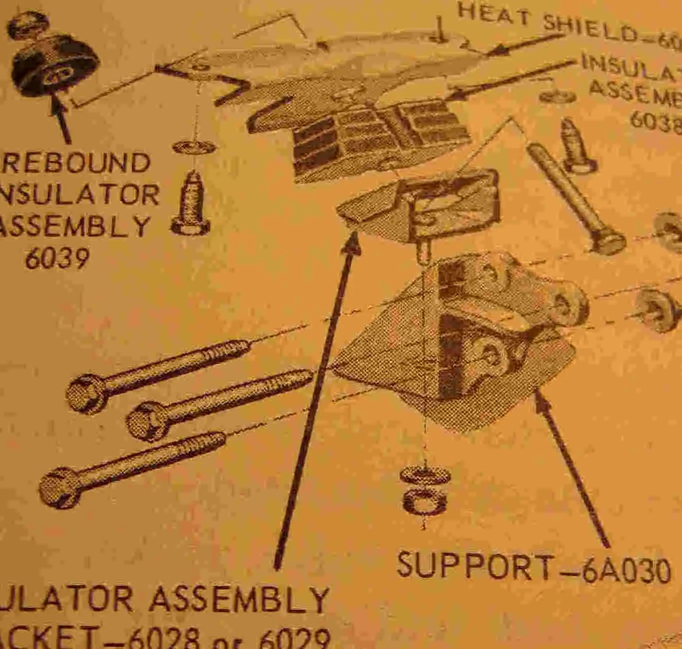

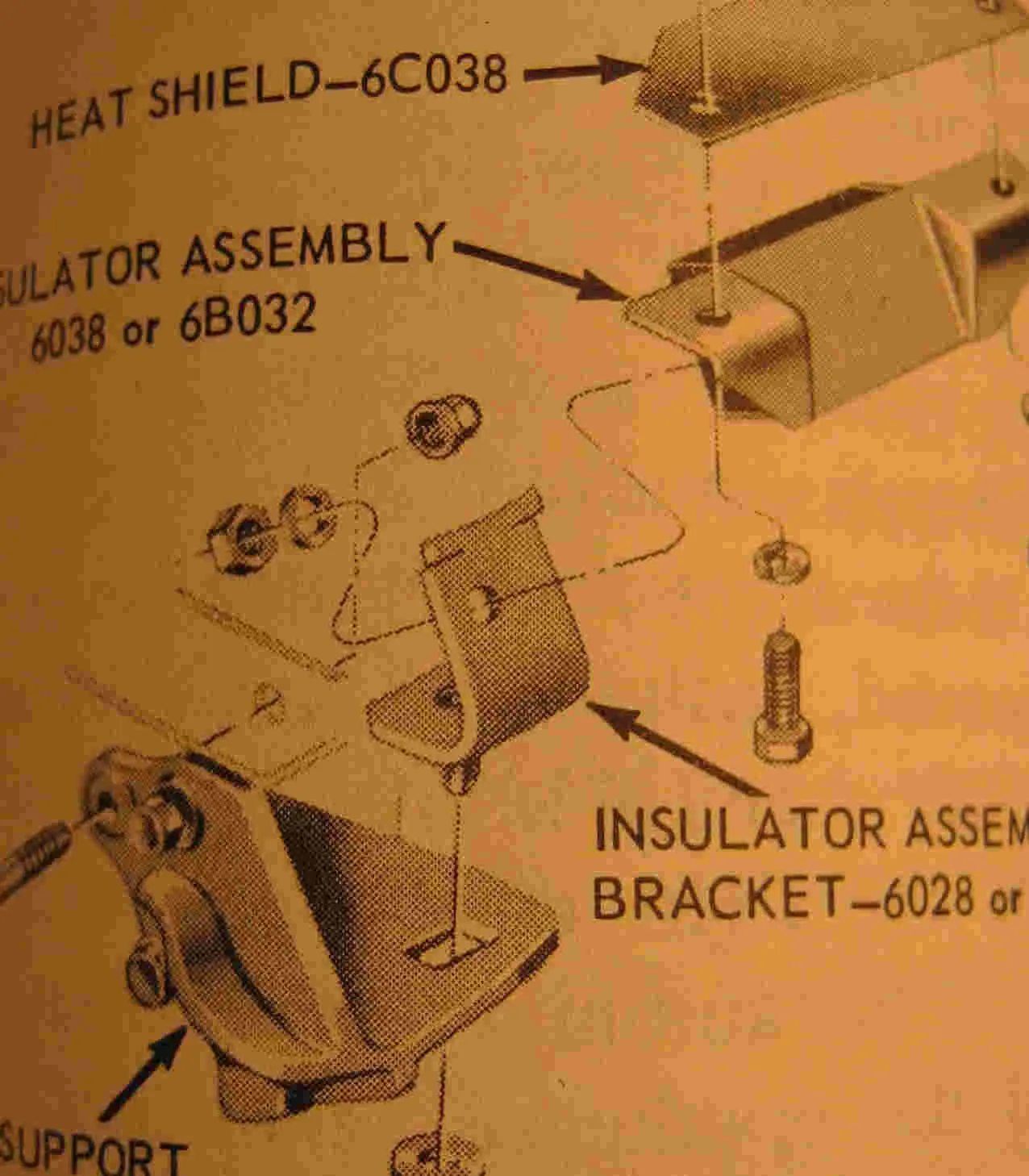

will have to double check if it is pan fill or case fill - and the tranny definitely has the 164 tooth flywheel - the original C4 had 133 (i think, but definitley not 157)- now you have my attention - if i replace the oil pan - could this still work? by the way - i have the pics but i can't figure out how to upload them :shrug:

These are from the 66 shop manual.
