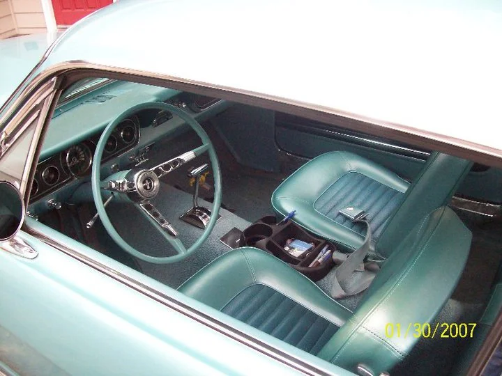

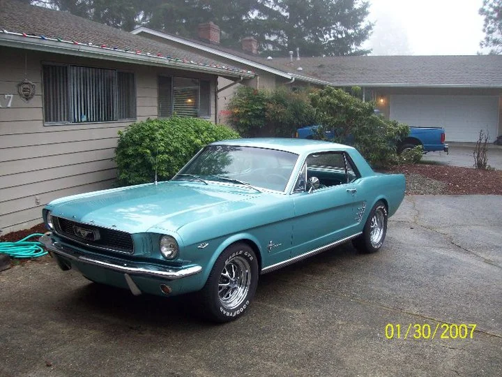

I gave a 1966 Coupe numbers matching in Tahoe Turquoise I am still on the fence if i should restore it to original or resto-mod my girl. I lean more towards the Restore to original side simply because there are not that many numbers matching cars left in the world. I would love to get everyone's opinion.

Ask yourself what you want the car to be. What is your vision for the car? Then go build that car. There are more than enough original cars in museums. These cars have many short comings by todays standards such as handling, brakes, safety, comfort, etc... As nice as it is, I see a car like yours as a blank canvas to build on.
