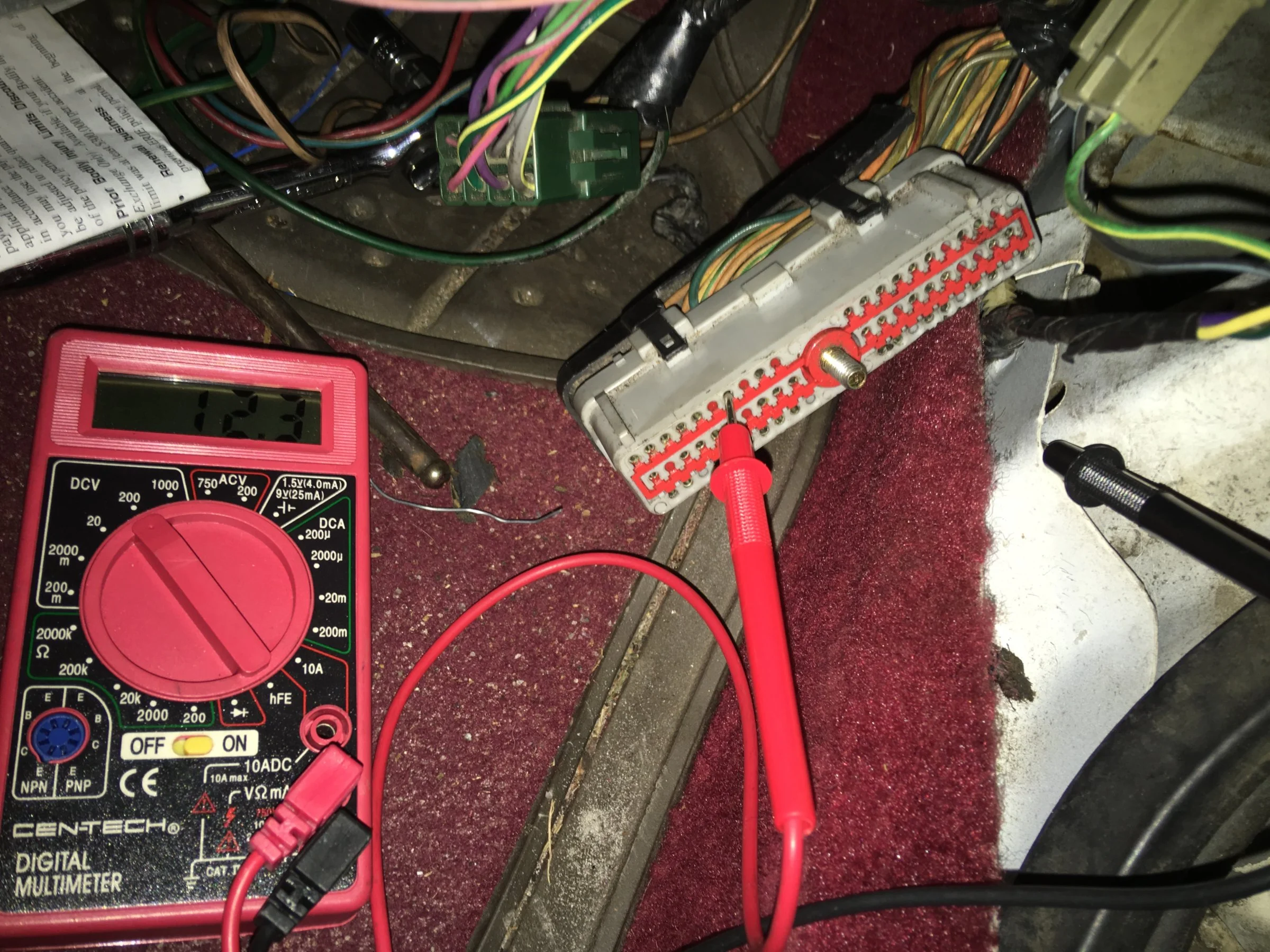

@Mustang5L5 and @liljoe07 I should get no power or 12v at 46 when the key is on correct?

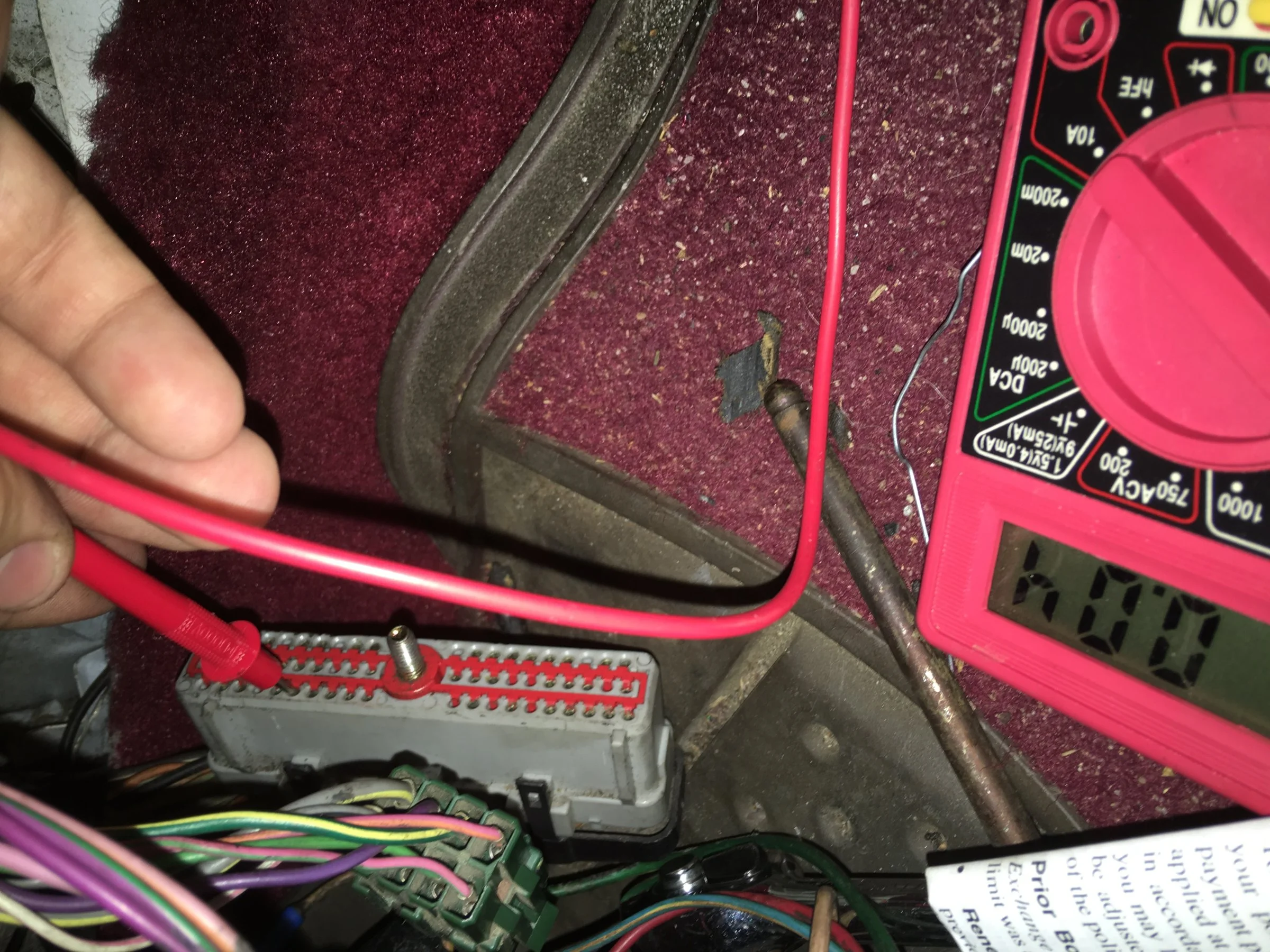

I think I had my orientation wrong. I got .01-.04 with key on and key on clutch in. Cranking it jumped to .40 volts. Shouldn't this be zero
That small amount of volts is not an issue. You are good to go.

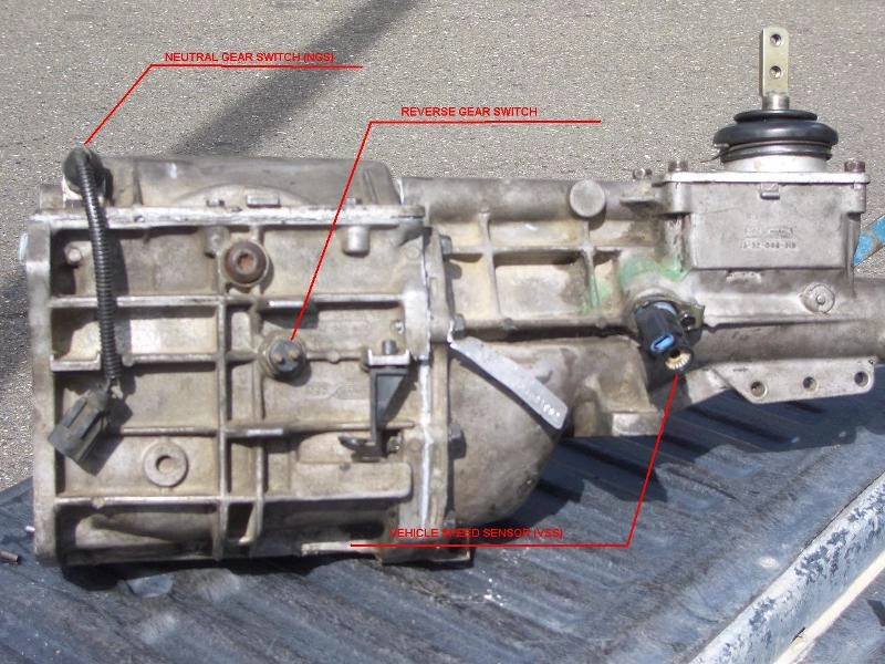

Is there a picture of the where NGS is on the trans?
Pass side. Top pigtail.

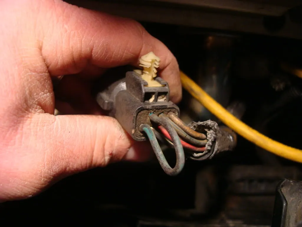

It's wired in parallel with the one on the clutch switch.

What issues does the NGS cause left unhooked?

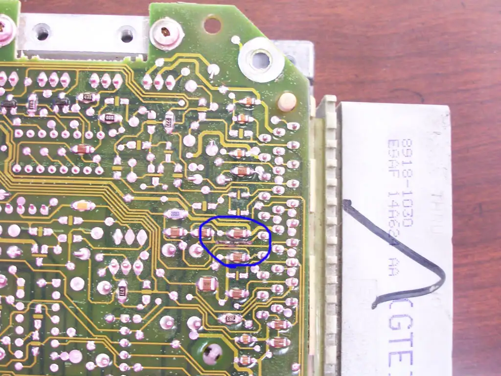

I don't think it's going to make a difference. I wonder if the trace on the A3M is burned since oyu ran the auto O2 harness with it.
When you have some time, open it up and follow pin 46 back to this trace and see if it looks burned.
Yeah I actually was about to get to that point. Would a trace starting to fail (burn) cause it to have intermittent or would it just not run at all?

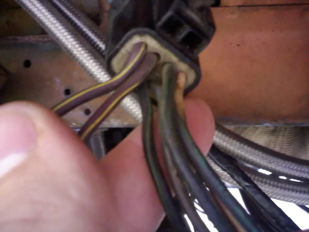

So in your case, are you sure your engine harness is a 92-93 harness? Reason I ask is the pinout did change depending on years. From 89-90, the 5-spd harness was pinned with the top wire moved over 1 spot to the location circled.
What color is the wire here on the opposite side?
No matter what we do here, always double check that pin 46 before plugging a computer in if you move an pins around. Clutch in, while cranking. There should be no voltage on pin 46.
