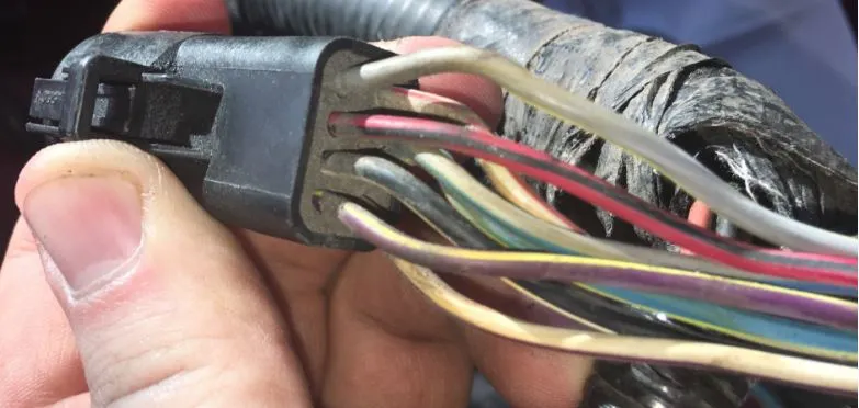

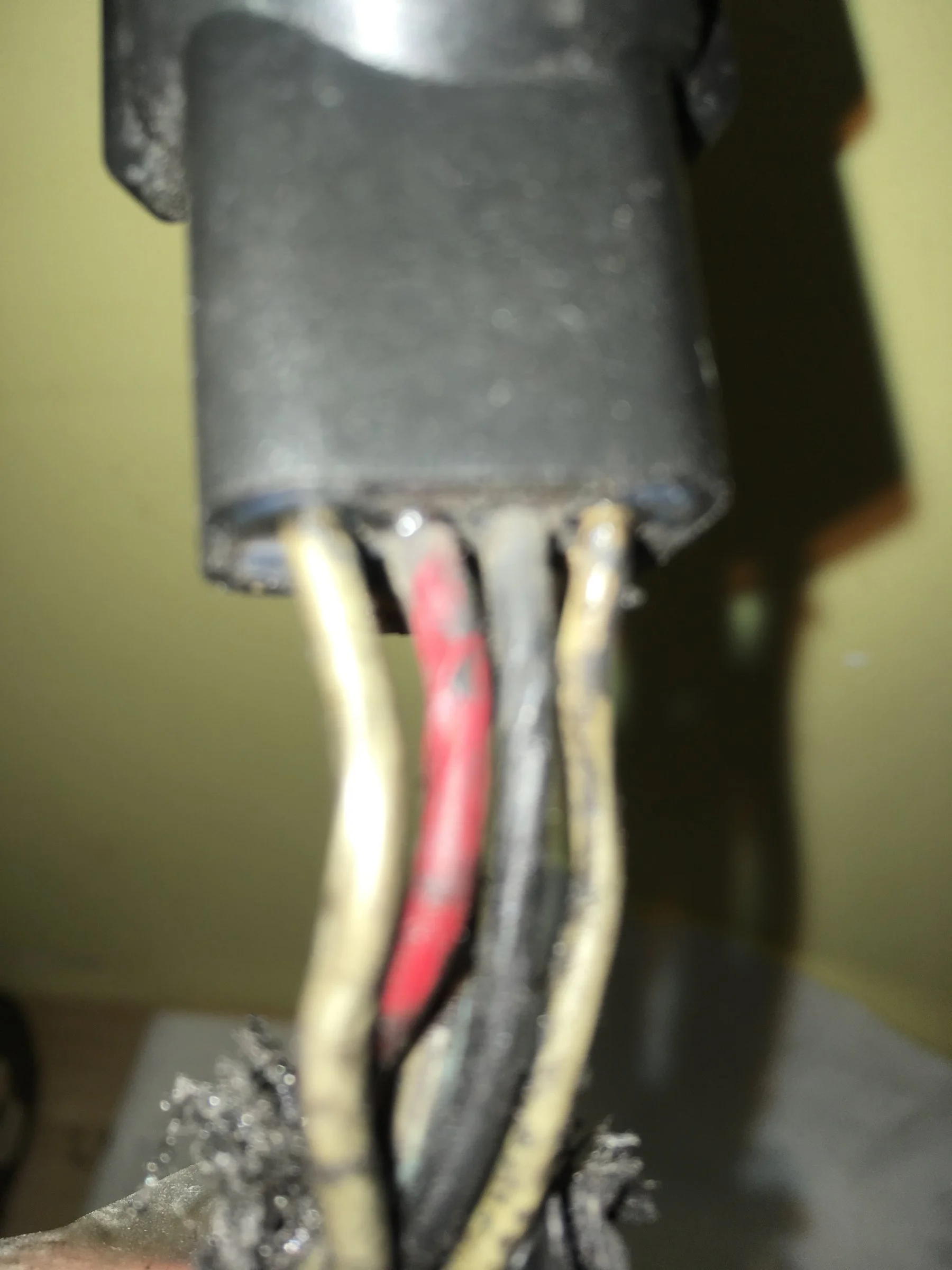

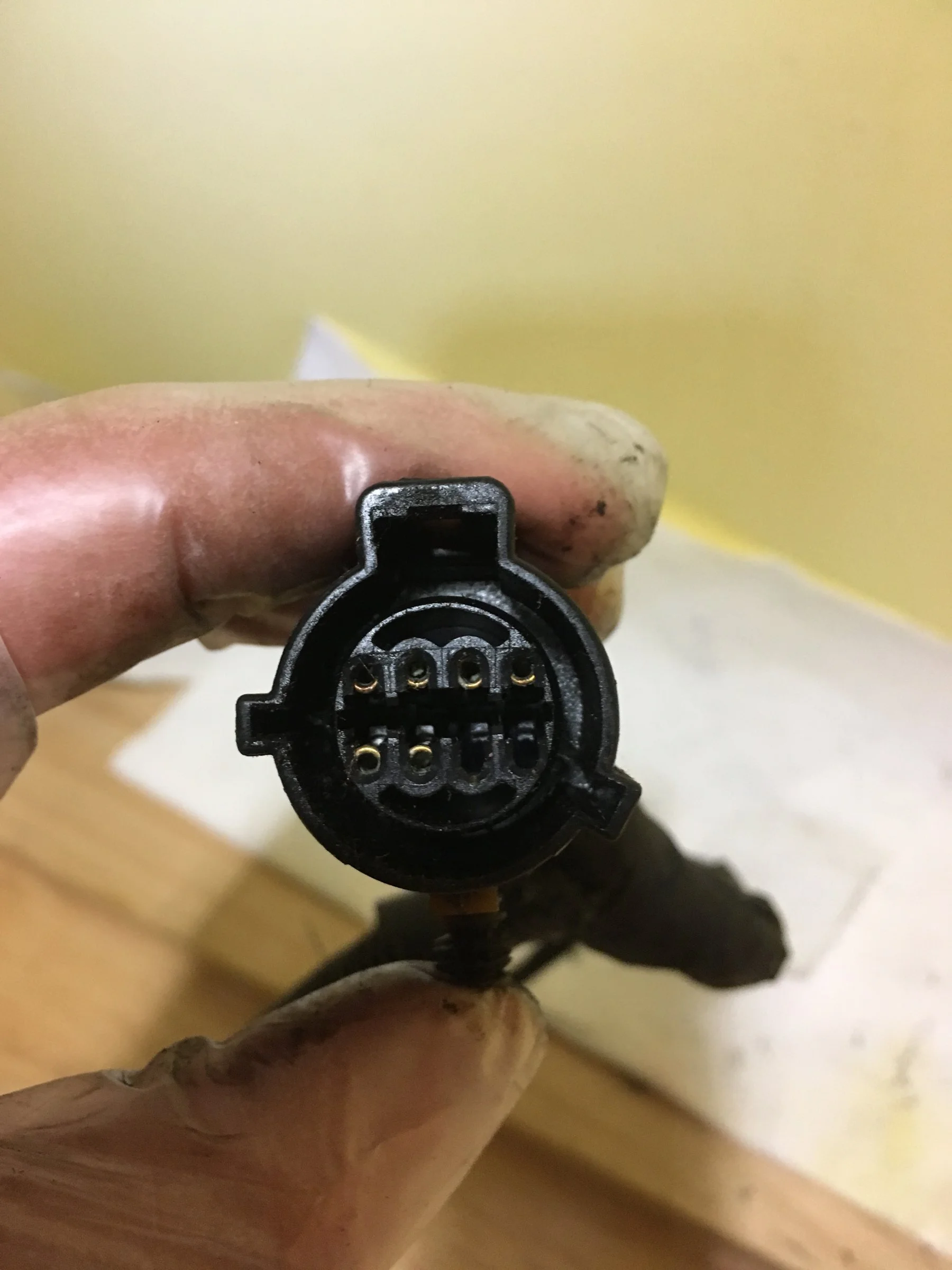

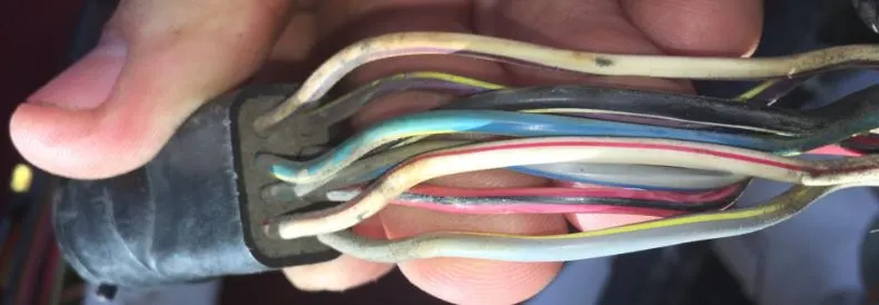

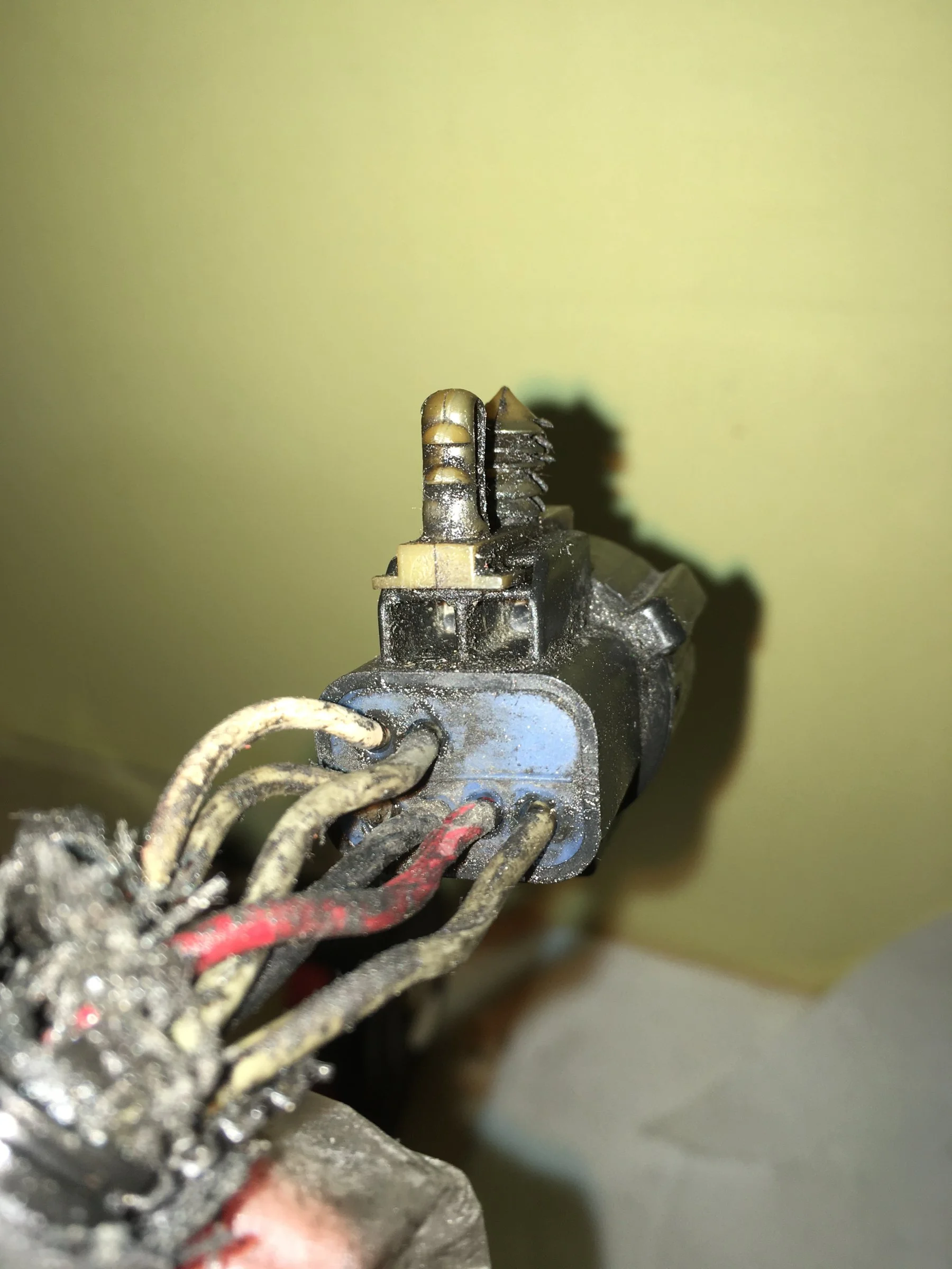

O2 Harness ?
My car was a 4cyl AOD, now a 5,0 T-5 which I unknowingly bought this way.
Has code 67 (among others 81,82,85, 29,32,41) and breaks up at 3500ishRPM, although I can drive it like grandma at 70mph.
I bought a T5 harness (current one is the AOD) and would like to get the O2 harness right. Today I pulled the O2 harness that is currently on the car, and from what I read in Black1987's recent post, it looks like my O2 harness (which has not been plugged into the ECU harness since I got the car) is from a pre 1988 (no jumpers).
The ECU harness appears to be a 91-93, as my wire colors match up exactly to Black1987's (took snaps of his pics as they were more clear than mine), and I believe he concluded that this wire scheme is a 91-93.
I am assuming that the pre 88 O2 harness and 91-93 ECU harness are not compatible, thus I have located a 93 O2 harness that I am picking up next week.
I will check the ECU at first opportunity, but can anyone tell me based on what is described above if it sounds like it could be fried?
Thanks!
Brian

Awesome thanks very much, and yes I was able to dump koeo codes with the code reader, so knowing this can only happen if pin 46 is functional saves me some work.
Thanks for the above information. I have read a number of your posts but sometimes for me helps having the information on my specific project and having it all it one spot.
Thanks again and happy holidays!
Ah, yes without a jumper in your current o2 harness this wouldn't be an issue.
However, once you get the new harness you'll need to confirm it's pinned correctly for the ecu you have. Checking voltage on pin 46 then before plugging it in and starting the car might be a good idea as a way to double check
