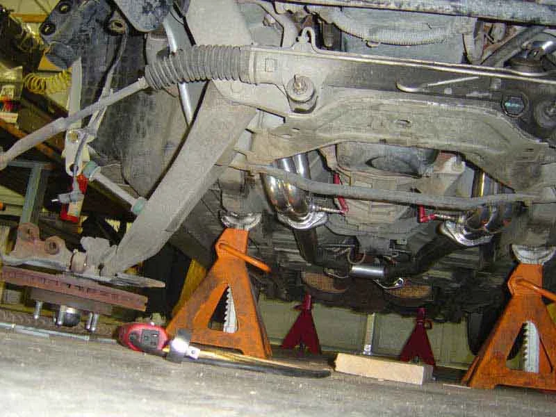

I wouldnt spend the money on new sensors, nor would I buy the extenders for $30! Once the headers are fitted in to place, measure the distance you need and make extenders with 4 wires (16ga). Make sure to solder your connections and use heat shrink on the splices. Once completed use some wire loom with zip ties to help protect it.
