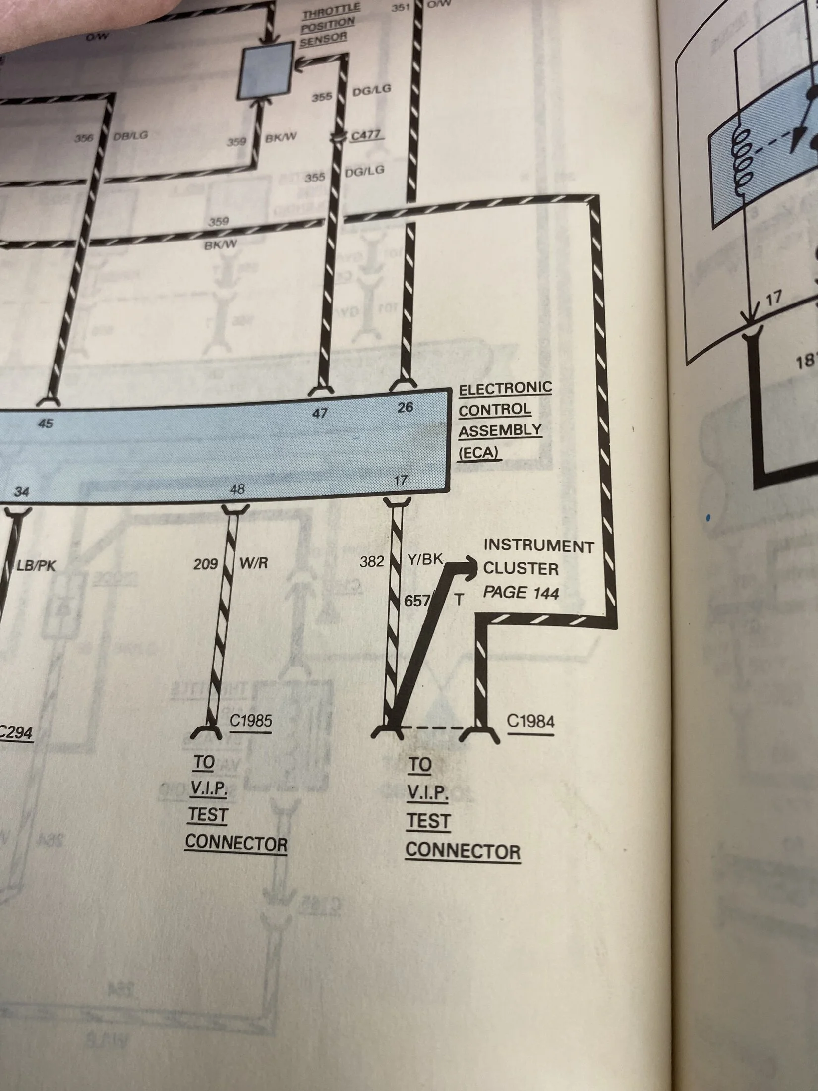

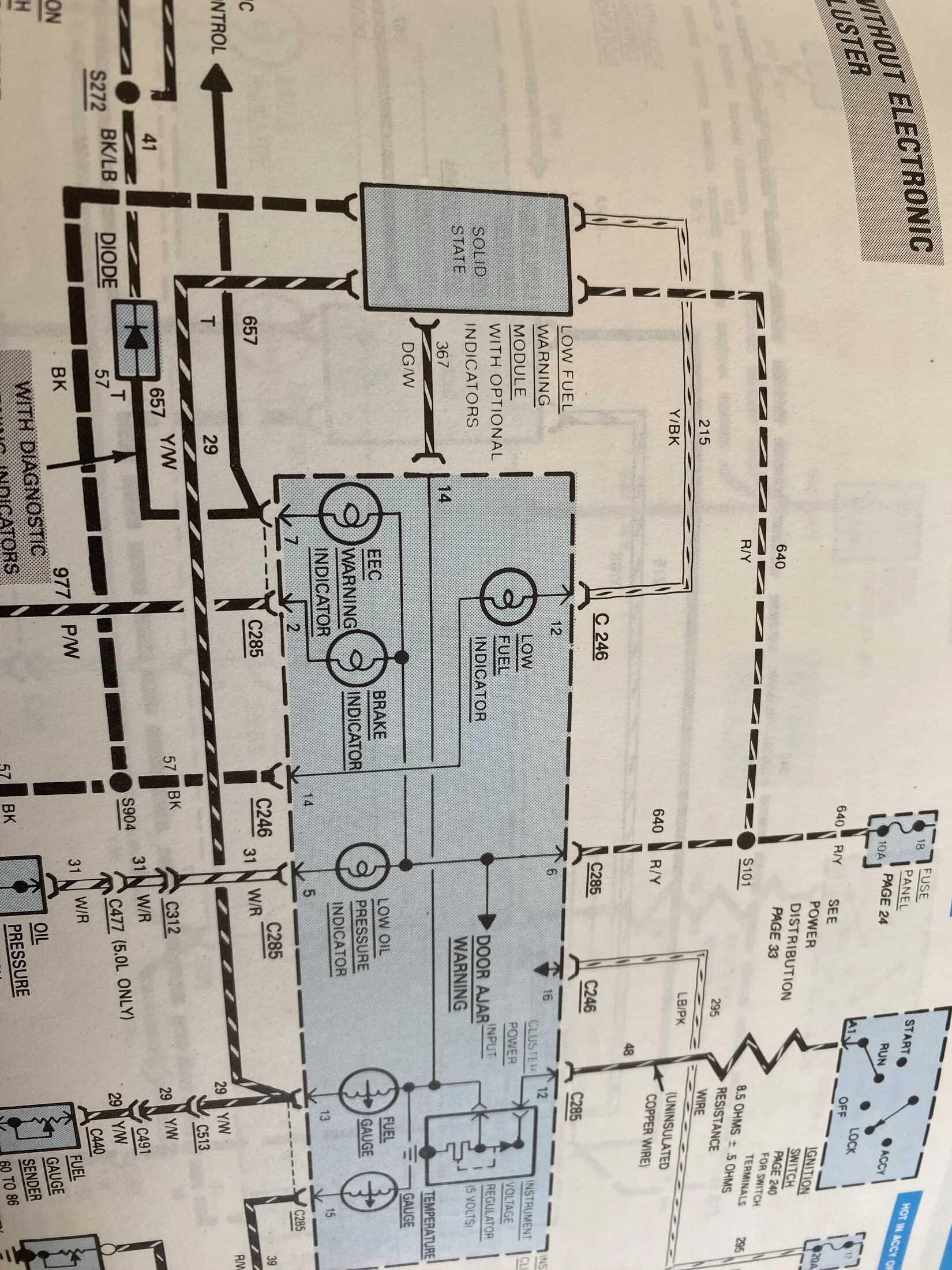

Ok, so if I understand the Ford 1987 TBird Troubleshooting manual I have, pin 17 on the ECU is responsible for acting as the ground when an emissions related code is activated. I say ground because according to the manual, the routing is fuse, light, ECU pin 17. So, if I could make a temp bulb with power and connect it to that Y/BK wire that connects to 17, and it lights, at least the ECU has a stored memory fault. Right?
IMG_2663.webp ECU pin ID at test connector
IMG_2662.webp ECU “Waring Indicator” power routing

FYI, 1987 Speed Density cars did not have a functional check engine light. You can wire pin 17 to the cel manually to make it functional. If you are doing a swap, i wouldn't rule it out that there might be a wiring harness that has a pin out of place.
