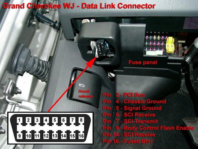

heres a pic off a jeep.. If it doesnt look like this.. Its OBD 1
