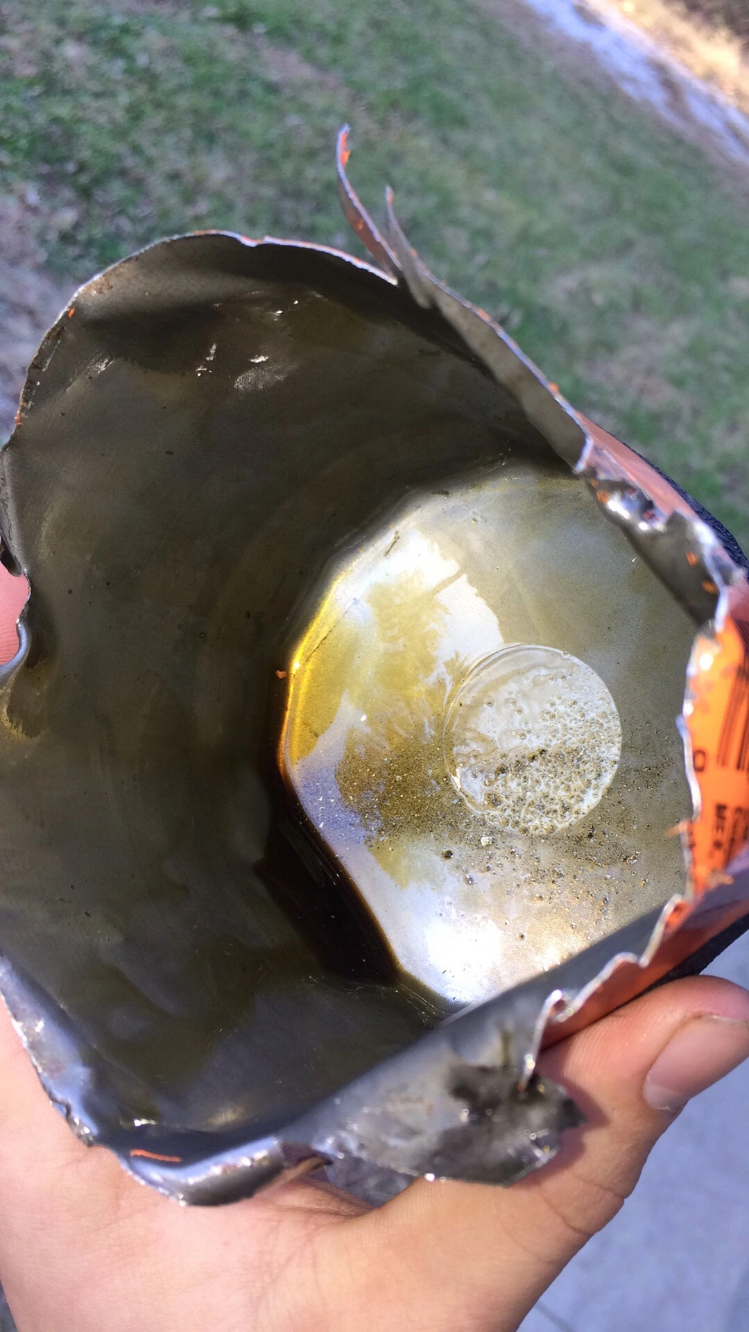

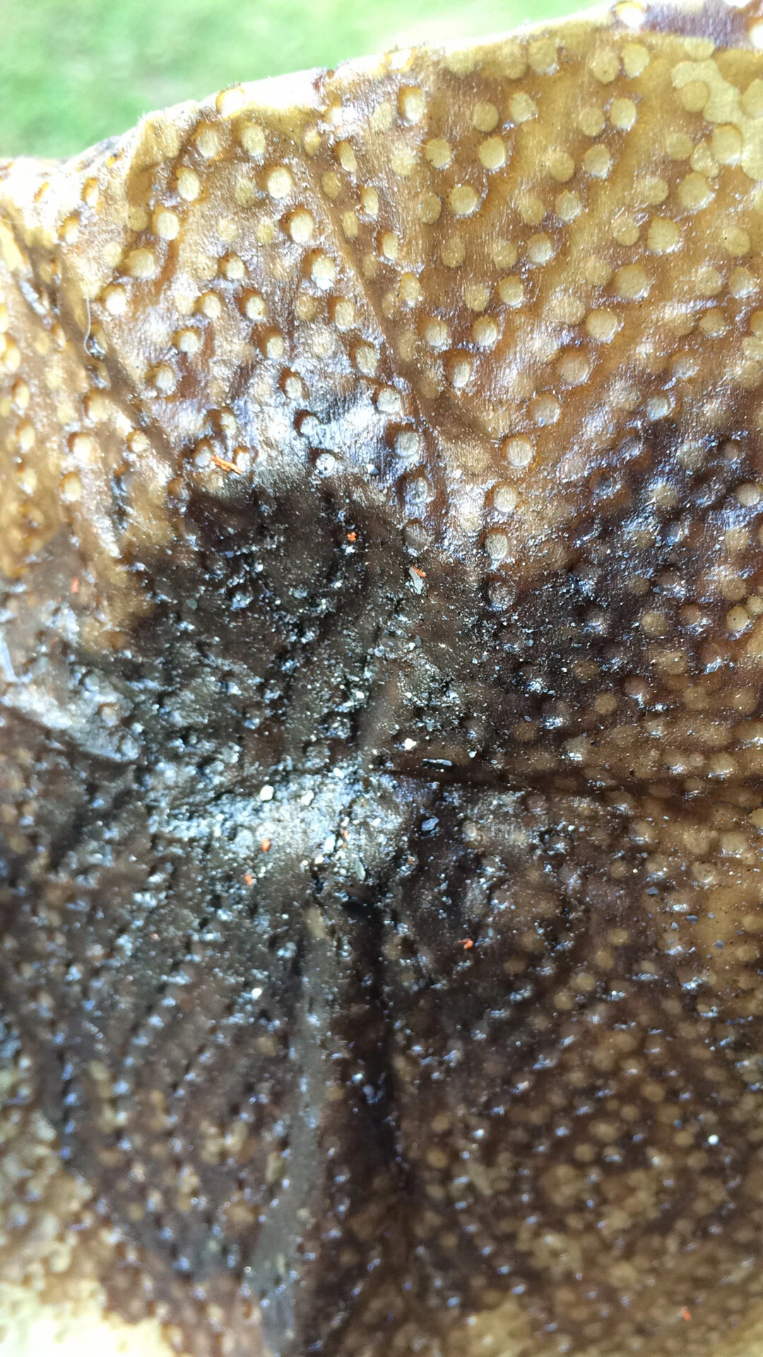

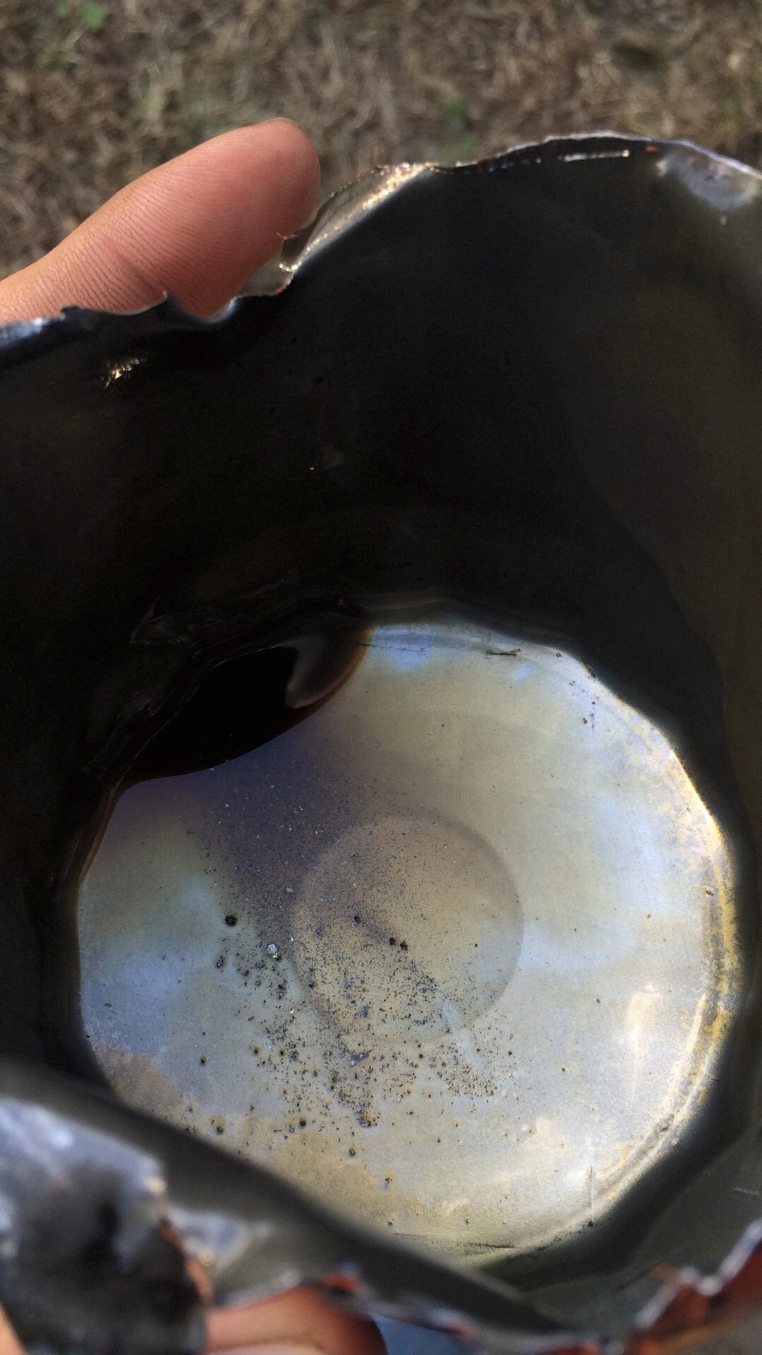

I have my suspicions of what it is but I don't want to sway the opinion of this thread so I figured I'd wait for some fresh thoughts before we go down the path that im thinking. Currently I have the car sitting with the oil drained. I've cut open the oil filter (pics will be posted soon) strained the oil that came from it and will strain the oil from the pan soon.
