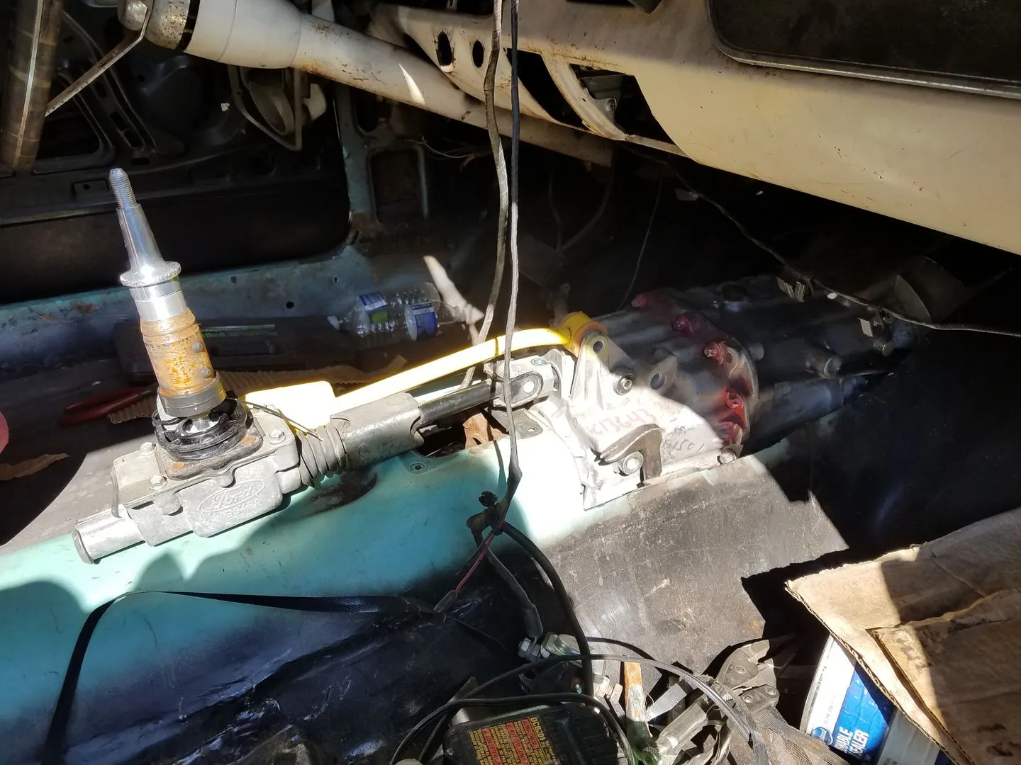

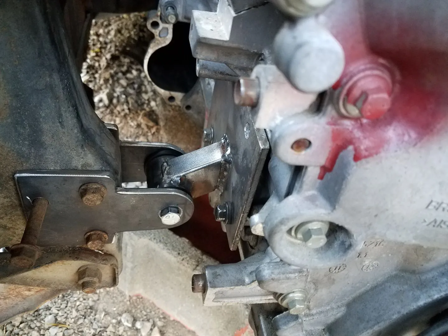

I am not going to start a build log here(since I already have one over on the vintage mustang forums), but thought I would show what I am working on these days:

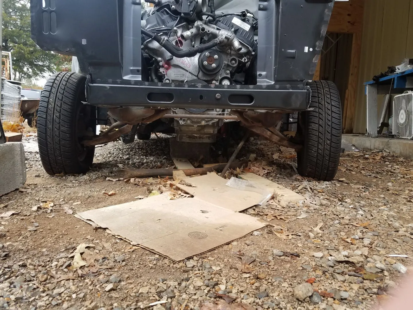

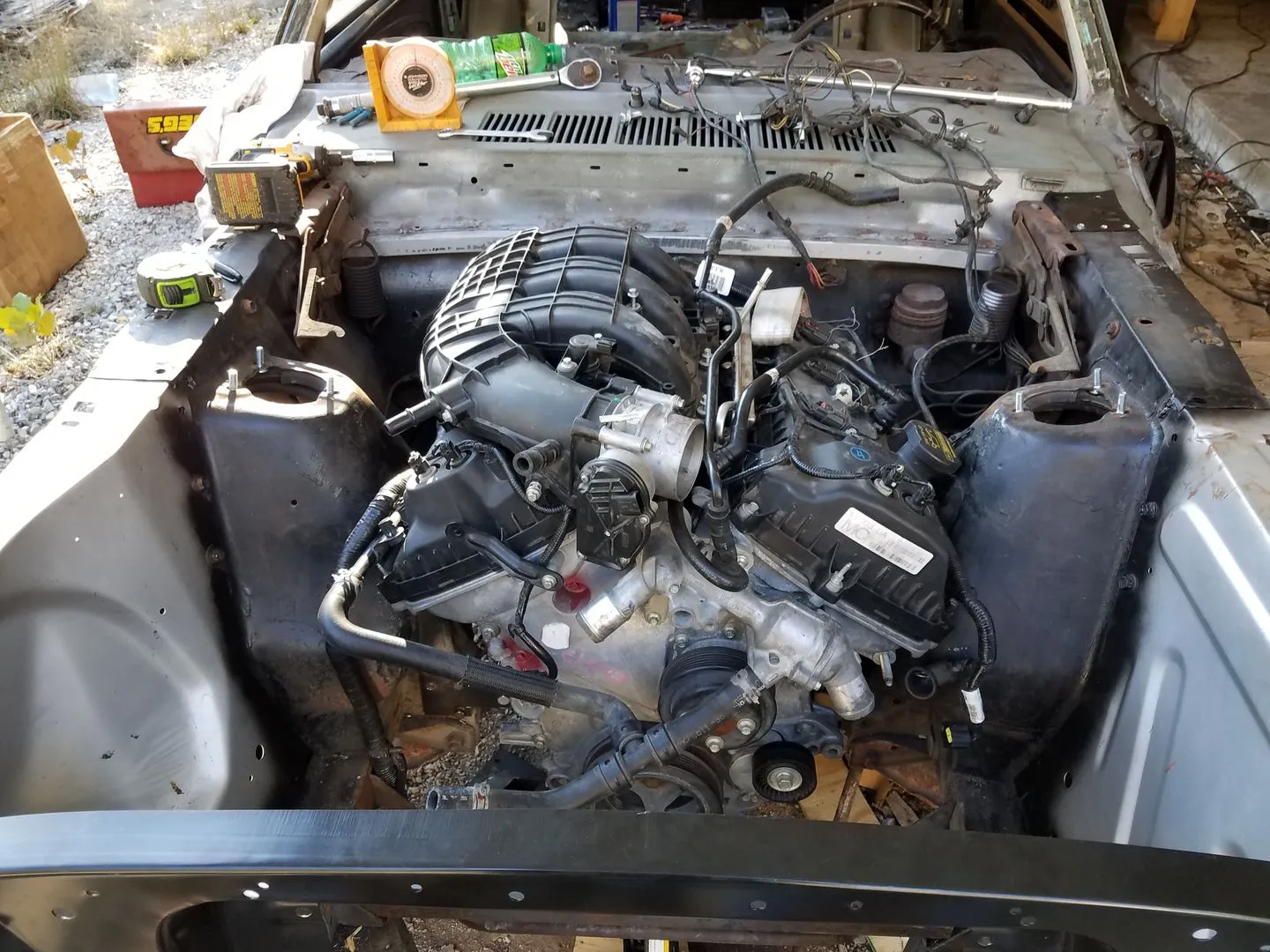

Its a 2012 Mustang V6...chosen because it fits between the stock shock towers, makes more power and torque than the 289(even a HiPo version), gets 30mpg, and most importantly weighs 200lbs less....scratch that...the most important reason is because its fun...everything has to be fabbed it seems...oil pan, headers, etc.

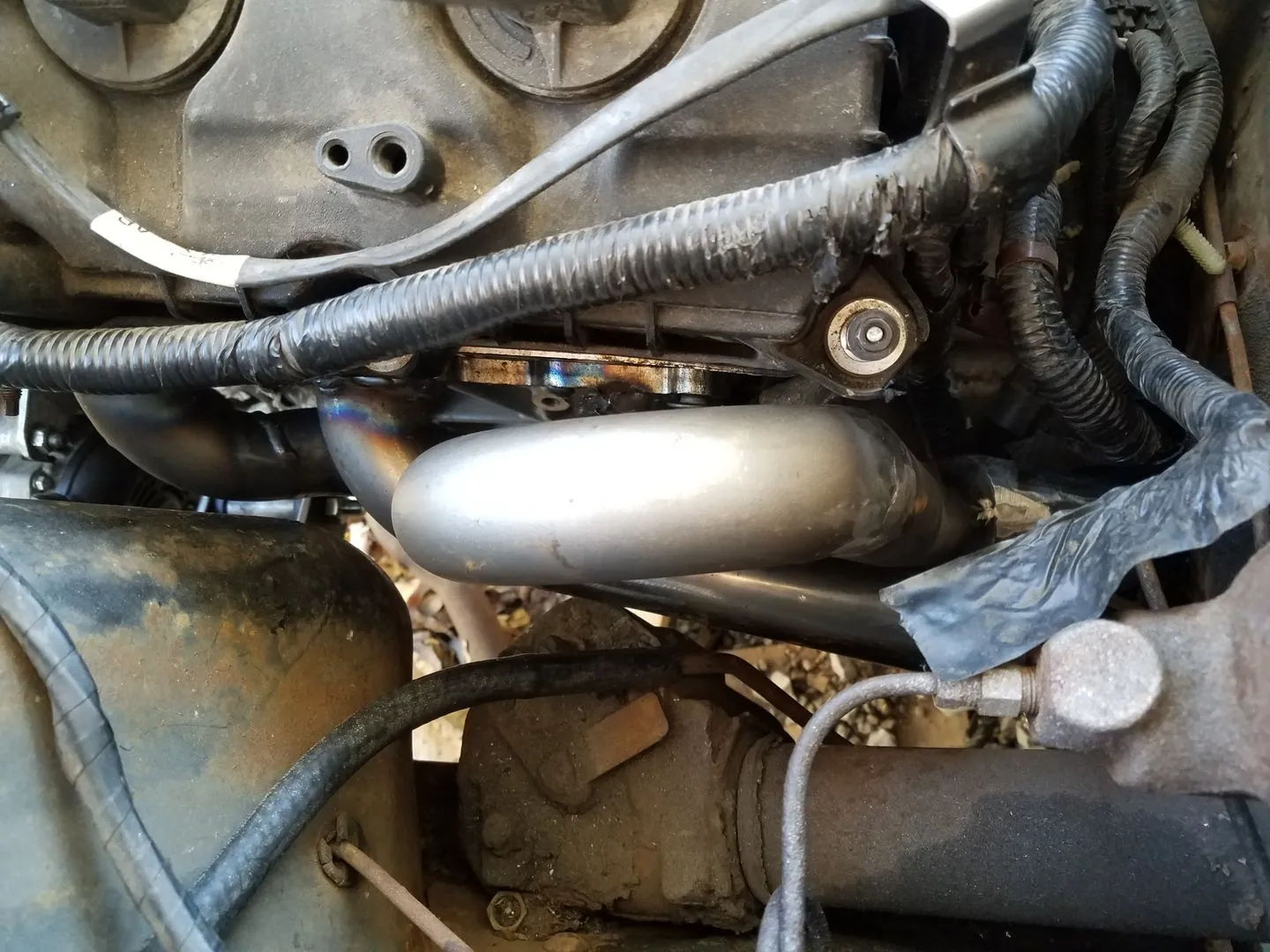

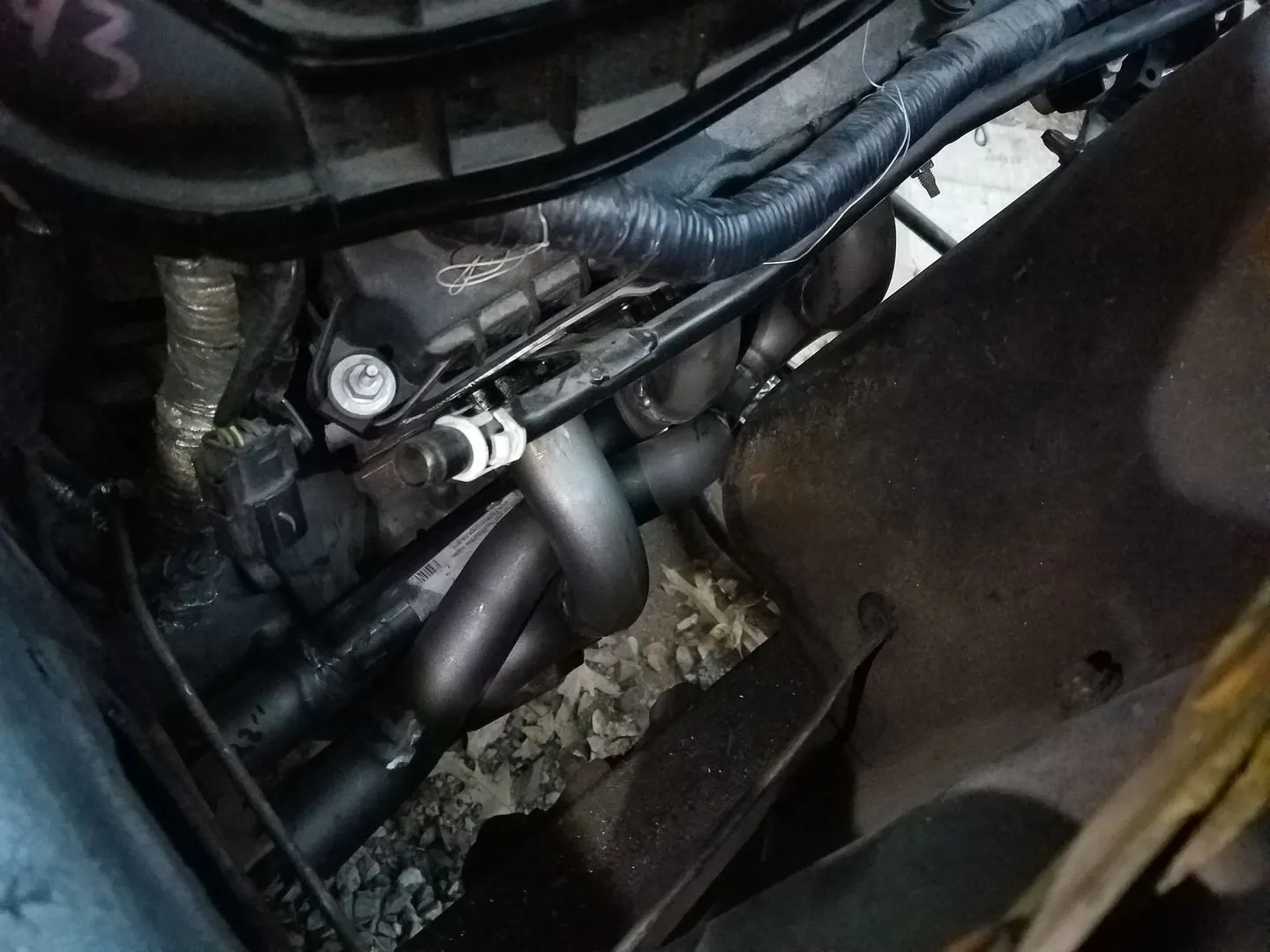

Equal length long-tube headers(Just finishing up the back half of these now(talk about difficult to get in and out of the car with the engine bolted down)),the exhaust will consist of no cats, with an X-pipe....mufflers and/or resonators to be determined.
