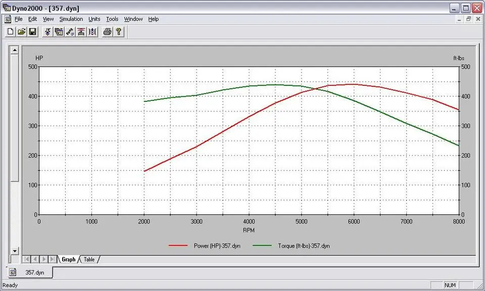

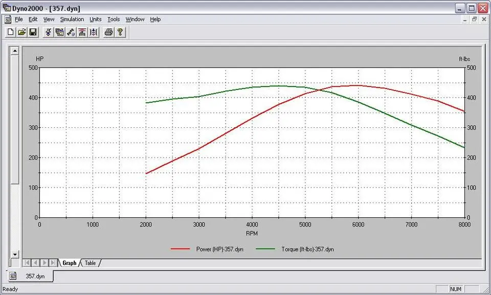

Official 'Let's discuss Torque vs HP thread...
Torque shows up most in the 0-60, HP takes over from there...
That is an awsome torque curve. Peak at 4-5k? That is is my next motor right there. And from the same company. But I'm going to spray the piss out of that one! :eek:

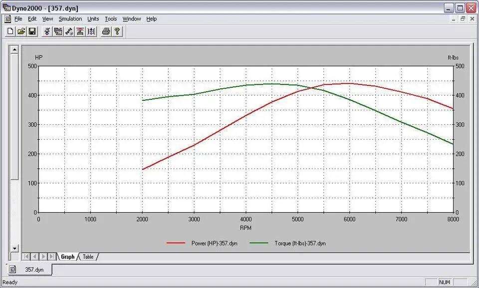

Hack, you say Torque like it is a bad thing.
Re my engine, it is a 351W bored .040 over. I have posted the dyno below this message. Basically, my torque peaks at 3600 rpm while my engine makes power to about 5600 before it flat lines. My timing is still way off. I am at 28 degrees total advance whereas I should be at 32-34 considering my 10.5 CR. I should pick up some power when I get the timing right. Crower tells me this cam's power band is 2200-6000 so spinning it faster won't get me any gains.

<img src="http://forums.mightymustangs.net/index.php?act=Attach&type=post&id=7611"width="800" height="900">
72grande said:
Not to be a nitt-picking *******, but 400 NM is only 295ft-lbs.
http://www.convert-me.com/en/convert/torque
Still better than I'm putting out. I'll post my 'stock' dyno if I can find it.
I know. I asked them about that not less than 3 times because it seemed strange to me to make so much torque compared to HP. The shop assured me that although the graph says newton meters, it is actually torque. They say that at the bottom of the graph where the results are displayed, it says torque and not NM. Still, I must confess to having some doubts. Outside of a V8 turbo diesel in a Dodge Ram 3500, I cannot find another engine that makes so much torque relative to hp. Even if it is 295 ft lbs at the rears, that is almost 400 at the fly. I would not lose any sleep over it as the numbers are good no matter how you slice it. I would have to brush my teeth and rinse with Listerine after eating Crow, however, if Hack is right.
But after looking at your own chart, you are making 80 ft lbs more peak torque than peak hp so it could very well be possible that I am making 100 more ft lbs torque than peak hp in my build. I would not bet the farm on it, but it is not outside the realm of extreme possibility.
Those kind of anomolies dont happen by accident. It took a 351C with a 2 barrel carb and a single 2 inch exhaust pipe to do that.
Your dyno doesnt apear to bein english. At least I dont know what koppel means. Torque is just a type of force. So 400 touque, as it says at the bottom, is meaningless without a unit of measurment. I think there was either a miscomunication between yourself and the dyno-operator or he just didnt know how to use the dyno software.
EDIT: HP=(TQ*rpm)/5252 iirc, so we can just check the calcs on your graph and find out for sure. One minute please...\
I have aprently forgotton how to do math. SOmeone else can figure it out. The answer is there..... goodnight.
