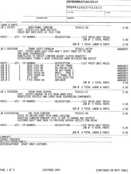

Had mine fixed and the difference is incredible. No more 1-2 grind and it goes into 3rd with no problems, and even downshifts great. The difference is like night and day. I didn’t know how bad it shifted before until they fixed it. I have only 2400 miles on my Mach 1 and the ticket said they found worn syncros! They used some of the new part numbers and a few additional parts as well. They didn’t argue when I took it in and they said they knew exactly what the problem was. They were an SVT dealer so I figure they were used to fixing the problem. When I called Ford the woman said she knew what I was talking about because her father had the same problem with his car. She told me to take it to an SVT dealer because their Techs are required to have a higher level of certification. (I don’t know if this is true but my first dealer was as about as useful as a one legged man in an ass kicking contest.) She recommended the dealer I took it to. I’m happy so far I just hope it lasts. I can post a scan of my service ticket with the work that was done and the part numbers if anyone is interested.

TRANS FIX NUMBERS
YES POST SERVICE SHEET OR NUMBERS OF PARTS
THANKS

Yea scan the service sheet and post it so I can print it off and see what my dealer has to say.

OK here's a scan of my service invoice. I hope this helps. Also there is someone on the Mach 1 registry posted a scan of his fix. It was a little different but here is the thread if you want to read it. http://www.mach1registry.org/forums/showthread.php?threadid=12511
Thanks for the info. I couldn't help but notice they only used 3 quarts of fluid??? Is this accurate, or am I mis-reading one of the part numbers?

Thats what the ticket says, I haven't had the time to get the car up in the air to get a good look at what they did, but the difference in shifting is amazing. It almost shifts like the toploader in my 68.

Here's something that'll make you laugh...NOT.
Ford replaced my tranny in Jan and on the work order had 5 quarts. I questioned the tech and he said that they put in the proper amount but put down 5 quarts to bill Ford.
In the meantime the new tranny felt horrible. After a few days I brought it into my mechanic who drained the oil and guess what, the idiots did put in 5 quarts. I had the mechanic lower it to 3.2L (as recommended by tremec) and it felt better, still a little notchy, but alot better than when it had 5 quarts.
Of course Ford never admit to it now, but it really doesn't matter what they "say", as I have it on paper (5), clear as day.
And tremec claims that I have the upgraded 3650 model with the new parts. So tell me, why is it still a little notchy. The only good thing now is that it's getting warm in the northeast so it's not as bad.
