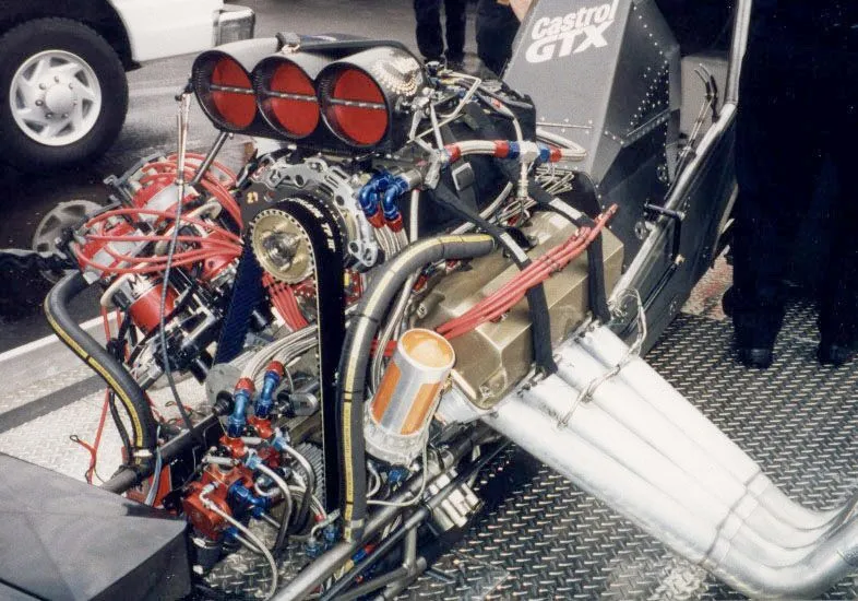

Motorcraft FLA1 and Conventional 10w30 Castrol is what I've always run. John Force uses it in his Mustang so its gotta be good enough for me!
Thats what I run as well.
FL1A is rumored to be a Purolator PureONE filter in a conventional case...so I sometimes get those if they are on sale or part of the oil change deals when AZ bundles it with the 5 qt jug
ford filter fit in quiet few different make too, I use FL1A on my jeep 4.0 :rlaugh:
I agree with what you're saying, I do hate to tell you that John force definitely doesn't use a Ford filter...
