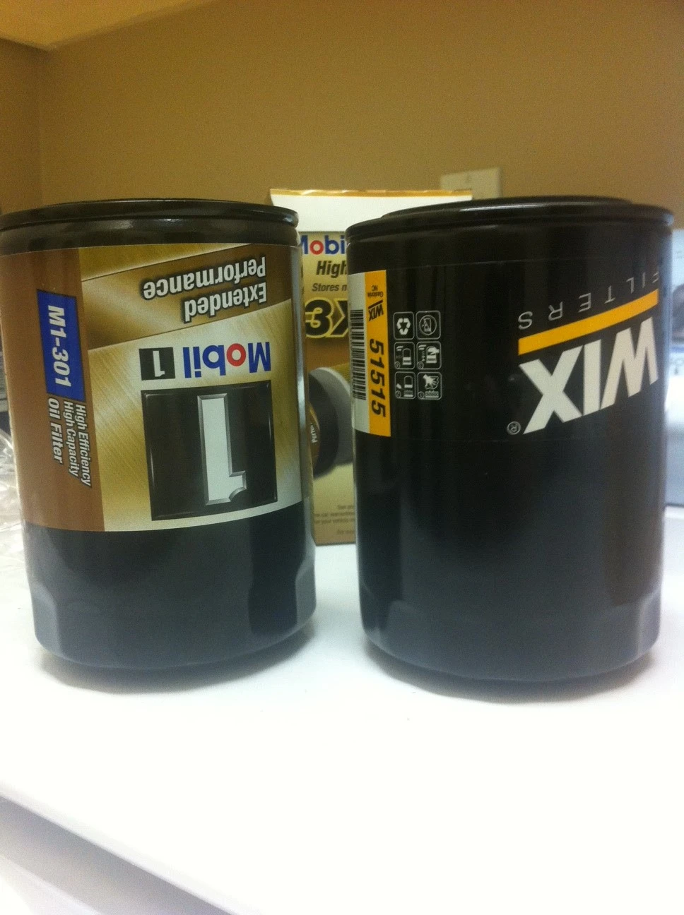

I had few filter for the mustang 5.0 left on the shelf right now ( I had problem in the past where, I hoarder oil and filter ), anyway wix and mobil 1 , mobil 1 is ALOT heavy and very sturdy/tanky filter ( 12k miles oil change rating ), where wix is more for 6k miles oil change, wix will be on the 89 LX tomorrow ( might as well use all up, i dont like storage oil filter any more ), all my mustang 5.0 is running FL1A for rest of it life, I like the idea of going to walmart pick up 10w30 oil and turn around pick up FL1a and walk out the door ( 20 buck oil change, good for 5k miles or 4-6 month ). Here the pix of the wix and mobil 1 for the 5.0
My dd Volvo has 245,000 miles. I've used a WIX filter and Mobil1 full synth for the last 200,000 miles. Recently switched to their extended interval and now I get a lifter tap when cold. I guess that's why I ususally don't switch from something that's been working fine
