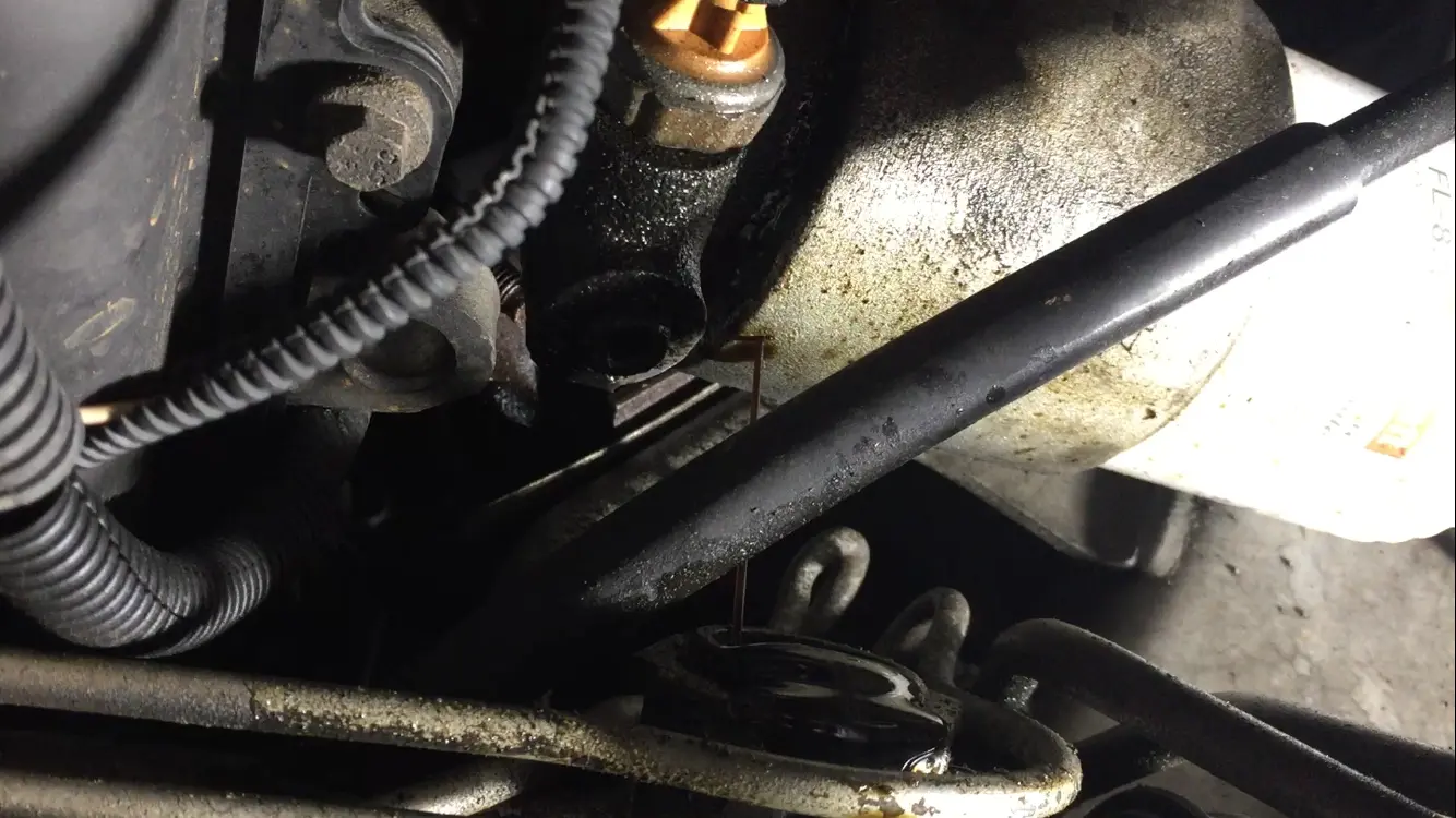

After sitting for about 2 months, I fired my 2001 Cobra up yesterday. Backed it out of the shop and noticed a huge trail of oil. Upon further inspection, it’s pouring out of a pin hole on the cast aluminum housing. I’ve googled it and got no solid answers but a few posts suggested that this hole is a weep hole. Either way, how do I remedy this? Car has 55k original miles and I can post a video if necessary. Thanks

these are rebuild able..
there was complete steps and part numbers in the how to do section on svtperformance
due to format change pics are lost but story and parts still are there.
it will link you to complete oring and gasket kit..
how to repair leaking oil cooler/svtperformance ...should work to searcj
