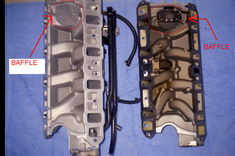

oh sorry, I thought you were talking about the pcv screen. The baffle is what goes under it to keep oil from getting sucked up...it's pretty much just a seperator.
If I'm not mistaken, if u are gonna do breathers then U'd have one in the valve cover and one in the pcv area....someone correct me if I'm wrong on this.
It's that little piece of metal.
i should be able to see it with a light right? Seems really low i wont get it confised with the block?
Edit-
Wait wouldn't the screen fall tru without the baffle?
you shouldn't get it confused with the block. Just feel around. If ur finger goes in about 1/4 to 1/2 (might be a tad bit more)of an inch in and stops then I'd say you have a baffle on there.
and using a flashlight I'd say you should be able to ID it...I've never looked at it with the intake on the block though.
I love the picture of the baffle.. that's exactly what it looks like. Pretty dang small. Now compare it to the one on the stock lower intake. The stock one stretches about halfway down the length of the lower intake. Now it's evident where the oil is being sucked through at.
