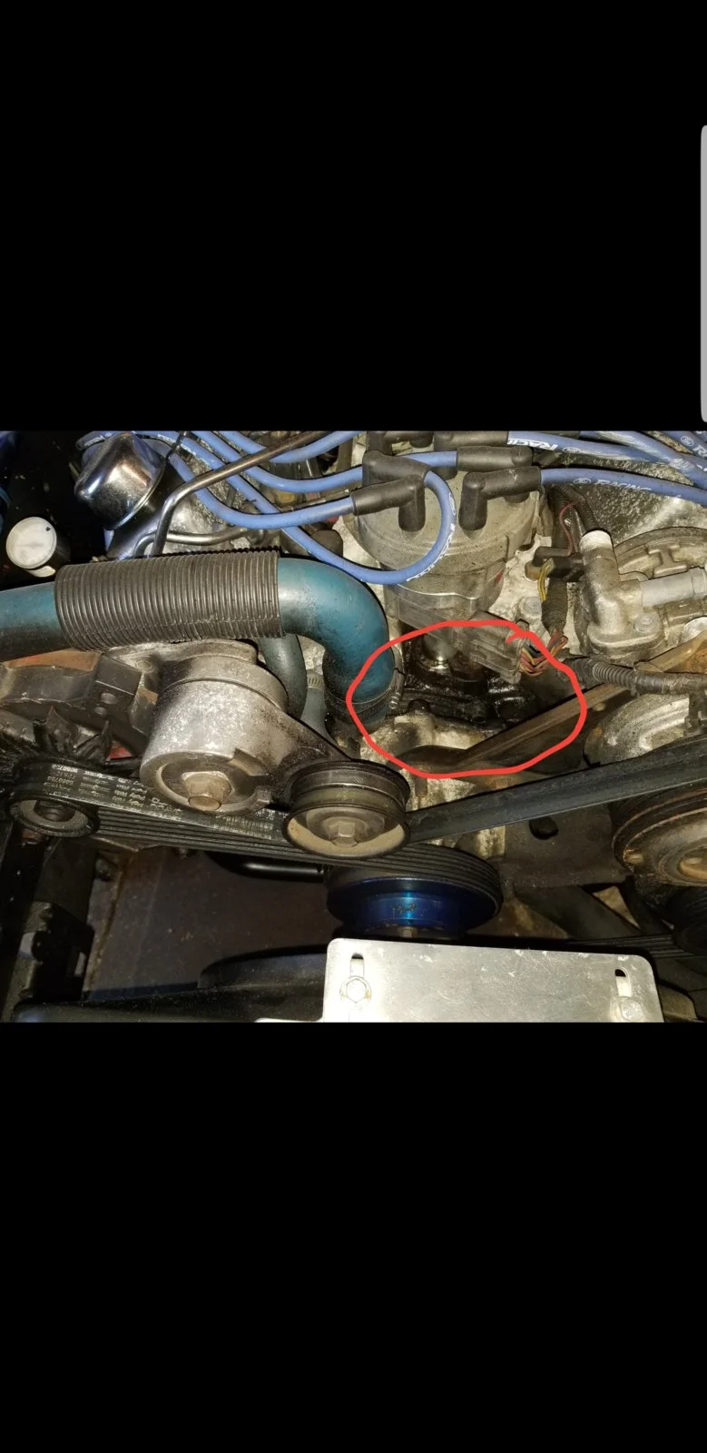

Novice here , getting oil spray all over I'm guessing from oil hitting belts, noticed it puddling up behind water pump? Is that a hard gasket to change?

Not that easy to answer, it could be as easy as the o ring on the distributor (doubtful) or the timing cover leaking, more likely the front of the intake manifold gasket has dried up, what are we working on and how many miles?

91 lx 5.0 302 , no idea on the mileage of the motor bought the car few years ago , have not been using it because oil is making a mess

Your PCV filter could be clogged. The resultant crankcase pressure could be blowing out the cork gaskets if they're still the originals. This was the case with my '90 Grand Marquis. The engine was covered in caked on dirt and oil (valve covers, timing cover, front accessories, etc.). The filter was completely clogged and came out in pieces.

You will need to clean all that gunk off as best you can then plan on replacing timing cover, valve cover, intake gaskets and replacing the pcv valve amd the screen under it, hopefully you will not need oil pan gasket and rear main seal but likely you will,
Be prepared to replace the water pump/timing cover bolts, they are know to break.
Vacuum lines probably will need replacement too.

I wouldn't go ripping eveyrthing a part right away unless your upgrading stuff. I personally would clean that area off completley with simple green, degreaser etc and run the car. Locate where the oil is coming from then figured out what needs to be tackled.

That's why I'm thinking of going with a crate engine because I have no knowledge of what was done to this motor or how old anything is , just wanna do things right and not spend a fortune on paying to do all gsskets especially rear seal and oil.pan

Regardless of what's been done to the engine,...fixing an oil leak is gonna be cheaper than spending a fortune buying a crate engine. Any competent mechanic can fix a rear main seal leak in a day,..and tell you how healthy the engine is before you spend a dime doing that.
What's the point of asking for advice when you've made your mind up anyway?

I've gone the wrong way before with spending money on my cars , I'm gonna try and tackle some of the gaskets myself , it's not the rear main seal most of the oil is puddle behind the water pump
