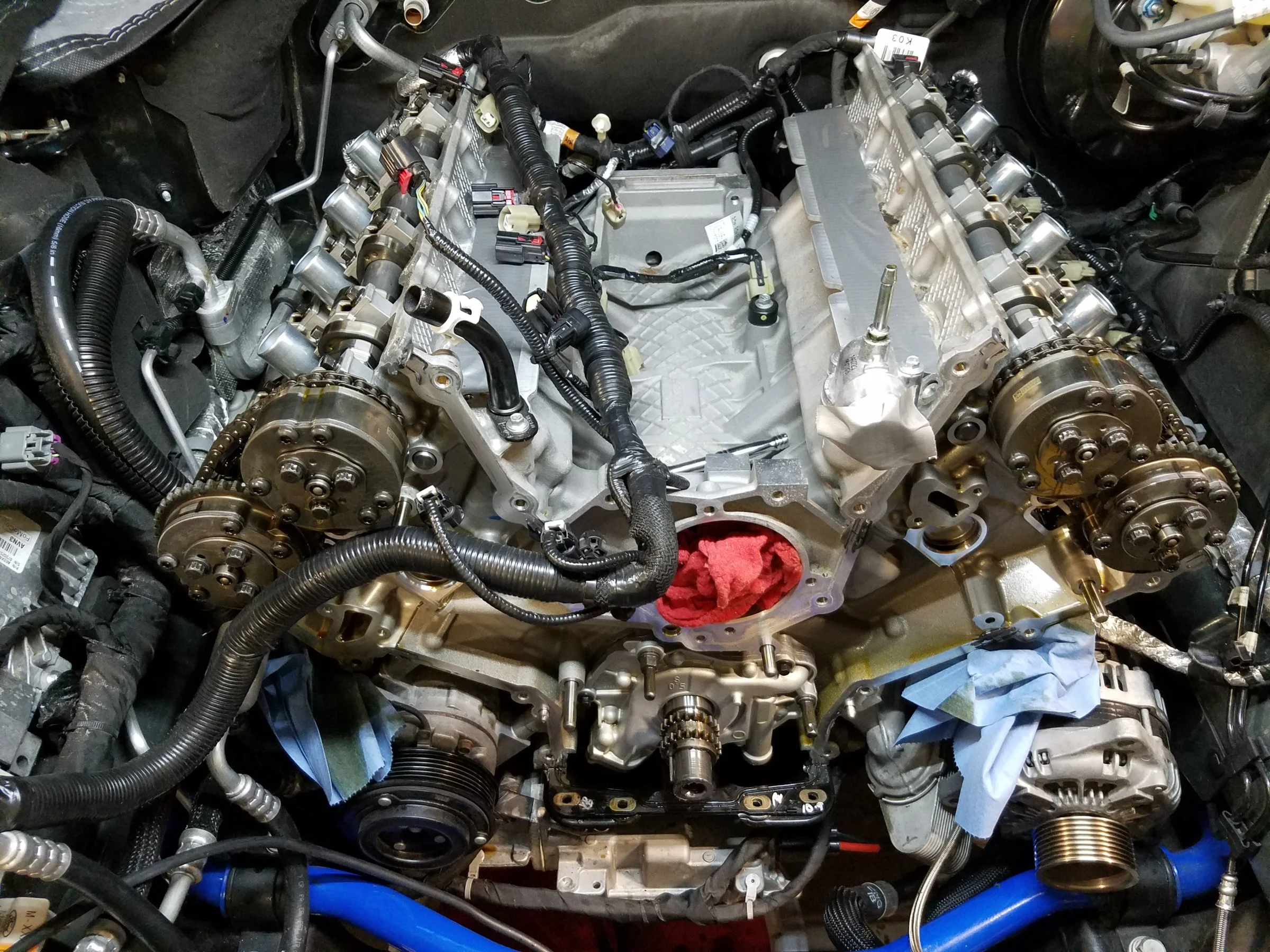

No way! It's about 600$ in parts and the motor will be solid as a rock afterwards. The crate motors for the most part still have the same Achilles heel with the sprocket. If you're doing headers and all that at the same time it will cut down on some of the labor. Honestly, the oil pump pickup tube bolts are the hardest ones to get to.
In the picture you can see the sprocket that is on the crank snout, you can also see the pick up tube bolts. The top bolt is easy, the lower bolt is under the plane of the oil pan and a real PITA to get started once removed. The pump attaches with a few bolts and the gears are easy enough to swap. I wouldn't order a complete pump personally.
