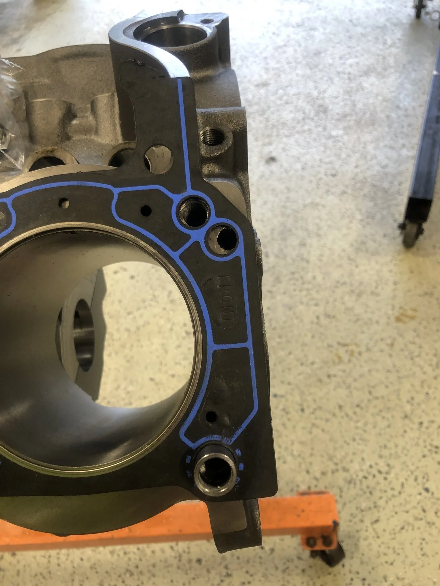

ebowie 5 Year Member Oct 16, 2018 30 1 18 Okee Wisconsin Aug 28, 2022 #1 Aug 28, 2022 #1 The front oil return hole does not line up with my gasket on my new Dart block. My old stock block was like this too, is it normal to be machined like this. Attachments Oil return hole.webp 189.9 KB · Views: 127
OldManRiver Active Member Feb 14, 2015 238 131 53 Central Wisconsin Aug 28, 2022 #2 Aug 28, 2022 #2 Seems normal.I always scribe the hole using the gasket then funnel the hole down with a carbide burr.
