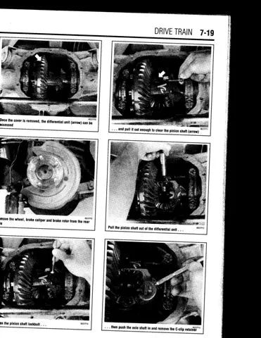

the reason i ask is i see in your post where you removed the bolt on the carrier but you don't say anything about removing the rear axle shaft retaining c clip holding the axle inside the housing.
this is not the best picture but if you have a printer it should print fine...

Bill, you're talking about c-clips being pulled, but they can't be until the pinion shaft is removed... He can't remove it. Thanks for reading the Chilton's to us.
Chris
ok fastdriver! i get it now in his post when he said, " i couldnt get that shaft outta there it was just stuck" i thought he was talking about the axle shaft was stuck and i was explaining how to remove pinion shaft and lockbolt and c-clamps but he was talking about the pinion shaft was stuck i never seen this happen and i was being hardheaded about reading. between your and rd's post i understand the axle shafts are not stuck because he didnt remove lockbolt,shaft and c-clips,its the pinion shaftthats stuck.....were all learning good stuff here thanks guys and forgive my misinformation.....
