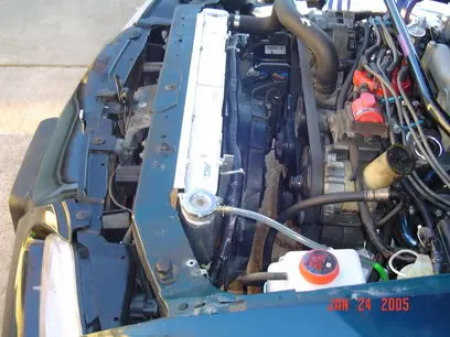

I still have the stock radiator in my h/c/i 331 with nitrous. 180 t stat...temp comes up to 180 and stays there with the high speed fan on. Havent taken it on the freeway but even beating on it it does not rise more than 185. I have however removed the ac condenser so it is getting alot more air.

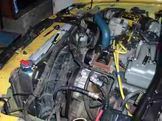

i have the summit one and i like it.
you have to trim the stock fan shroud a little to get it to fit perfect but its really easy.
some people re-use the stock top mounting brackets but i had some steel ones bent up, ill try to get pics
