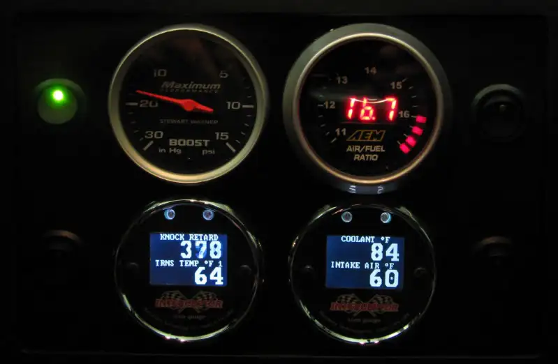

how what about a transmission temperature gauge so I can regulate the temp and if it gets too hot I can back down a bit....how hard would that be to install myself btw?
This is actually pretty important at the track with an auto. I have noticed that my car will hit the rev limiter from 1st to 2nd if I race with the transmission cold. Ideally your trans temp should be around 160 when you make a pass.
I installed some aeroforce interceptor gauges, install was very simple as they plug into your OBDII port like your tuner does. I have mine set to 4 parameters, knock sensor, trans temp, coolant temp, and intake air temp. I also have a boost gauge and wideband.
