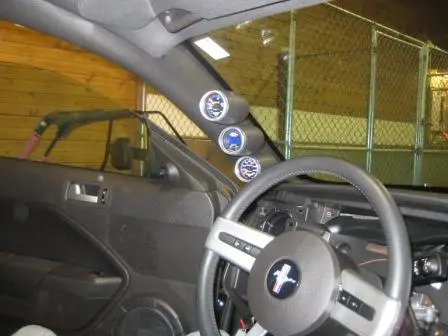

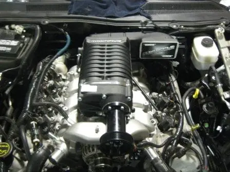

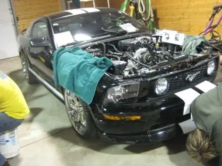

Well we have almost everything on. We have the new spark plugs in, the new injectors, the new fuel pump, the gauges, and the supercharger itself. We did have a bit of a glitch though. We actually over torqued a bolt that supported the alternator. It took us a day and a half to get the sucker out. We have to drill into the bolt and then use a reverse bit to unscrew it out. We got it but it took us a day and a half to get it out...bit of a delay. We then also had a problem with the intercooler. We have it all installed but we think we may of got the wrong hose for the thing. I'm still not 100% sure if thats correct but we think Whipple may of either gave us a wrong hose or just flat out forgot one...odd thing is though I checked to see if we had all the parts though...unless we're missing something from the install.
We other then that glitch its going good.
Heres a few pics on attachments
