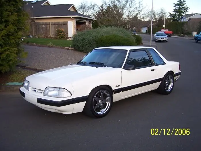

I'll be out messn around with mine this weekend i can check out my numbers on my set up and give thm to you. Here is a pic of my 93 followed by my 92 (if i have any pics of it)
93
my 92 i just cut the springs but i dont have any pics of it like that just stock heith. The one pictured has QA1 12 ways alumn bodied in the rear and the fronts are coil overs, i'll get the numbers this weekend and send them to you. My wheels are 17x8's with 245 front and 275 rears. peace
john:p
