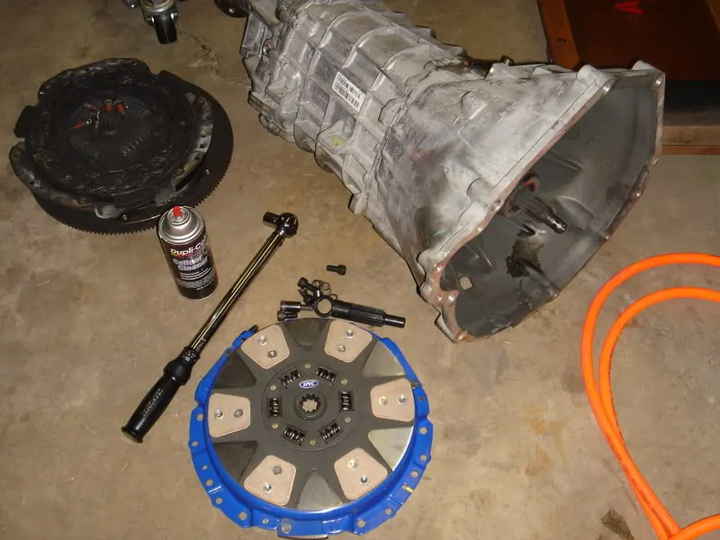

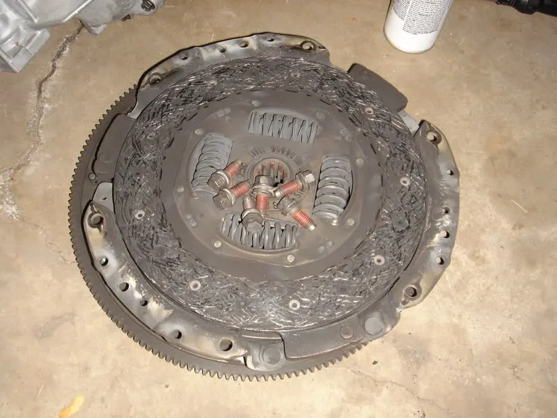

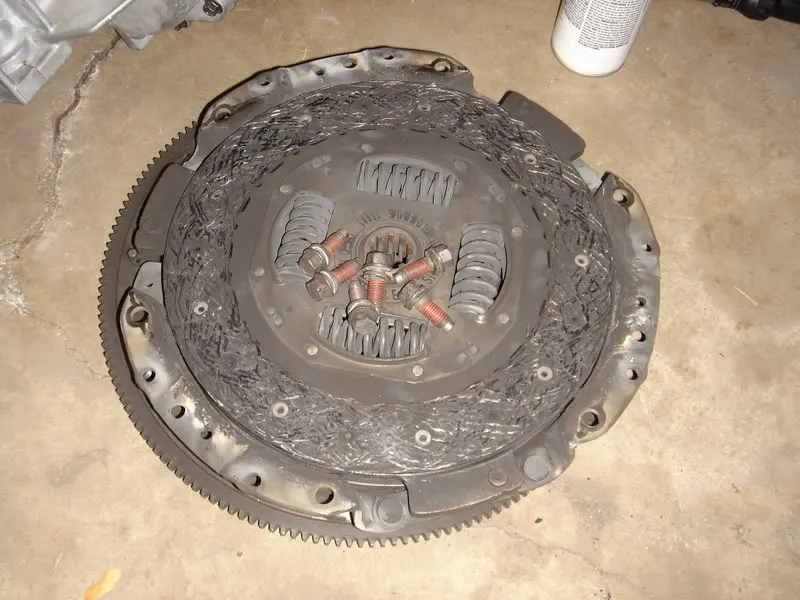

Well last night Erin and his brother Brian came over to start the removal of the old burned out clutch...the worst problem being (besides it was frickin' 20 degrees out) that with the Kenne Bell blower installed, the engine will not drop far and angle enough to remove the trans easily. The Kenne Bell buts up right to the firewall and there just isn't enough play.
Erin can probably elaborate more on this as he smashed a pinky and got a free mouthful of burnt clutch...sorry bro!
Old clutch...I'm gonna see if Ford will take this back! :D

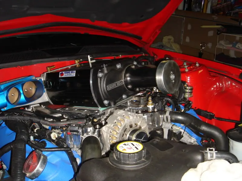

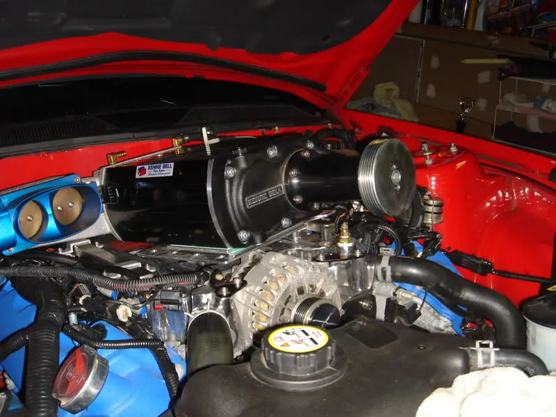

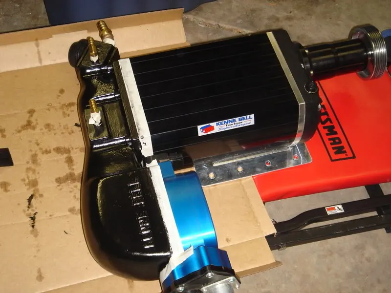

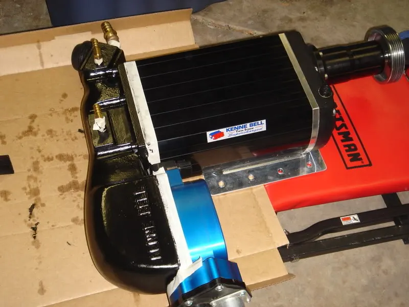

After the trans was dropped...the blower had to be removed in order to let the engine angle far enough back to be able to install the trans back. The worst part was trying to pop the blower after Erin RTV'd it from the initial install. It just didn't want to pop off and had to be pried off very carefully. It's gonna be a real pain in the ass to change the blower oil on this thing! I am very surprised Kenne Bell didn't come up with a user friendlier spot.
After Blower was pried off...

Heavy's got the overall hang up explained fairly well, the lack of angle with the KB in its installed state mean the bell housing has an extremely difficult time passing the tunnel while the input shaft fights you at the same time because the lack of space doesn't allow you off of it going rearward.
Highly suggest doing clutch when doing a KB. Not much fun installing the blower twice. It did allow me to get his newly powder coated fuel rails in though, so it's not a total waste of time.
The poor location for the blowers oil drain is going to make this removal mandatory every 10k. Not cool.

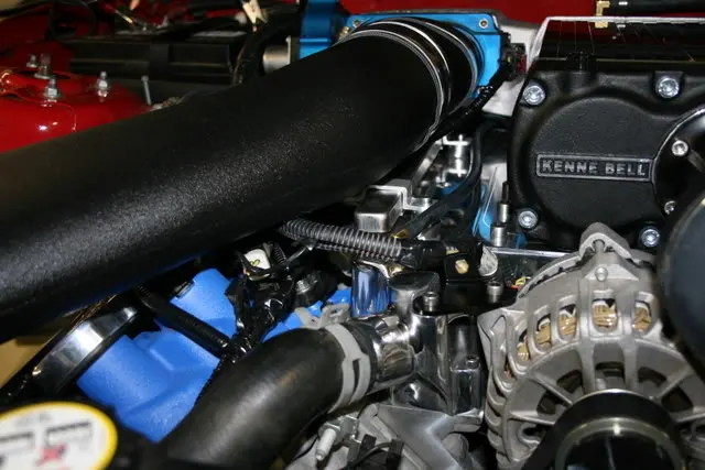

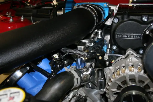

When looking head on at the blower, the drain plug is lower left below the snout. Covered by the mounting plate, which is attatched to the blower from underneath, then bolted to the main intake assembly.
Even if you cnc'd the plate, the main intake assembly it mounts to is in the way.. Also, it's packed behind the alternator, no chance in getting the plug out and even if you were a machinist, how you going to catch the fluid from that location?

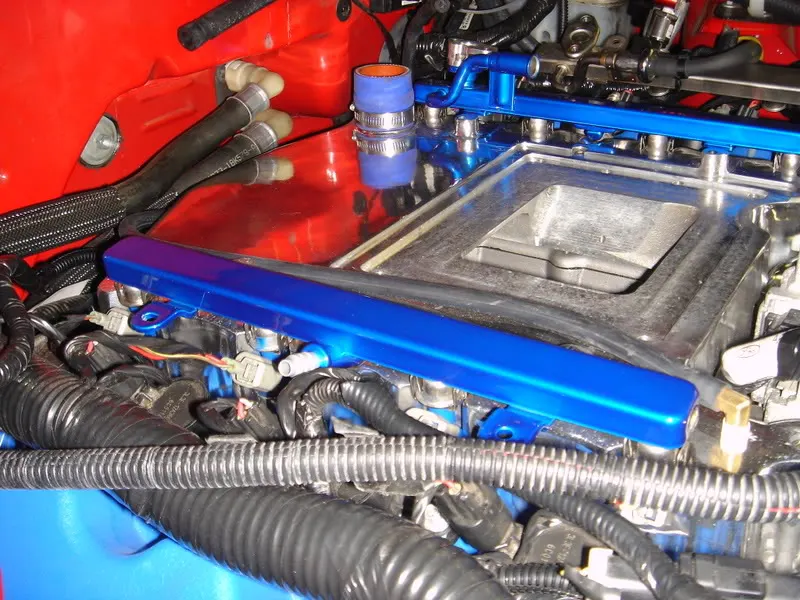

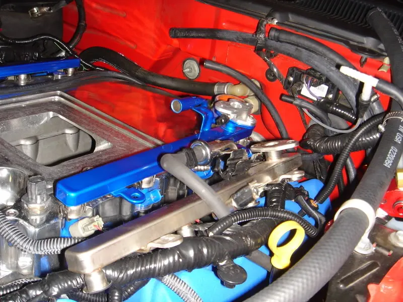

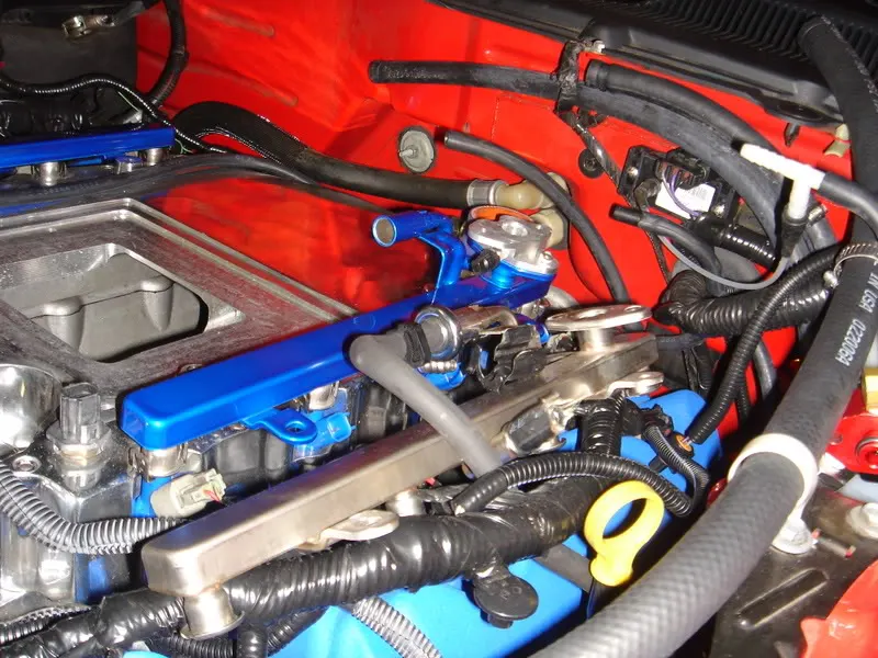

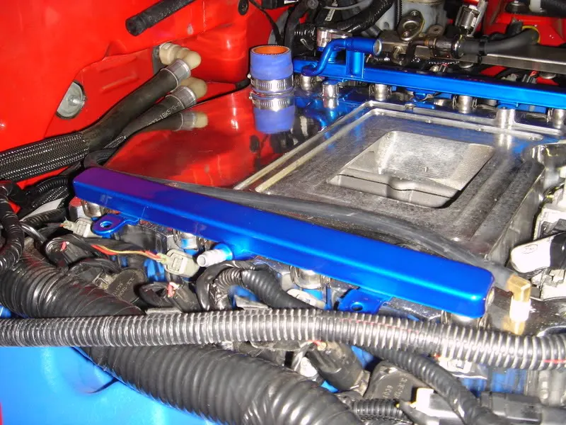

A few pics of the of the new fuel rails as Erin mentioned above.
While the Blower is out...used brake caliber paint to clean up the rear plenum inlet manifold.

Thought about it, would need to be an immediate 90 degree fitting, that is extremely short. There's less than a 1/4" space from plug exit to mounting plate. Never seen anything that short if anyone has, point me at it. I'm sure Heavy would be all for the change.. Otherwise he'll be calling me every 10k and I'm sure by now he's tired of hearing me complain about bad engineering..
Thanks for showing the drain plug emay:nice: It seems they could've put a small plug on the front of the plate:shrug: If they keep it as is, tearing it apart to change the oil every 10K miles would be about every 4 months in my case:(
The fuel rails look nice in there. I like the red, black and blue scheme:nice:

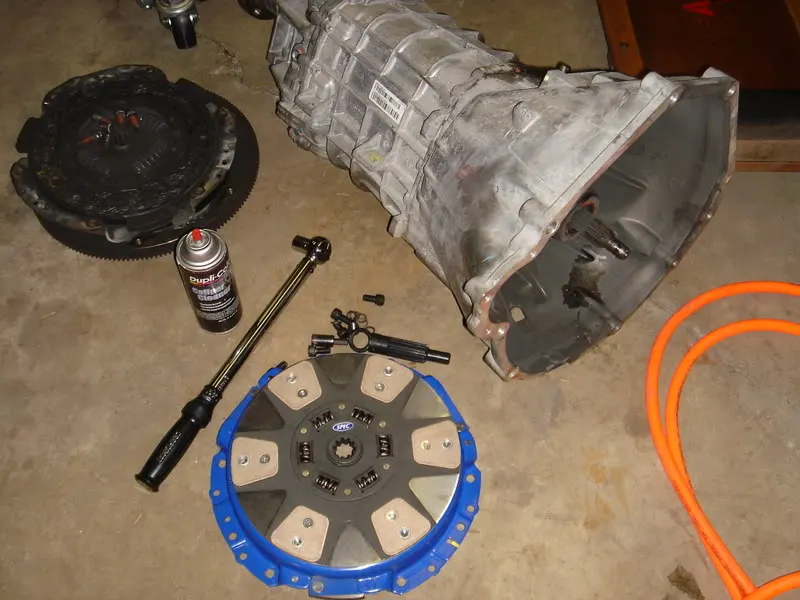

OK…the trans went back in on Thursday night (probably around 10 degrees outside). With the KB blower removed and no longer hitting the firewall, the engine could be tilted enough so that as Erin said, “It slid in like butter.” Now just waiting to bleed the clutch. Need a funky adaptor for the vacuum pump. Brian says he has one so we’ll try that Sunday night.
Another note: when purchasing a new clutch and plate, the manufacturers do not include a throw out bearing. Ford has engineered it so that it is all part of the one-piece slave cylinder assembly. Cost is about $240.00 or so. I choose not to replace mine. Just a heads-up.
