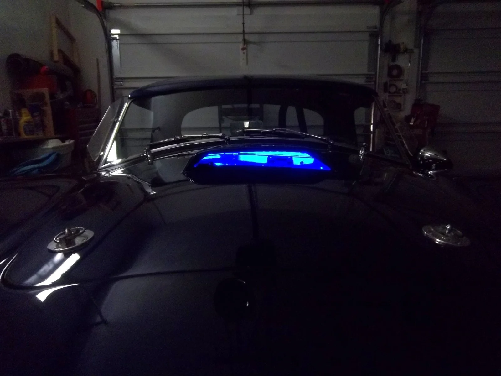

Only burning 93 no ethanol gas here.And getting a nice blue flame :) :) LOL
