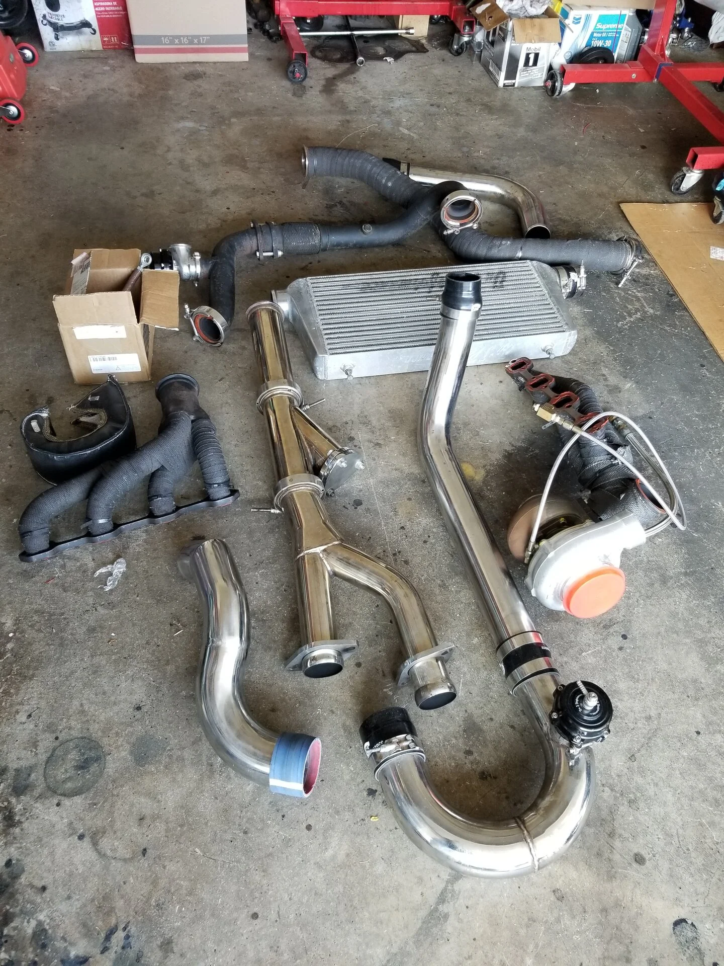

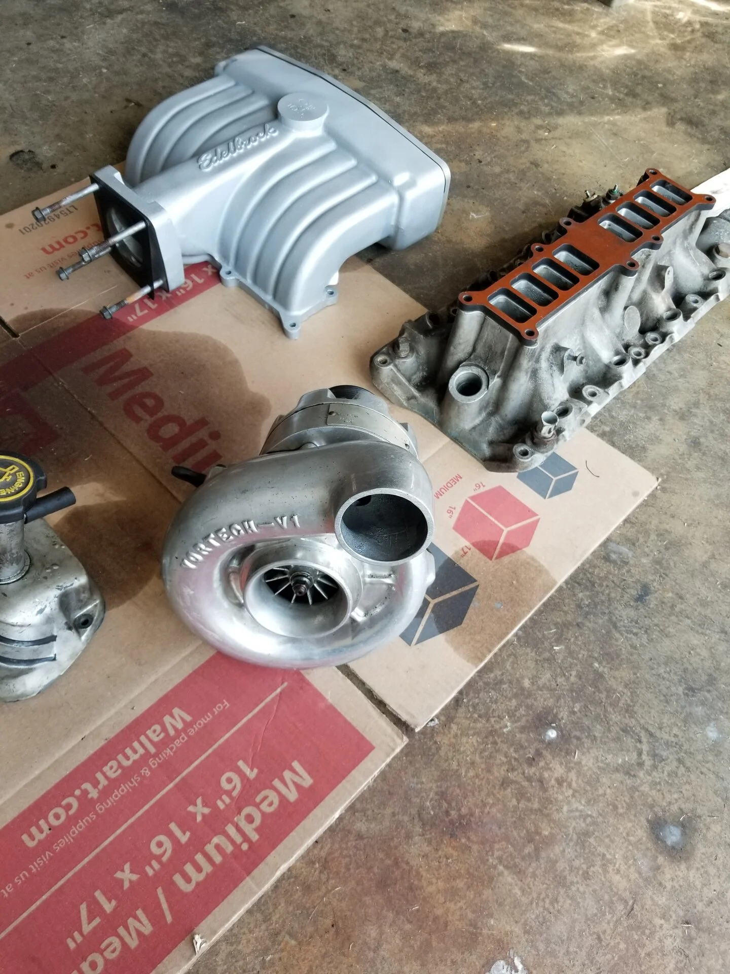

Through a lot of dealings I have ended up with an on3 turbo setup which is new. It was mocked up on an engine stand but never ran. I also just ended up getting a used Vortech V1 A trim setup (all brackets, head unit etc.) My 93 coupe has a rebuilt 306 with all forged lower end and TFS 11R heads. I run a megasquirt Pimp XS system on the car. This is just a cruiser, no racing. I'm torn on which setup to use. The turbo is nice but would involve more fab type work than the Vortech. Any suggestions?

my 2 cents I’ve run both, and I can honestly say I‘m enjoying the turbo more, I agree the Vortech is a much easier install practically zero modifications, the on3 kit wasnt too difficult to install I would consider myself an average to below average mechanic and I was able to install the kit on my own.
slow84 makes some valid points, however I don’t agree with the “no longer reliable” that’s simply not true I drove my car daily over the summer in 90degree weather and put more miles on any stang I’ve owned in the last 20years. A properly tuned car makes all the difference.
either Way they would both be a blast to drive.
That on3 will make 60- 100 more hp then the a trim with probably close to the same boost level and way cooler inlet temps. I had one . Its vortechs oldest blower. They are super reliable but they are little heat machines. IF it were an s trim id say put it on. I made 435 at 7.5 with a systemax, tfs1 cam, tfs 170s , stock bottom end with it . This is coming from someone with a ysi who is die hard vortech

Funny you should say that. Along with this a trim I got a 331 stroker, it was disassembled but all of the parts are there. Block is notched, scat crank, probe forged pistons, AFR heads....it was just a deal I couldn't pass up. The kicker is the 306 in my car I just finished building...it literally has 500 miles on it, and it was built for boost.
A trim would be decent on the 306 . Definitely wayyy to small for a 331 .
