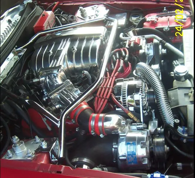

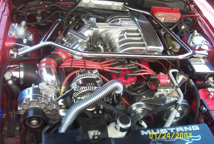

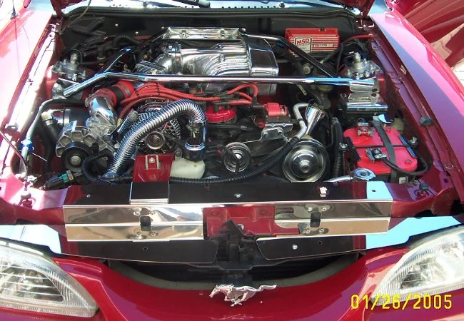

I have some AL Fox Valve covers. I have a VOrtech setup and stock heads/cam.
Do you see any reason why these FOX VC's will NOT fit?
I started polishing them.
Thanks
RC

94GTLaserRC said:
Dan, They look nice, but you didnt say if there were any fitment issues or not :shrug:
How about the filler neck?
RC
The hose nipple on the filler tube sits about 1/16 of an inch from the isc which makes it impossible to use.
The filler tube is positioned about 1.0 to 1.5 inches farther to the rear on the Fox vc.
If you can't visualize what I'm trying to describe I got a pic or two and can put them up tonight if you need em.
