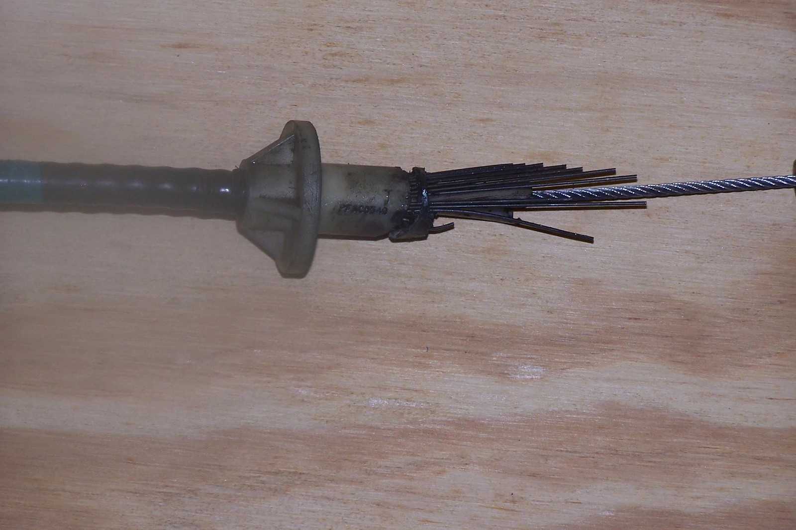

Clutch cable failure
About every 3-4 days I had to adjust the clutch cable. It seemed to lose adjustment and the transmission wouldn't go into gear. Since it was an adjustable cable, I thought that it might be stretched so I bought a replacement. Good idea, but not because the cable was stretched...
011-jpg.574708
010-jpg.574707
I have never seen a cable fail in this manner. It was a Ford Racing part, so I wasn't expecting to see this.

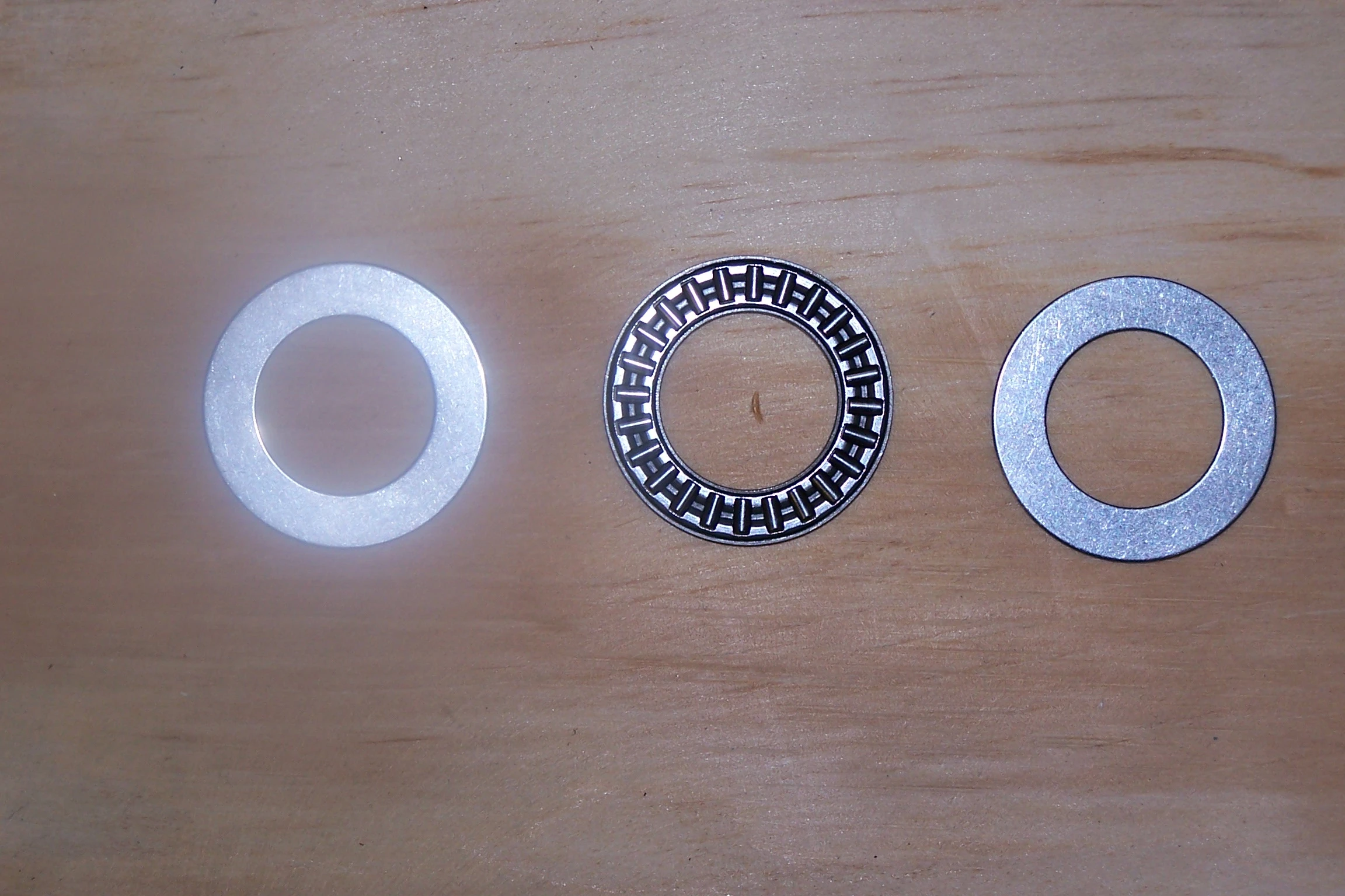

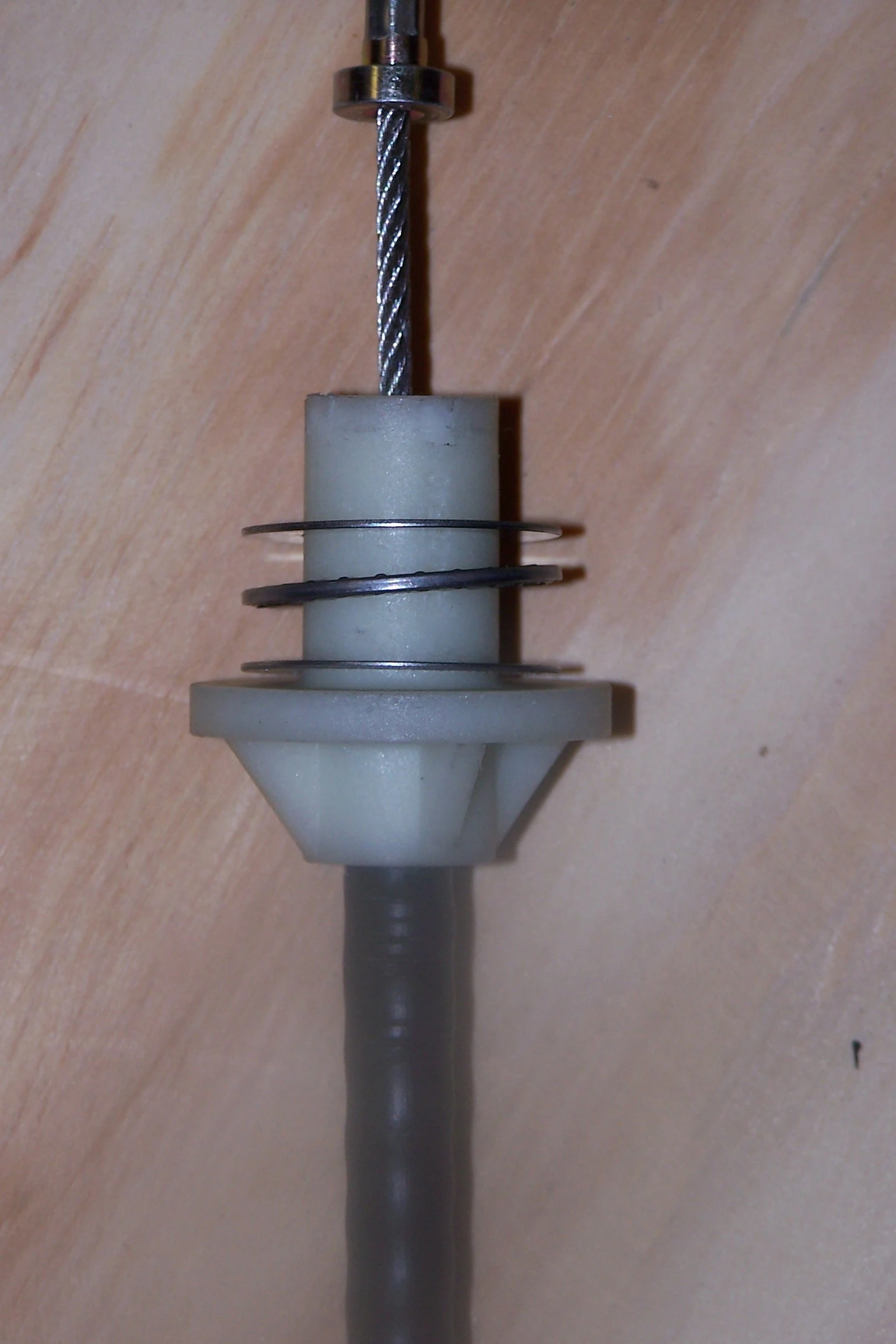

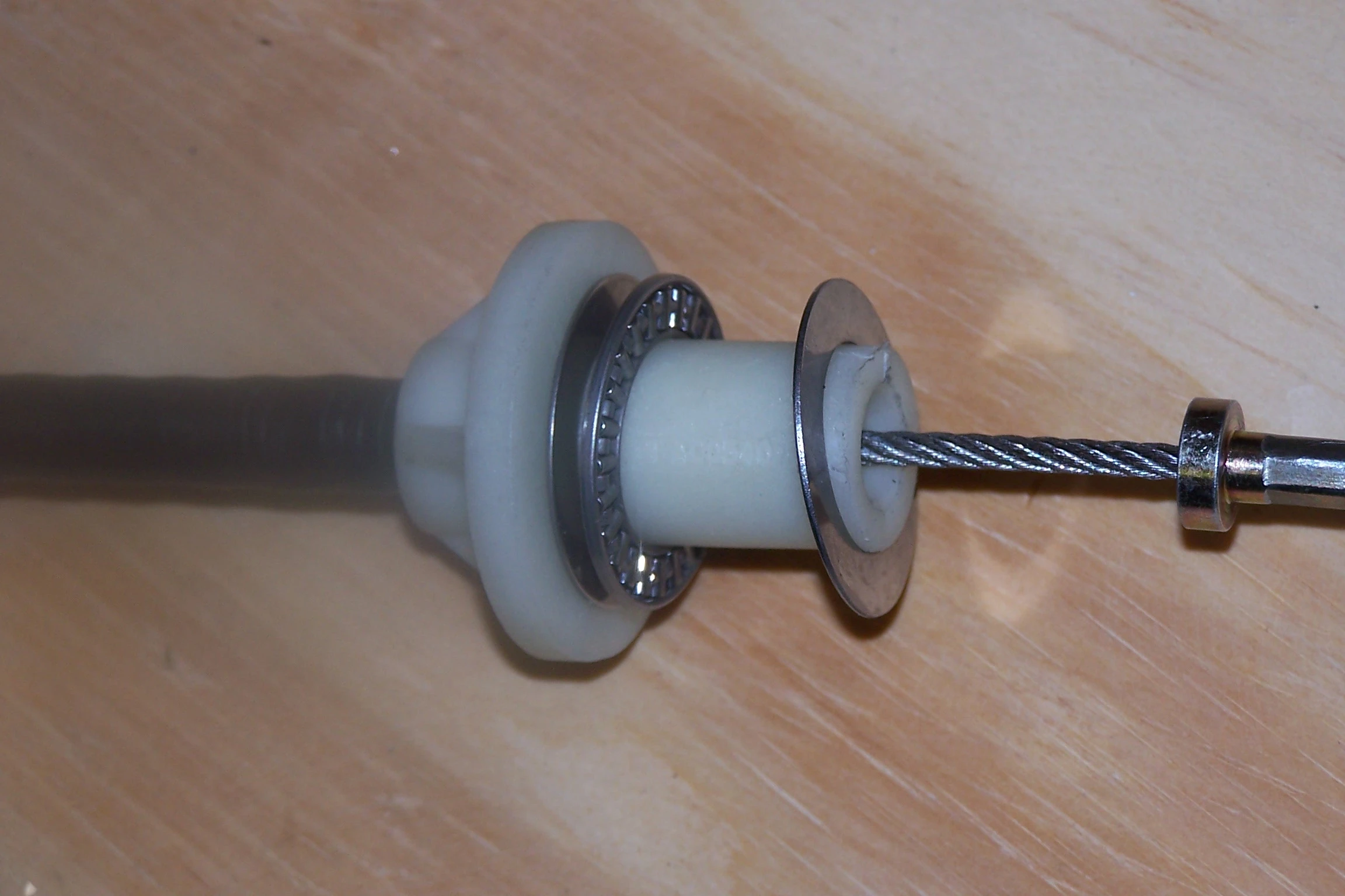

While I was at it, I fixed the problem of the firewall adjuster being difficult to turn. I added a roller thrust bearing to the adjuster. Now it is easy to turn and since the adjuster has click stops built into it, there is no worry about it moving without me turning it. It cost about $8 plus the shipping.
attachments\574702
attachments\574703
attachments\574704
Use some wheel bearing grease on the meal races where they face the bearing. Then apply some to the nylon sleeve where it fits into the adjuster. This keeps everything lubed up and moving freely when you turn the adjuster. The wheel bearing grease won't melt or wash out due to the heat and moisture in the engine compartment.
www.mscdirect.com was the source for the parts
03380920 1 each 0.750X1.250X0.078 THRUST CAGE-NEEDLE ASSEMB
03381092 2 each 0.750X1.250X0.032 THRUST WASHER-NEEDLE-FLAT
