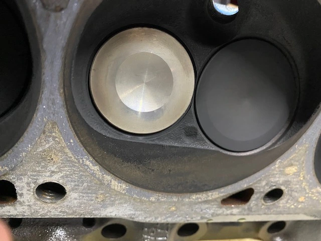

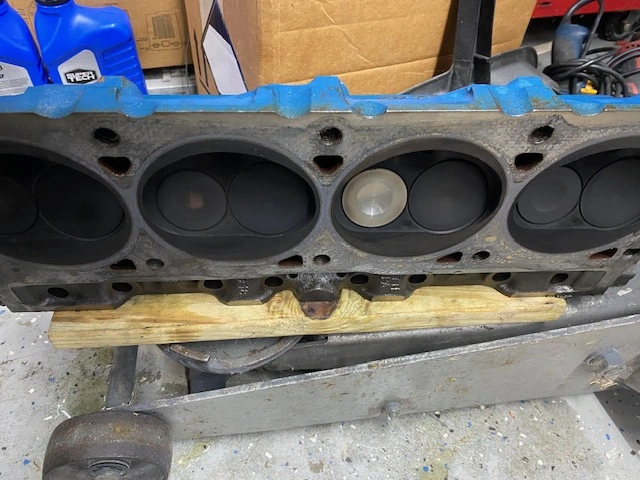

I"ve pulled the head (90 5.0 Roller, bought from Blueprint) due to a ticking noise that comes and goes, but strange to me to see 1 extremely clean valve. Would a sticky valve manifest itself like this? Do the others have too much carbon on them? Engine ran fine other than the ticking that occurred probably 70% of the time, regardless of rpm.

Or a leaky headgasket if not a cracked head allowing coolant into that cylinder which then " steam cleans" it... ??
tossing out possibilities here..
No, was a crate engine I got about 2 yrs ago. So no new valve. I saw no coolant in it, as noted it seemed to run perfectly fine, just tikked along with the rpms.
Only about 500 miles on the fresh crate engine. Head gasket looked perfect as well.

Can't imagine this to be too mysterious. but very strange. Closer pic if it helps in any way.
I've ordered a spring compressor so this weekend will take it out to see if it has an issue or not but seems as tight in as the others.
Great post AeroCoupe. I've checked the gaskets, intake and head, no signs of water leaks but makes sense. Piston seem normal like the others though. And any reason ya'll know of of why just the exhaust port is clean? Again once i get the tool this weekend i'll pull the valve to see if anything is wrong with it.
