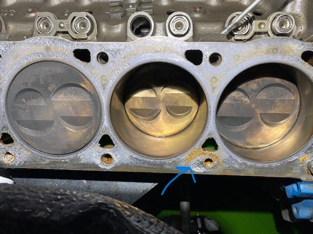

Signs of a leak.. I think I've found that. The lower head bolt between #7 and #8 cylinder. The clean valve is in the #7 hole. I dont know if thats enough of proof but is very different then the others. Gonna inspect lifters and such in more detail now.

Looks like a lack of sealer in the lower head studs or bolts.
Permatex® High Temperature Thread Sealant, 50 ML - Permatex®
www.permatex.com
Hopefully the deck cleans up because that looks like crap.

It did clean up good, Razor blade, scotchbrite and carb cleaner. All lifters/rockers/pushrods look fine. If I only knew what would tick off and on, mostly on.
Also, fwiw, with gas sitting in the head, no leaks in the valves.

If that motor is out of the car you will need to flip it upside down and hose the cylinders out with carb cleaner. Scotchbrite is known to kill motors.
