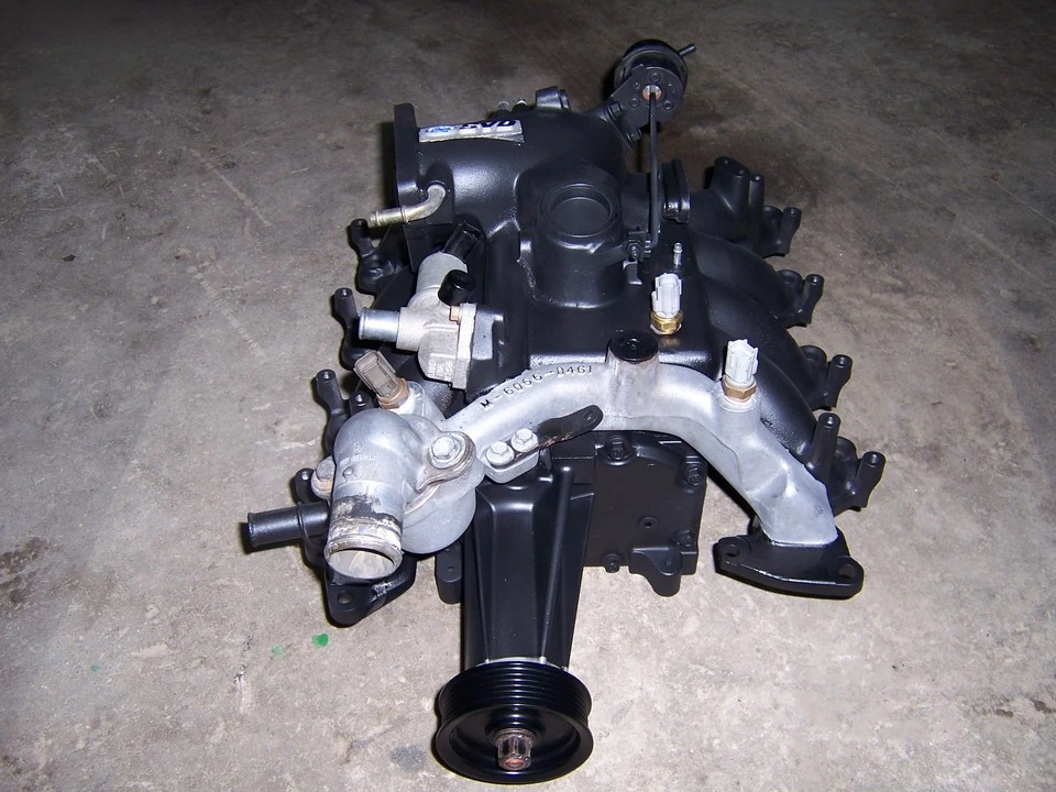

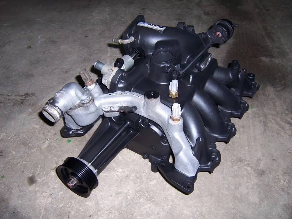

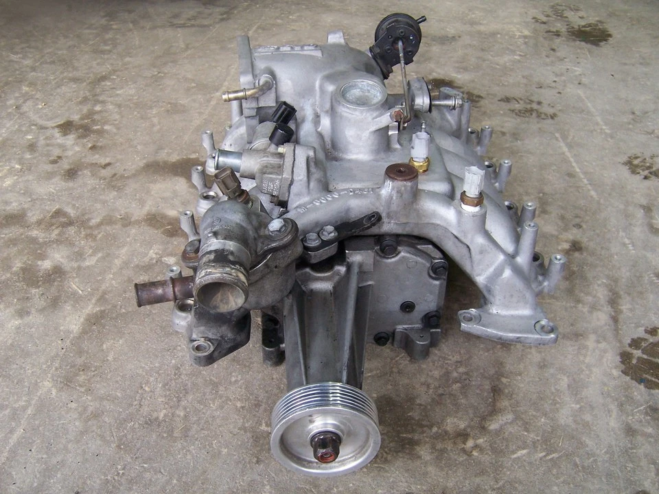

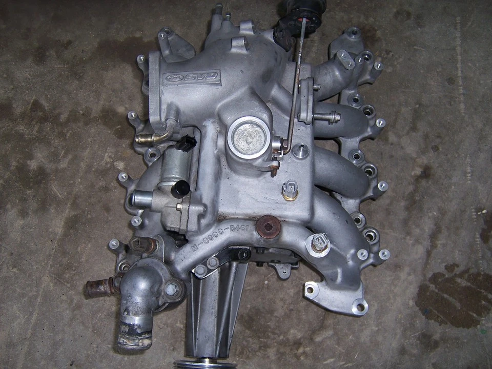

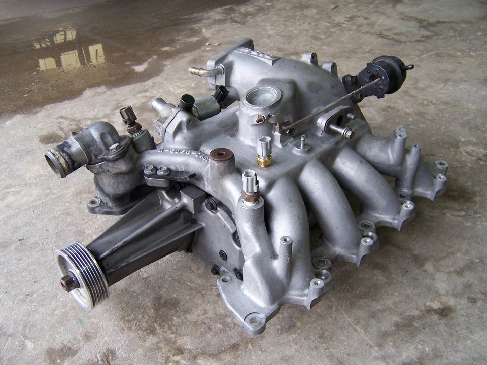

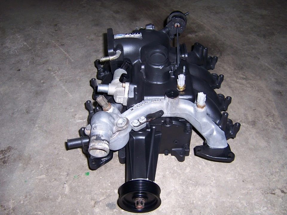

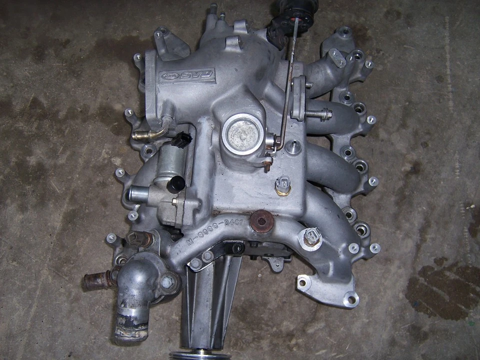

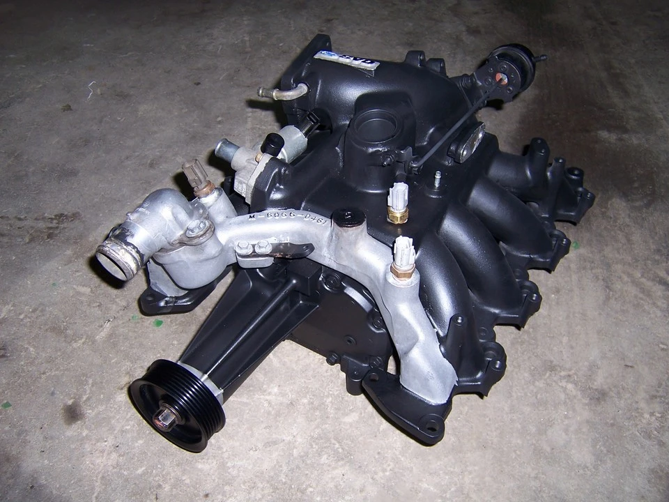

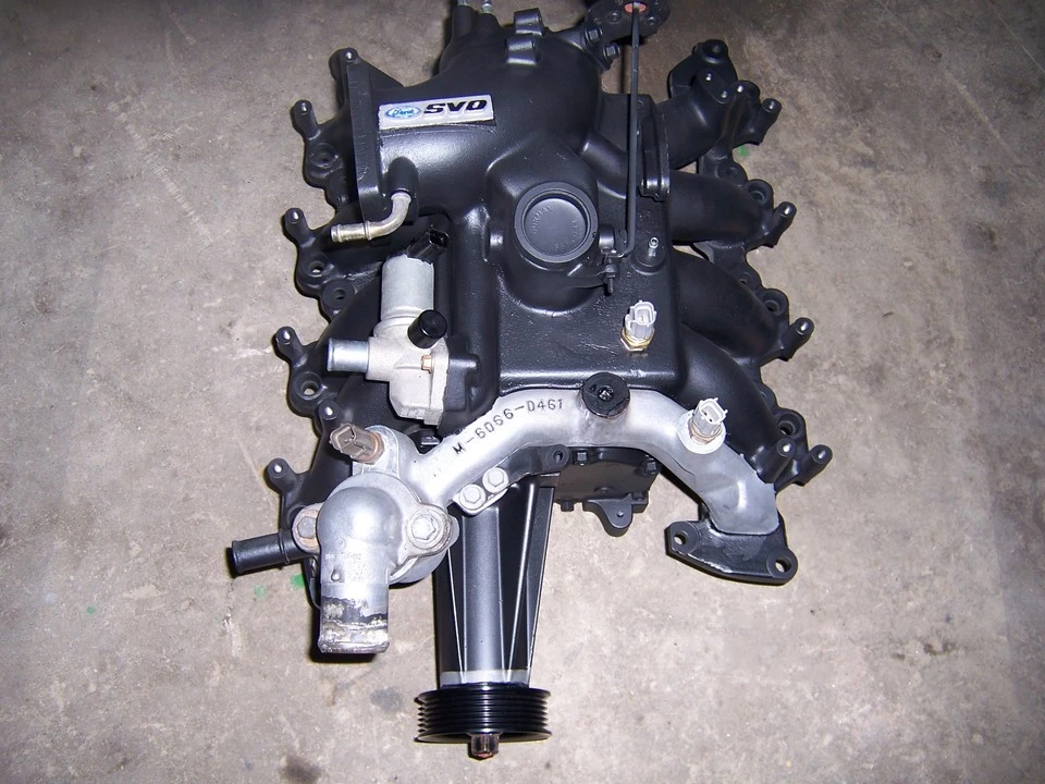

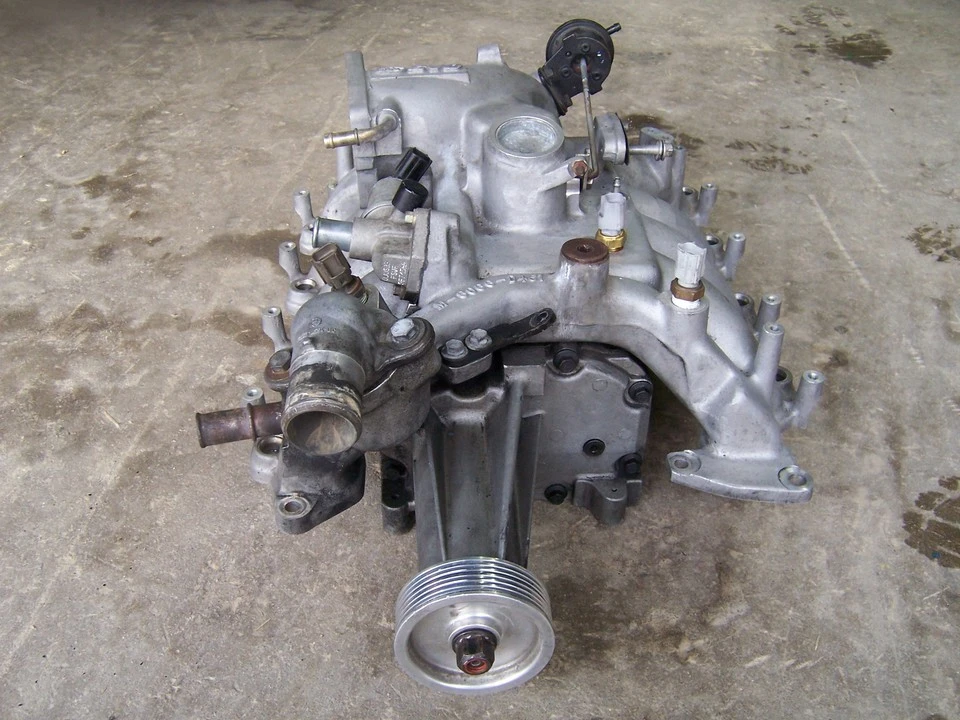

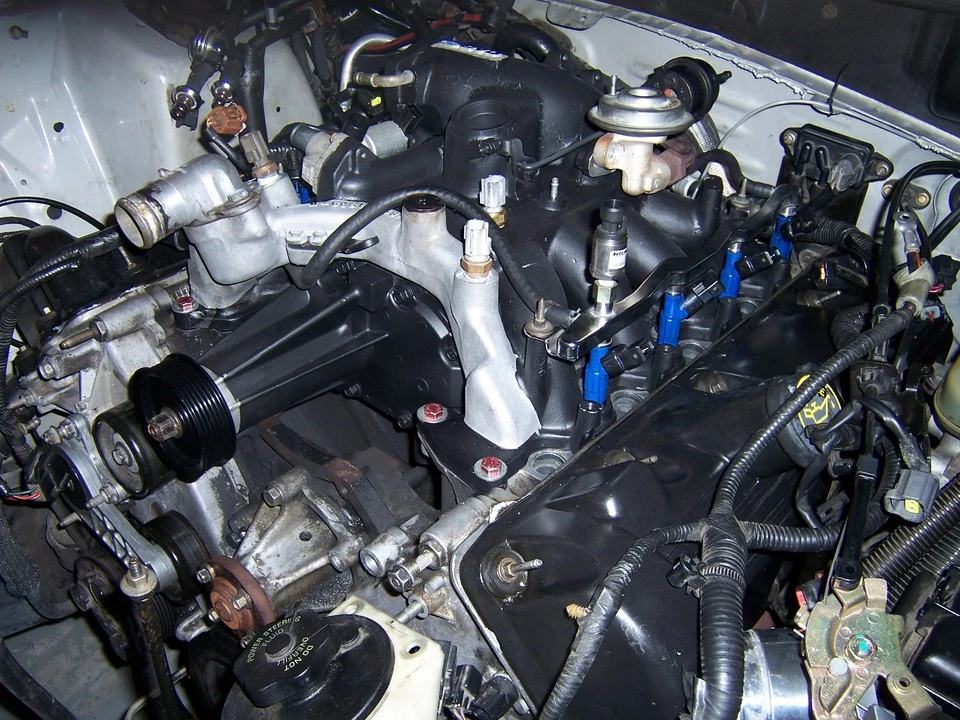

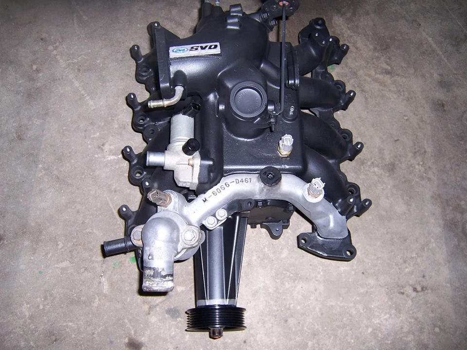

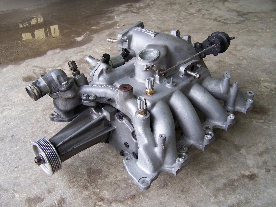

I took the blower off last week to get it tapped for a new IAT sensor. It was installed upstream of the blower, and thus couldn't correctly measure IATs. Well now it's on the blower itself and will allow for much more accurate tuning.
I spent this afternoon cleaning up the blower and painting it. I didn't really dislike the aluminum color it was, but I thought it would look better black. I was right. :D Here are some before and after pictures.
Hoping to get the cams done tomorrow and everything back together on Sunday. I'll have Pandora up on my computer in the shop all day tomorrow, so I'll try and keep teh Stangnet updated.

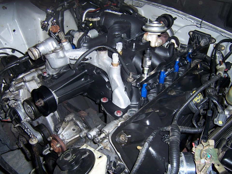

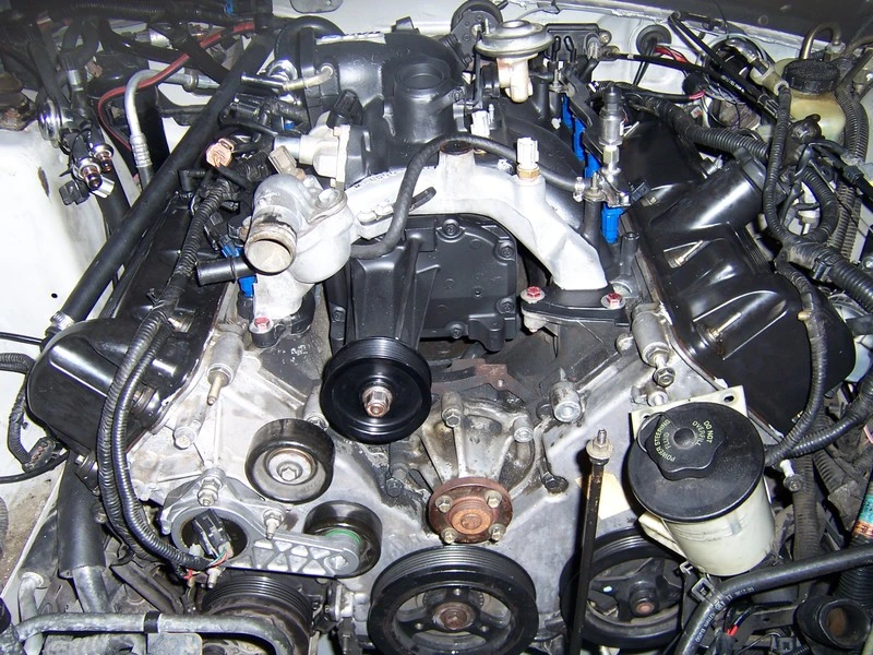

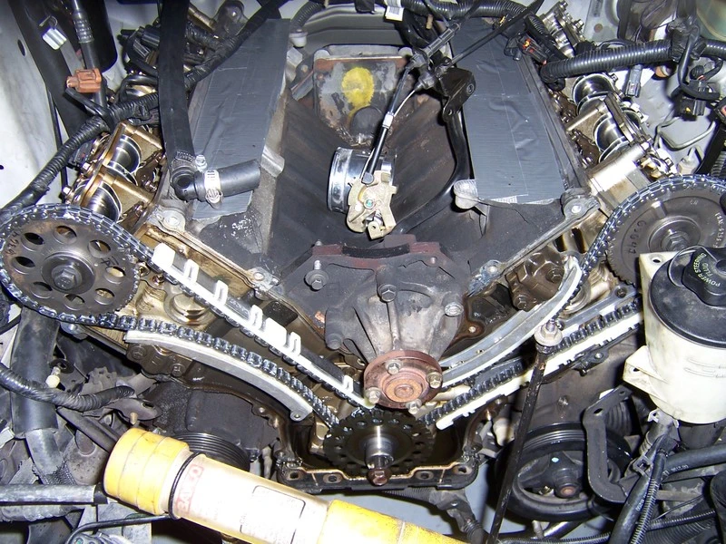

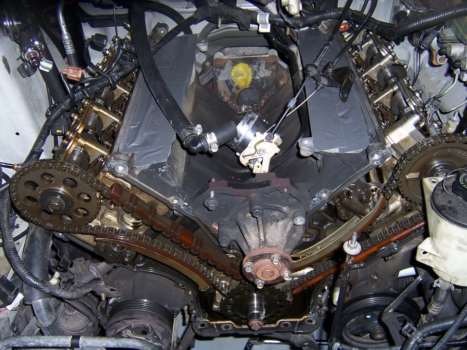

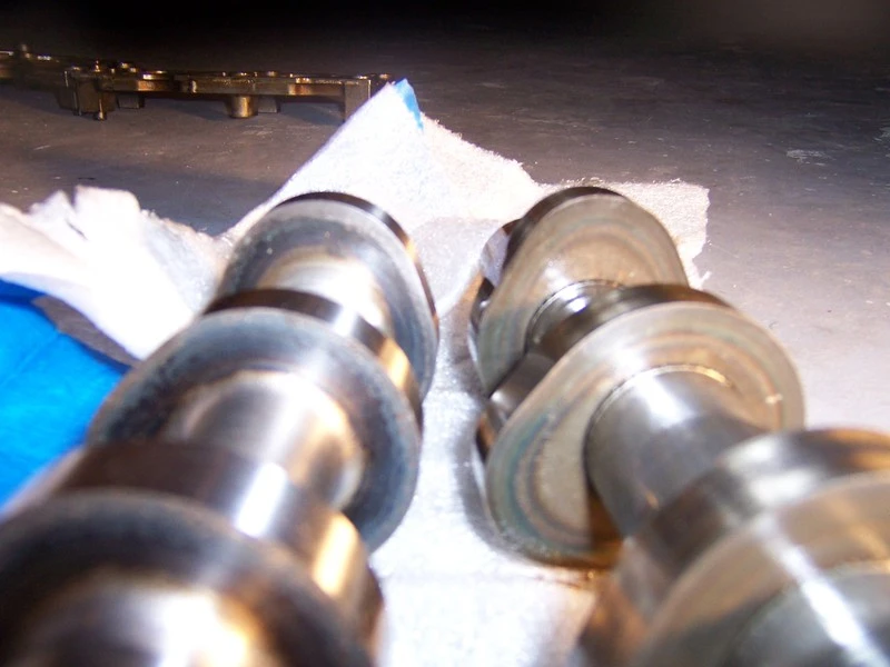

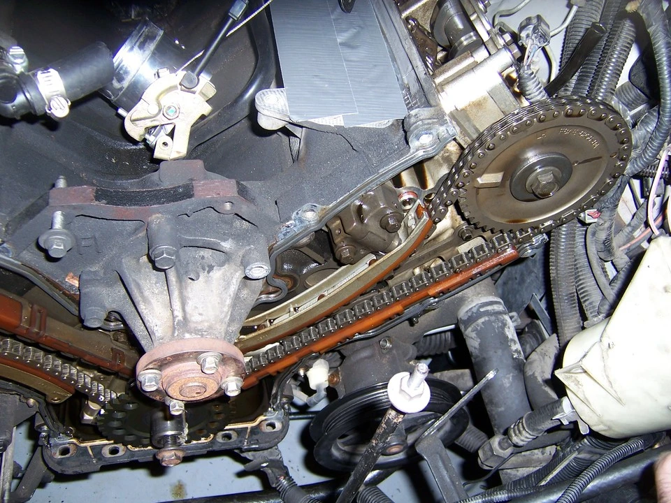

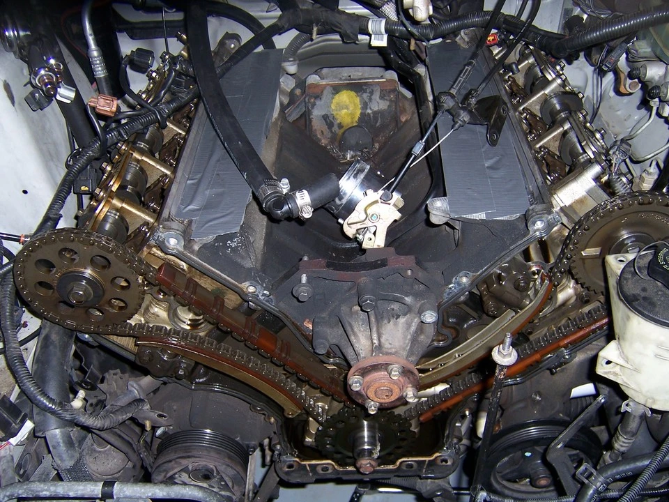

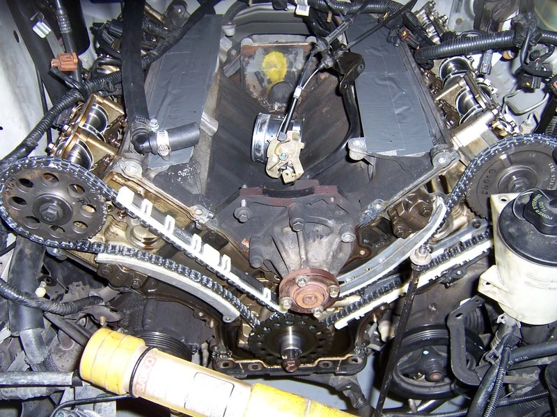

Update: got pretty much everything apart now. Got the new pulley on the blower (which was actually a big deal), and it's ready to go now.
Almost apart.
Completely apart.
My company for the night. :D

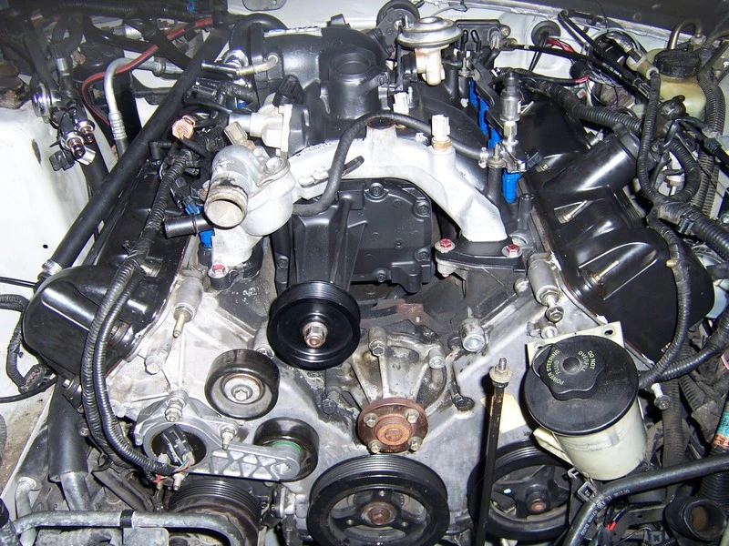

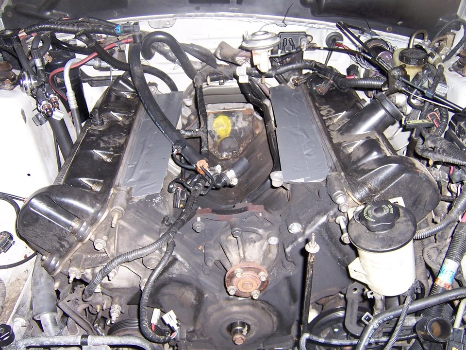

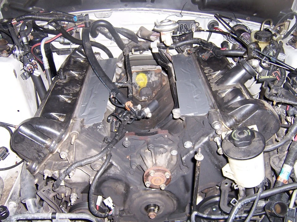

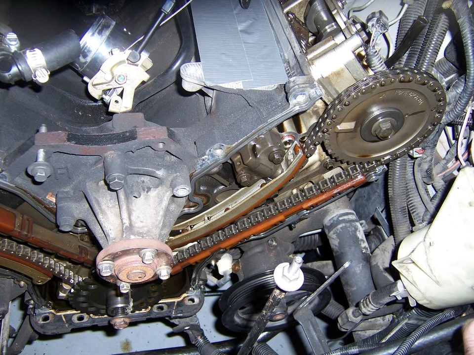

I'm expecting you to regret that duct tape on the intake ports.
Haha, I've thought about that, too. But I none of the other tape I have would stick to it. And I wasn't going to leave them open for 10 days and risk the chance of dropping a bolt down in it.

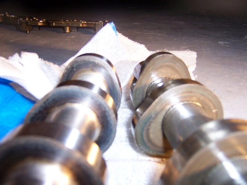

Just a little more duration. :D

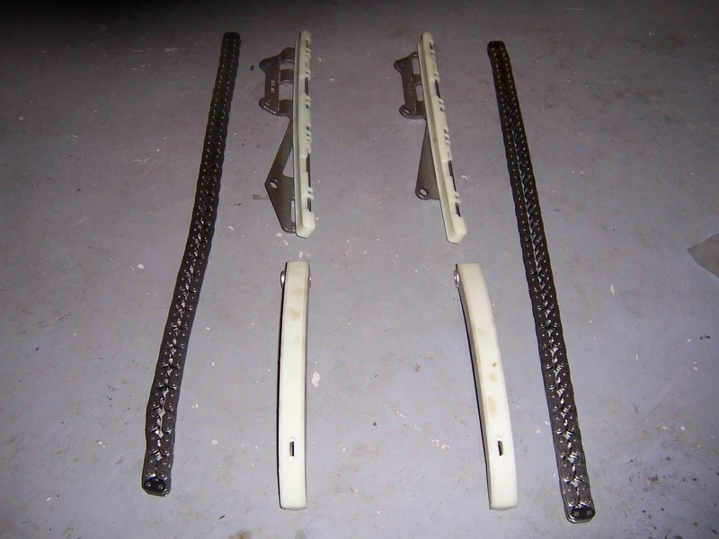

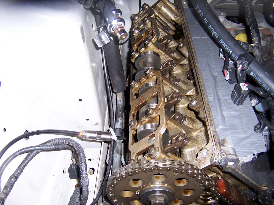

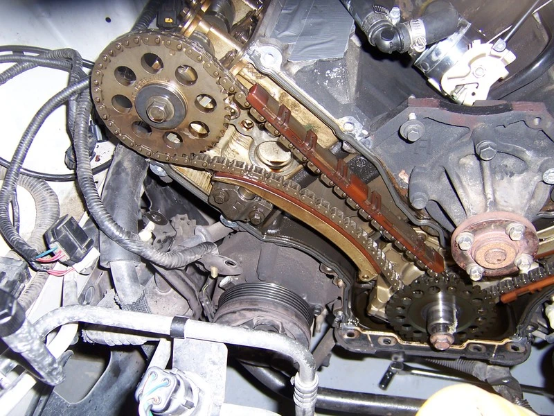

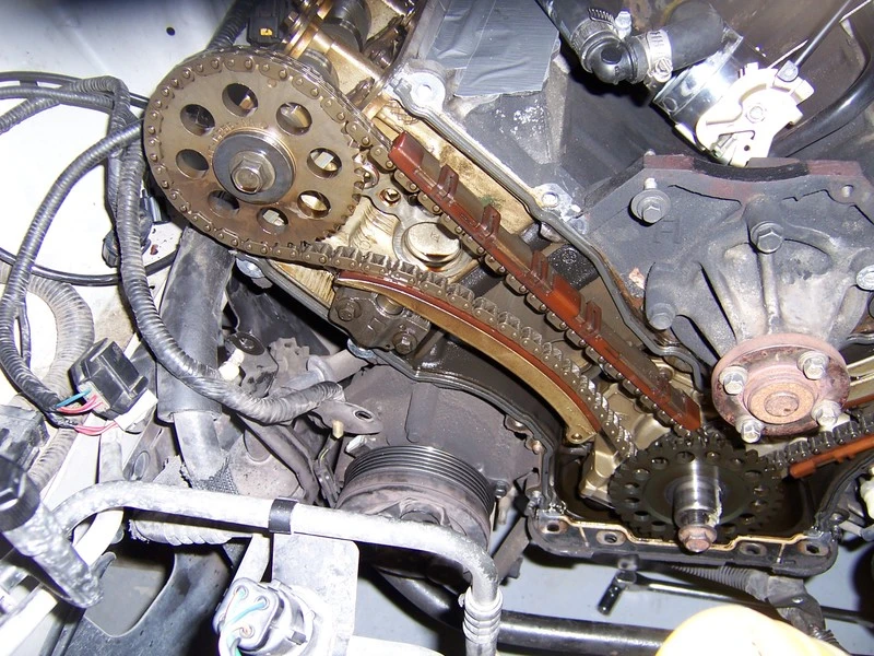

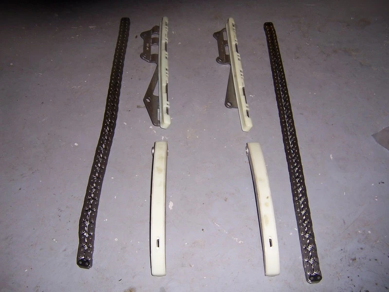

New Trickflow chains, guides, and arms.
The stock stuff looked fine, but for $150 extra and as easy as it was to change them, it was worth the peace of mind on a 120k motor.

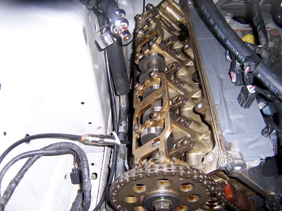

Cams and timing stuff installed.
I'm hoping that I can get everything back on and have it running by late tonight. We'll see...
