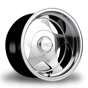

If these are the Eagles you wanted:
...they do come in a 15x7 with a 4x4.25 bolt pattern :nice:

The 15x8.5s are also available in 4x4.25. But check the backspacing on th 7.5 & 8.5s it's 5". Neither of them would work up front without spacers. But rememeber we still don't know if she's goin 5-lug or not. The 15x6s are only offered in the 5 lug patterns.
no, they were eagles that looked just like these centerlines, but I might consider those too.

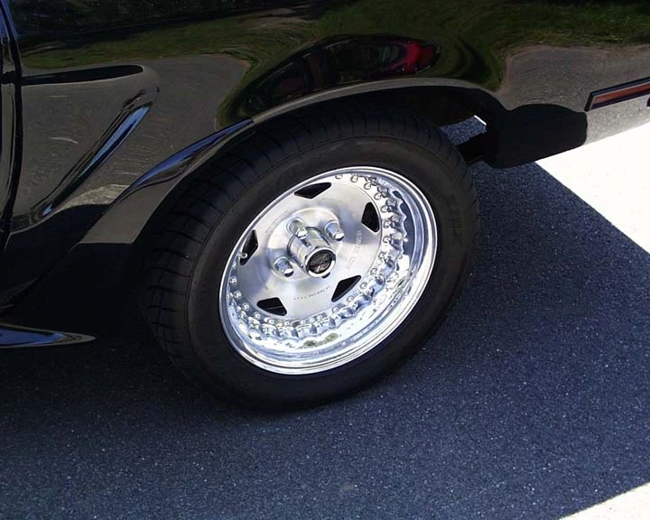

those are called convo pros. they were originally a race only wheel then were released as a street wheel. make sure you specify which version you need.
rear 15x7 3 3/8 backspacing with 235-55-15
front 15x4 1 3/4 backspacing with 185-60-15
there is a picture of my king on the first page of the members ride post
