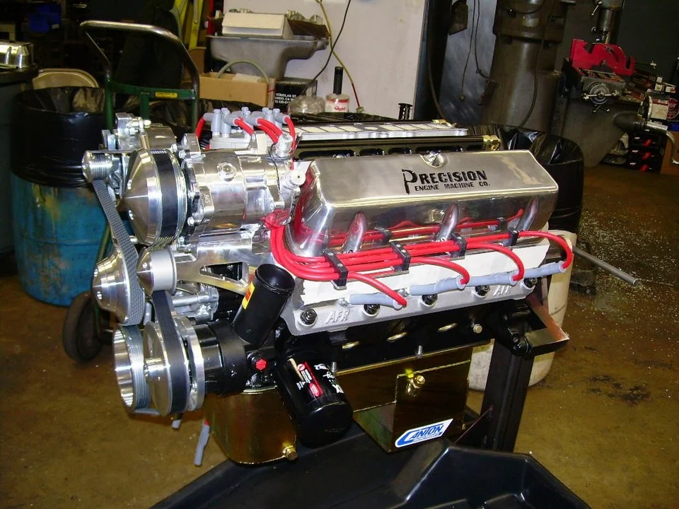

the picture in my avatar is my engine.
my motor has AFR 205 heads, comp pro magnum rockers, and accufab mid length headers. the cam is custom ground for mid range torque because mine is a 100% street car and my driving habits hardly ever take me to 5000 rpm. it is EFI, with a TwEECer tuning system that used to tune it myself. it also has a polished alternator, polished AC compressor, polished water pump, and march brackets, and a BBK 75mm throttle body.
the intake on it is currently a polished pro products typhoon, which is certain to be the biggest air flow restriction. again, mine is a street car and i was going more for bling the bang. i also have a edelbrock junior victor lower (converted for EFI) that i was planning on putting on with an intake elbow, but with the fairlane, my focus has shifted and i never got around to picking out an elbow and putting it all together. i'd throw in the jr victor.
i have never taken it to a dyno. my guess is that the torque would be through the roof from before 3000 up to 5000 rpm, but the top end numbers would probably disappoint because of the typhoon. with the other intake on there, it would most likely put down 400+ to the wheels.
i'd let it go for $5000.

Well I definatly want BlackVert's 408w so that is in the process of happening. I have a few questions though. Since the Typhoon is the restrictor for that engine eventually I will put on the jr victor he is throwing in with the deal. Where can I find the elbow for this intake? I see a lot of elbows for the 4.6 version, but im assuming these wont work. And for future plans I may want to put some boost on it so what are the things I should look at to lower the CR from 10.27:1 to 8.5:1? I know pistons, thickness of head gaskets, and bigger combustion chambers. I dont know what im looking at when it comes to aftermarket pistons and such. And could I get the combustion chambers machined to be bigger? I dont want to re-buy these expensive parts if I dont have to.
