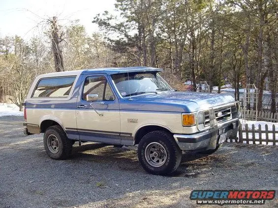

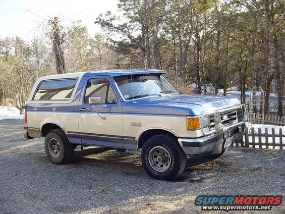

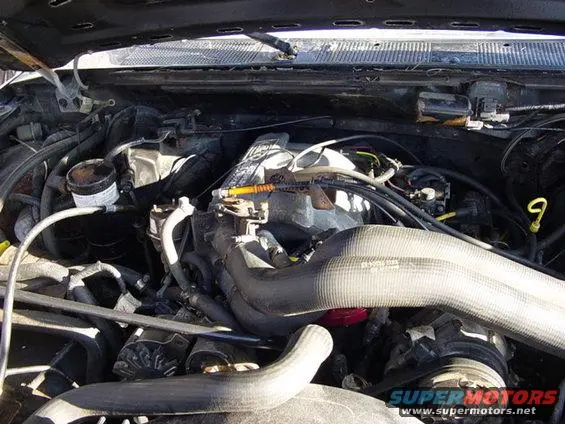

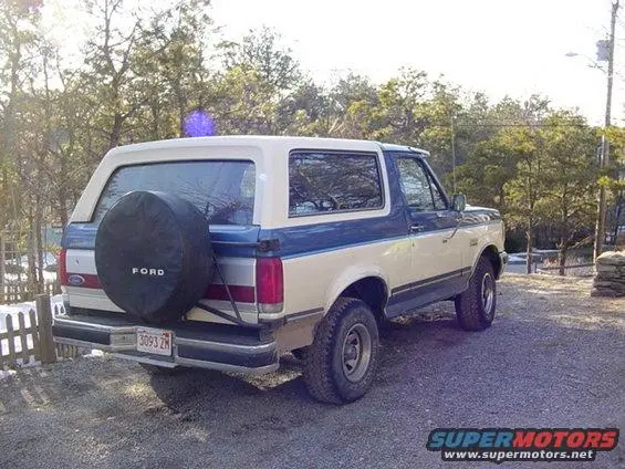

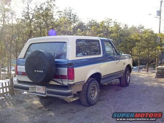

This is an 89' but the later models are really basically the same. This is what i daily drive(since my stang wont run)
5.0
AOD

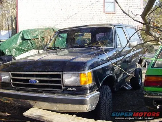

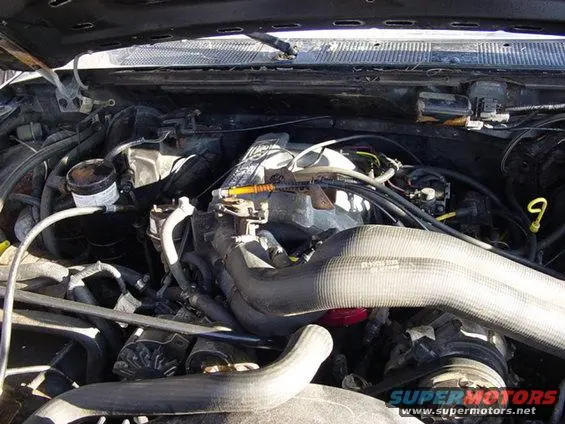

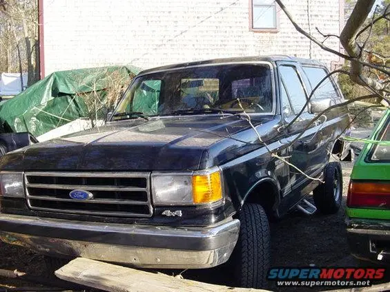

Also this is my other Black one that i did a 351 swap into it, but it has a blown AOD.

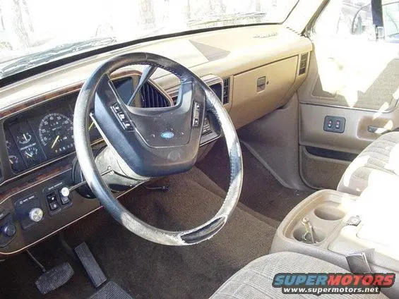

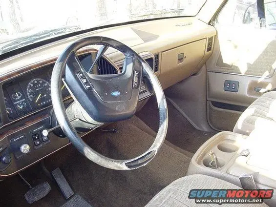

Dont know if youve seen the interior of one, but here it is
