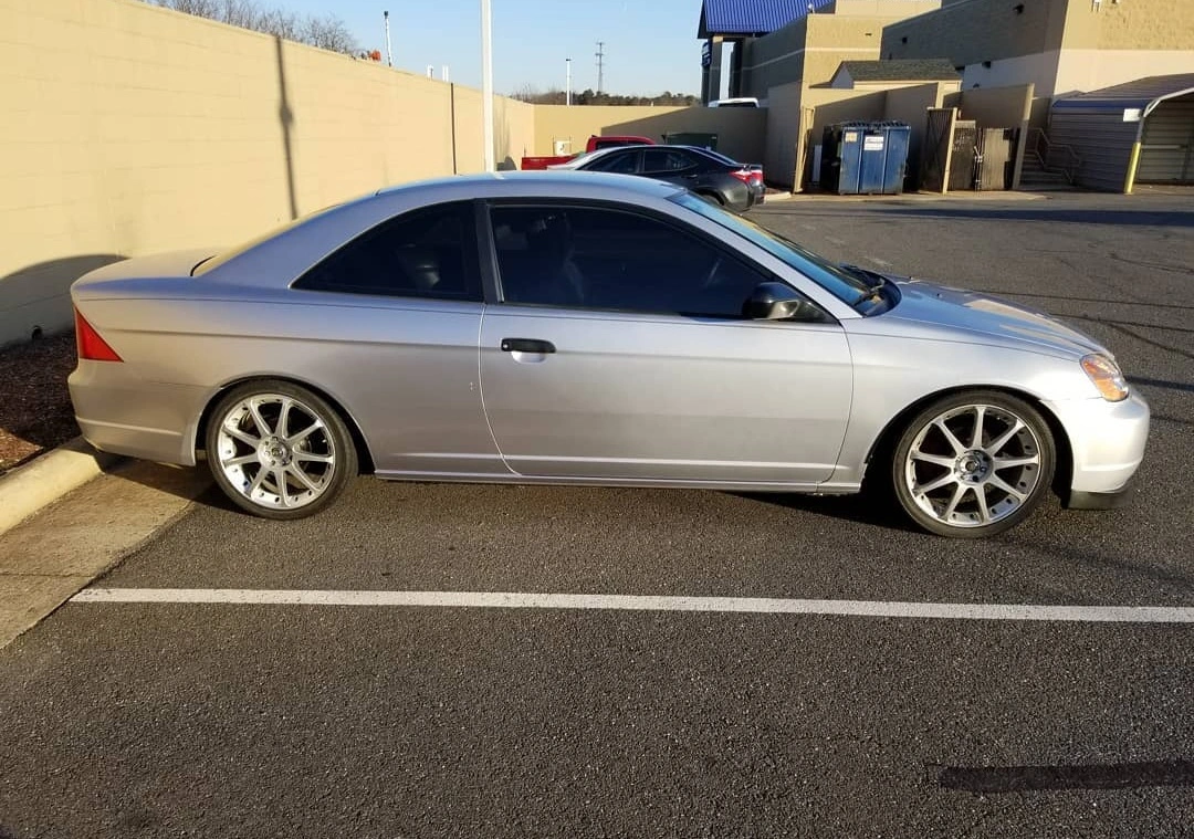

This is my old civic. Just a JDM vtech swapped em2 5spd. Car was great but the coil overs beat me up too much.
Nothing wrong with a civic. I was just poking at you man. Si civics are fun little cars.
No offense taken, it really has been a great car. As I get older and fatter, I’m considering replacing it with a Camry TRD.
