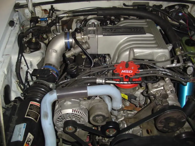

stock air box may be a cai but the pos air tube is crap and wont attach to my new 70mm tb*
Then just run a c&L inlet tube.Gives it that sleeper look :D
