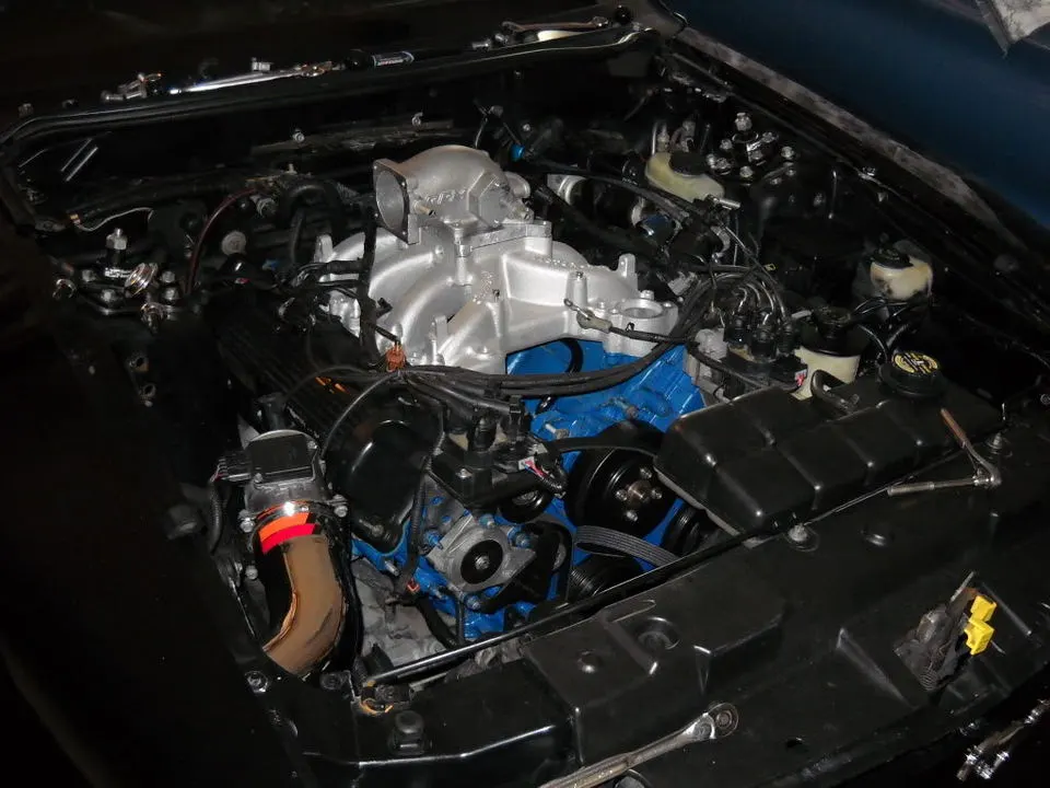

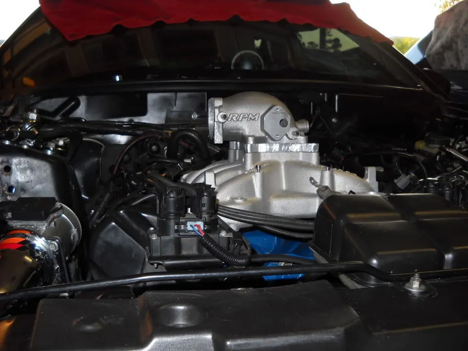

i have it, it will be going on this week, i have seen a few people gain very good hp with this intake and blower/turbos, im hoping it will be a good N/A intake and will be finding out very soon btw i made my own adapter plate to use a stock style plenuim, i will be running a ported C&L, and when i say ported i mean PORTED!
heres a pic of my setup, i will also be running edelbrock fuel rails:nice:
That intake is sexy. The runners are much much shorter and larger than the PI, or even NPI intake, so I'm certain you'll loose low end torque. It is probably best suited for a car with cams, gears and a ported head... *cough* 98cobra.
