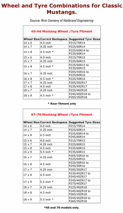

You want to know biggest fit? Here:
Reactions: 67 Must
What is the backspacing on the rims your looking at?
I have 15X7 TT D's with 3.75" bs and with 225/60/15's the bulge of the tire scraped the fender lips, rolled the fenders and they clear now. I think if I would have gone with 215's they would have cleared.

They are a 4.25 backspace wheel. I was leaning toward the 215/65s since they are 26" diameter but I am just trying to guage how that looks compared to the 215 or 225/60. My guess is there is probably not much of a noticeable difference at all.
