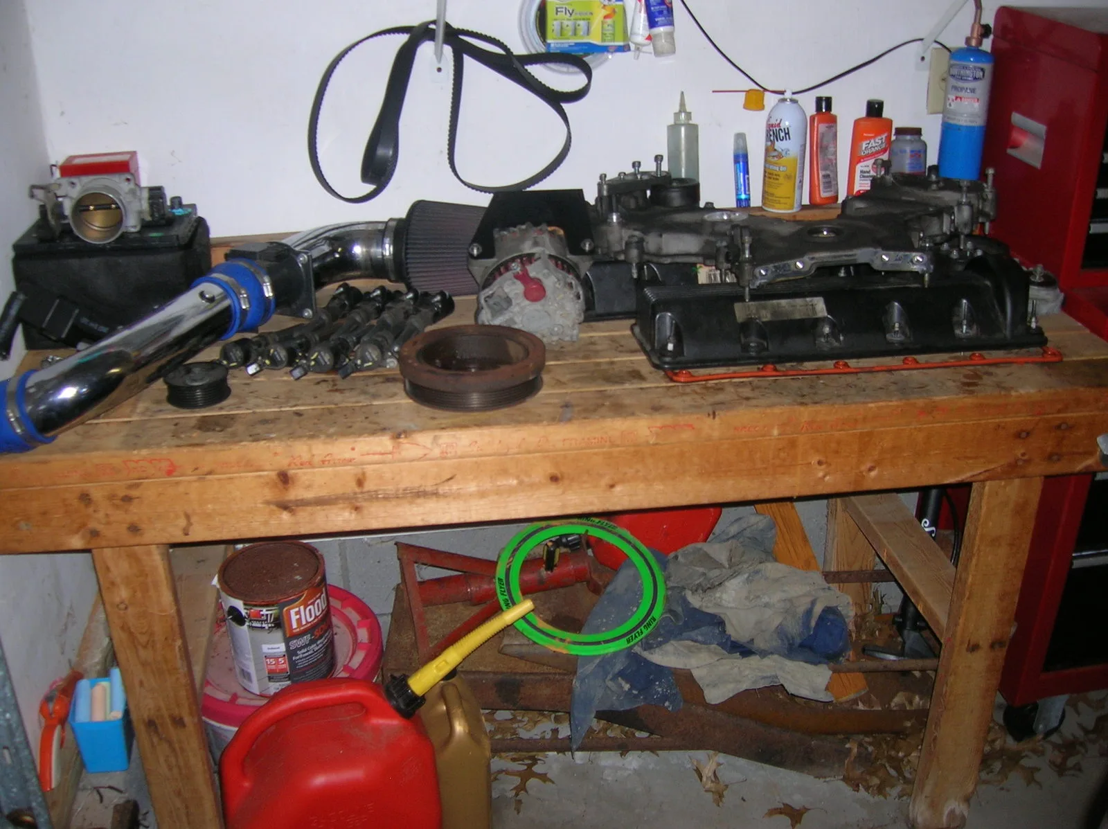

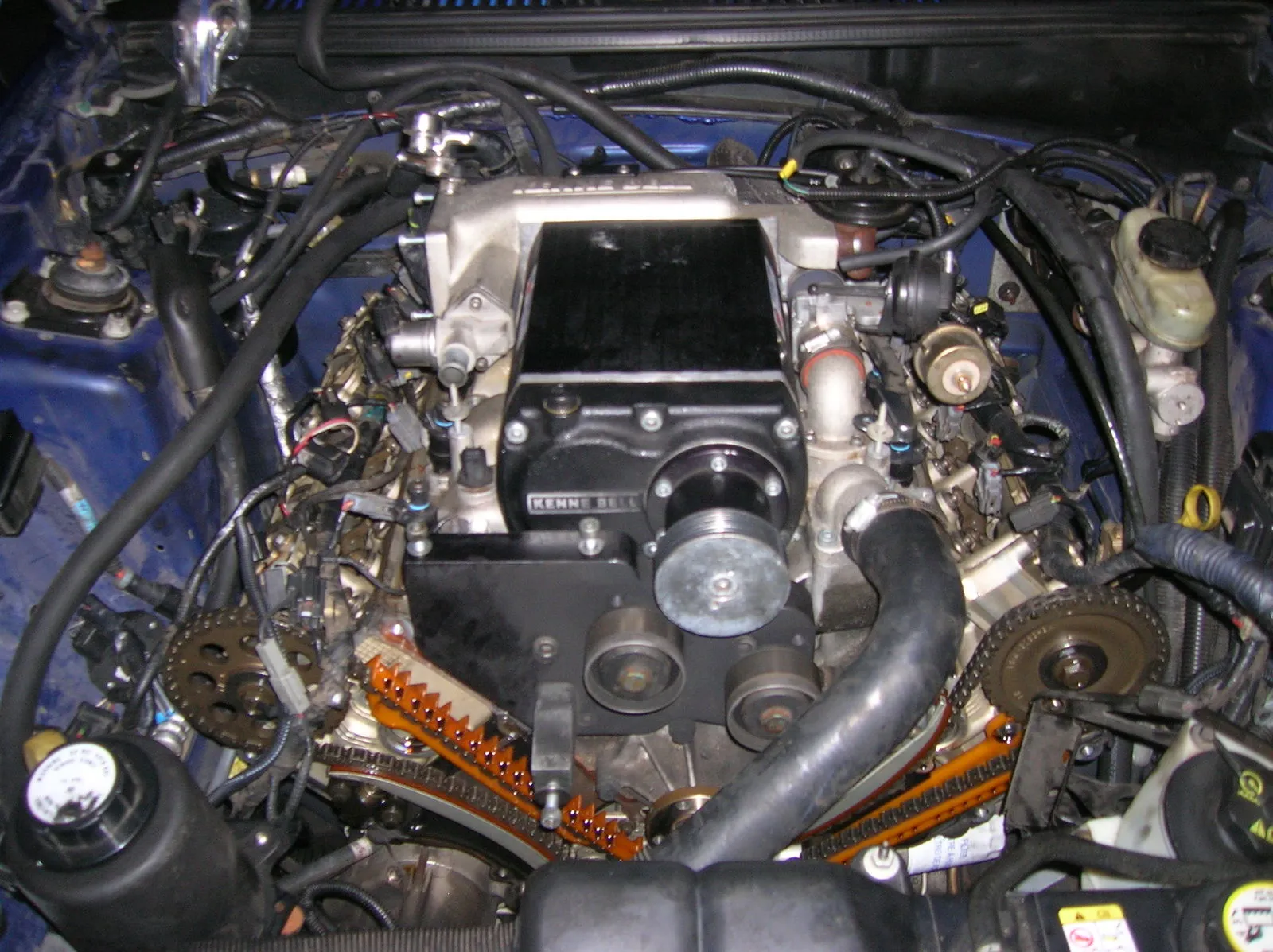

The cams should be in the mail this week. Bullitt took their time (due to the holidays) getting MHS my cams for Mr. McKinney to degree. Since I have been somewhat bored and anticipating their arrival, I went ahead and prepped the motor for the cam swap. All that is left to do at this point is remove the chains, cams etc... and I am waiting to do that when my cams are here.
Also, the power steering pump bolt behind the pressure line is my new worst enemy!!! Oh yeah, and i could punch the engineer in the face who decided to put a studded valve cover bolt on the passenger side right next to the shock tower and a/c lines (which i in turn dropped and is now stuck somewhere in my headers). I need a beer.
